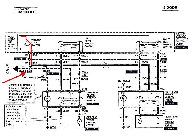

Front passenger window not working, not getting power to the switch either. The other three windows work great. Which color is the power for the passenger side? Where do I start?

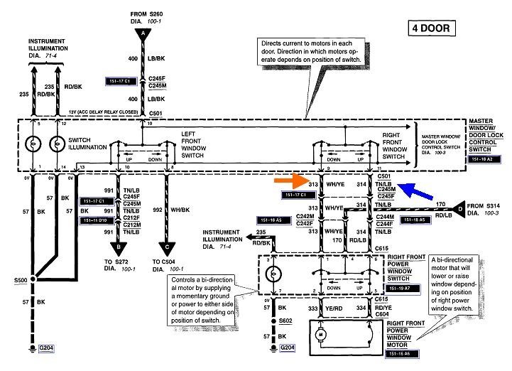

When a window doesn't work in only one direction and only from one switch, the culprit can be either switch, the driver's or that passenger's switch. That's hard to understand at first, but there's actually four sets of contacts in each switch, and two are in play in both switches, regardless which one is pressed. When the window works one way, that usually means the wiring is okay.

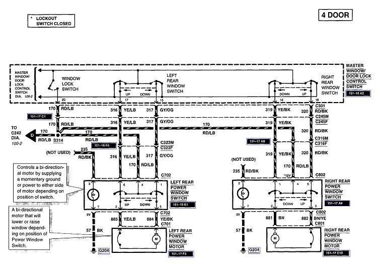

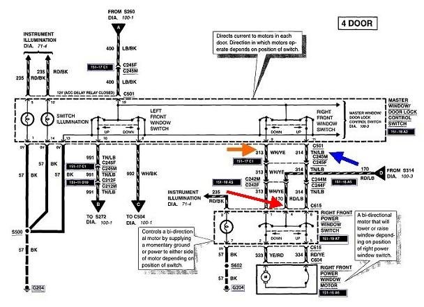

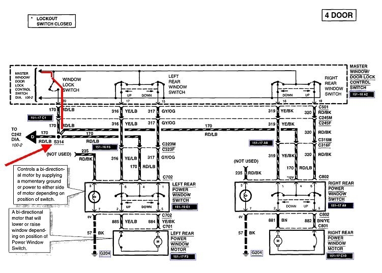

When a window is dead in both directions, most people assume the motor is bad, but it's much more likely there's a broken wire between the door hinges. In this case, in the second diagram I added arrows pointing to the white / yellow and tan / light blue wires. Both of these have to be broken for the passenger's window to not work either way from the driver's switch. Alternately, only one must be broken and the red / light blue must be broken for the window to not work from the passenger's switch. That red / light blue is right under my blue arrow. 12 volts feeds the passenger switch on that wire, and it comes through both sets of door hinges from the lockout switch on the driver's assembly. The 12-volt feed to the driver's switch has to be good for the other windows to work.
Check for those broken wires first. If that's what you find, I'll describe how I repair them. If the wires are all okay, we'll have to dig deeper and diagnose this problem.

Okay I tested the white/yellow and the red/light blue. Neither one of them have power at the main switch (drivers side) would that be a bad switch? And yes I checked the window lock.

When all switches are released, all the "traveler" wires between the switches should have 0 volts and they should read continuity to ground. Basically, both motor wires are grounded through both switches, then, when you want to activate a direction, that one switch contact moves away from its ground connection, then gets 12 volts applied to it as the switch continues to move. That's how they change the polarity from either switch to change the direction the motor runs.
So, the white / yellow and the tan / light blue will have 0 volts with both switches released, as you found. The red / light blue is a different story. That is the 12-volt feed only for when the passenger switch is pressed. It is not used when the driver's switch is pressed. This is why I suspect you have two problems, since the window doesn't work from either switch.
If you look at diagram number three, the first one below, everything following my red line has to be good because the rear windows work. That includes the master lock-out switch in the driver's door switch assembly, up to the splice # S314. That leads to point "D", and that is where you're missing the 12 volts at the passenger's switch. That's the lower red arrow in diagram number two, the second one below. You have 12 volts at the splice but not at the next test point, the switch. The only thing of importance between those two points is that wire runs between both front door hinges. The flexing from opening the doors repeatedly is what causes those wires to fray and break.
Splice S314 is inside the "A"-pillar, so that red / light blue has to be broken between the right front door hinges. At least one of the other two wires has to be broken between the hinges for either front door.
