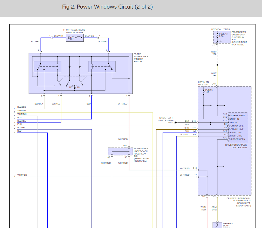

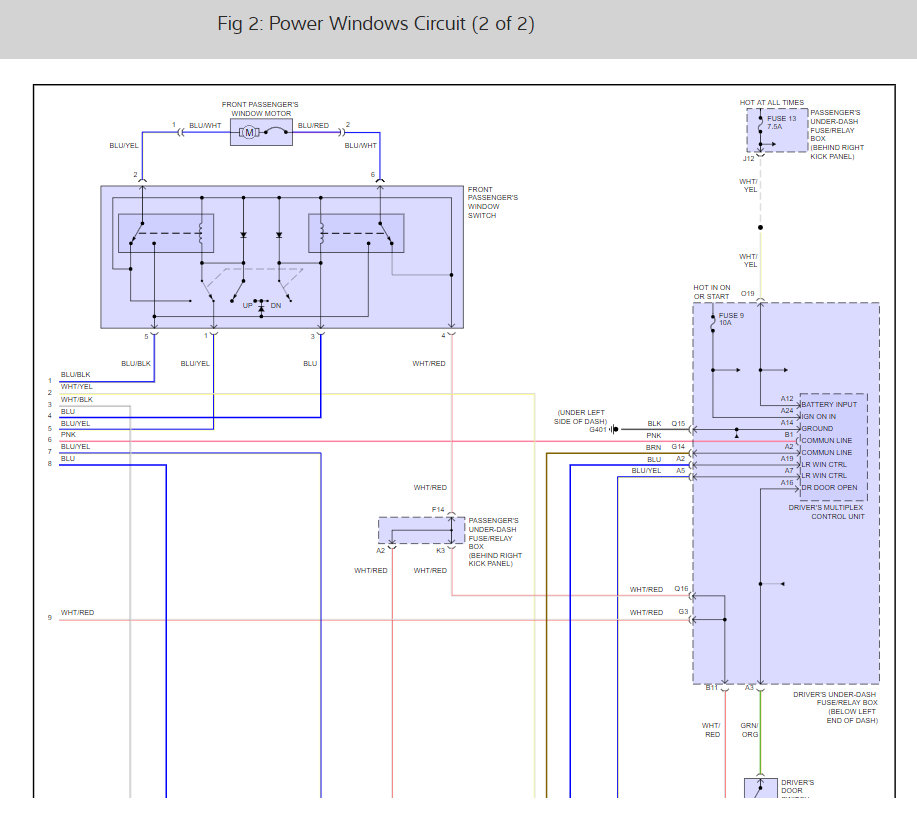

One day the window was stuck and it was open, I bought the new window motor because I saw some damage. The switch in the passenger side is not responding, when I use the main switch the window when up I thought the problem was solved, but now the window does not go down. I checked all the fuse and they are good. So, with the main switch I can bring the window up, but I cannot put the window down and the passenger is not responding at all.
Jul 2, 2018 at 1:11 AM
  • 55,676 POSTS

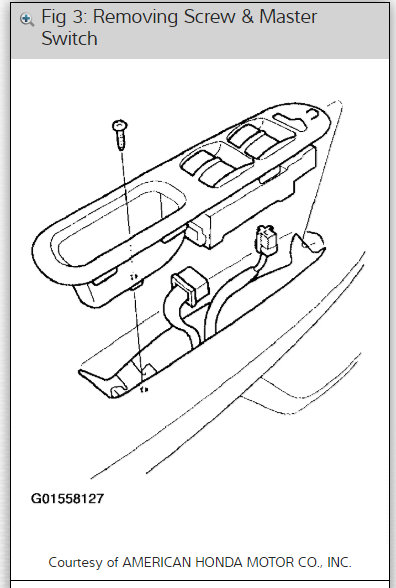

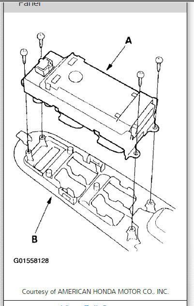

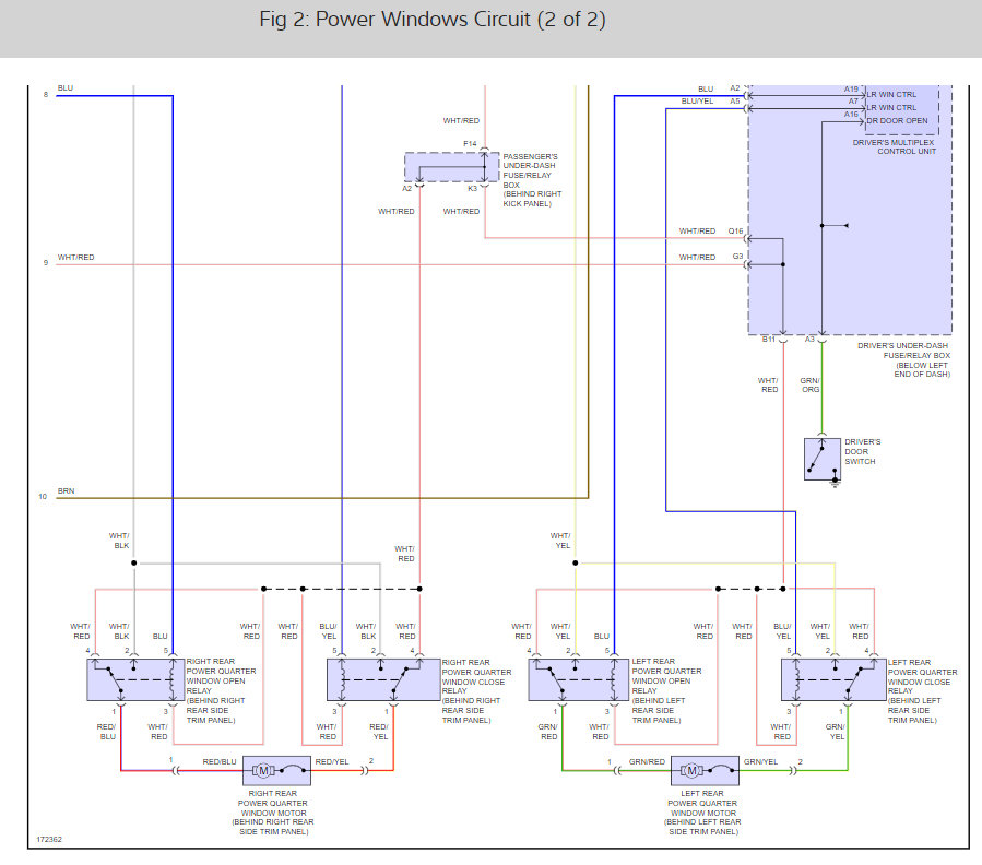

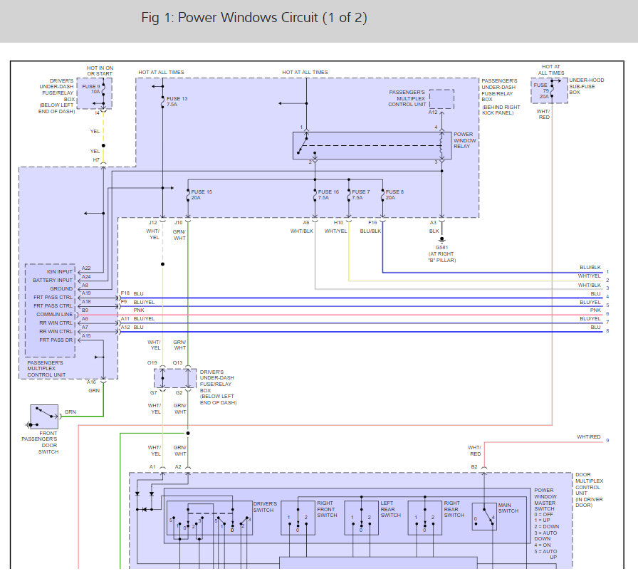

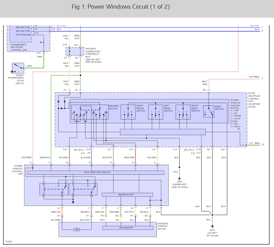

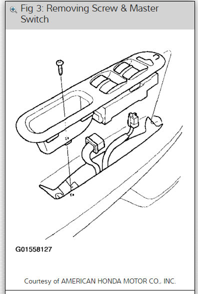

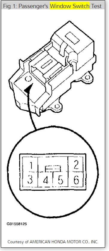

This sounds like the main window switch is out because the controls for the passengers side switch run through the main switch. To be sure here is a guide to help you test for power and the wiring diagrams so you can see how the system works:
https://www.2carpros.com/articles/electric-window-repair
Check out the diagrams (below). Please let us know what you find.
