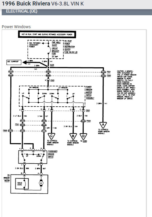

passenger window will not go down
1996 BUICK RIVIERA
200,500 MILES
SAPHIRE1
I put a new switch same problem.

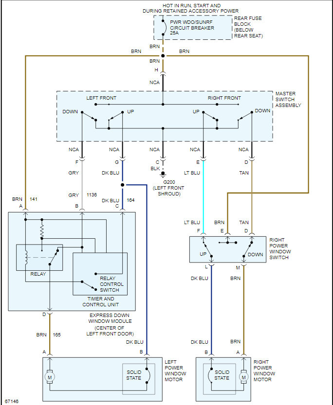

Are you able to operate the window from either side? Which switch did you replace (driver or passenger side)?
When push the switch, does it make a clicking sound?
Have you checked the fuse? The power window fuse located under the rear seat.
https://youtu.be/Hlna_kUt7As

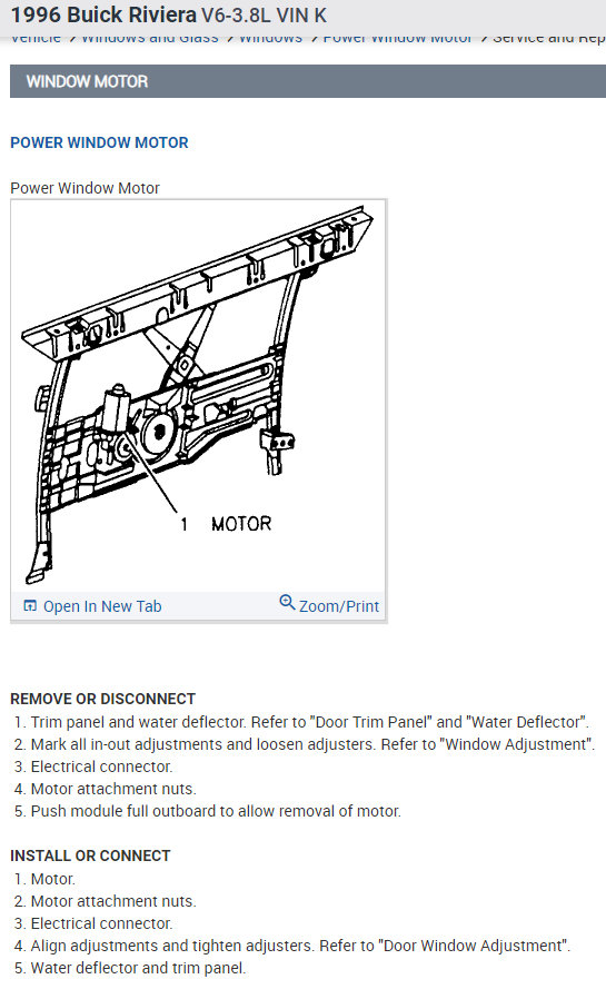

If you are getting power to the switch but unable to operate the window from either side then you might have a faulty window motor.
You might find these articles helpful:
https://www.2carpros.com/articles/how-to-check-and-replace-a-electric-power-window-motor
https://www.2carpros.com/articles/electric-window-repair

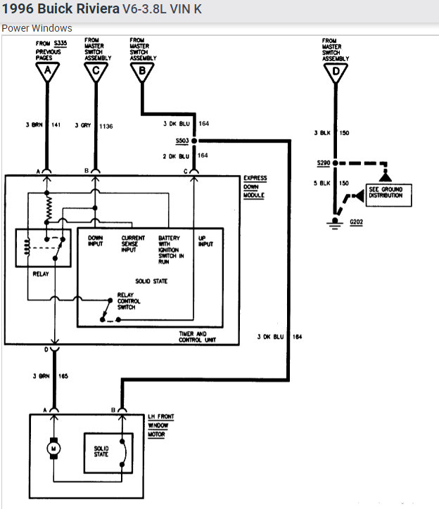

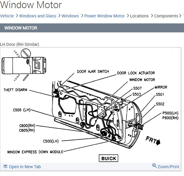

I have also attached the wiring diagram for the power window.
Let me know of any questions.
