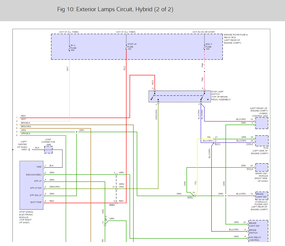

Passenger taillight and passenger front marker light out
2014 HYUNDAI SONATA
105,000 MILES • 2.4L • 2WD • AUTOMATIC
SUMMERC

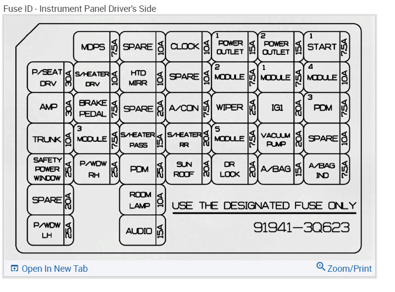

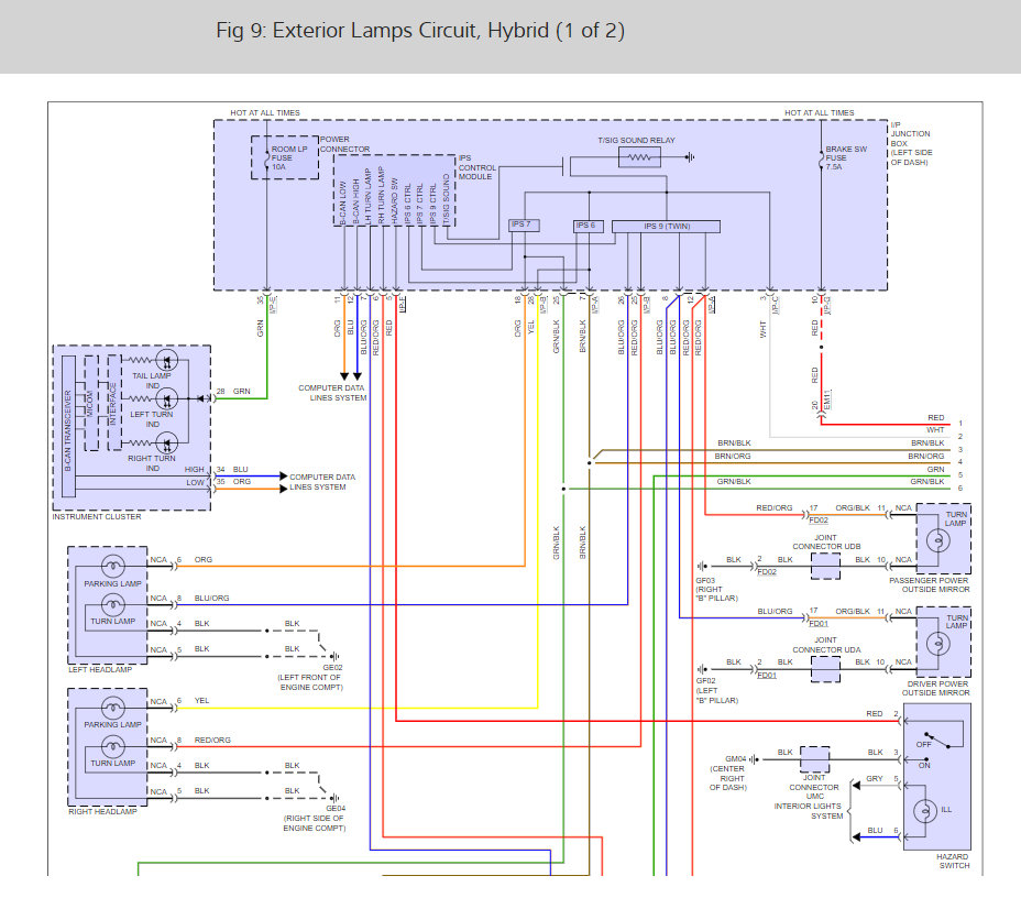

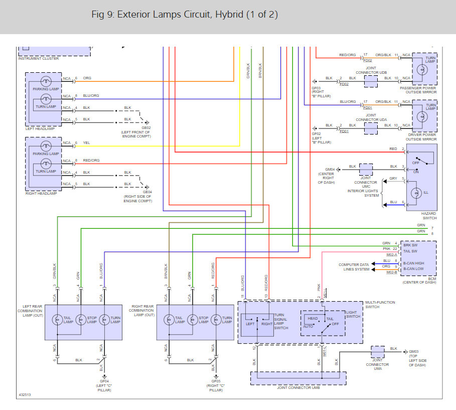

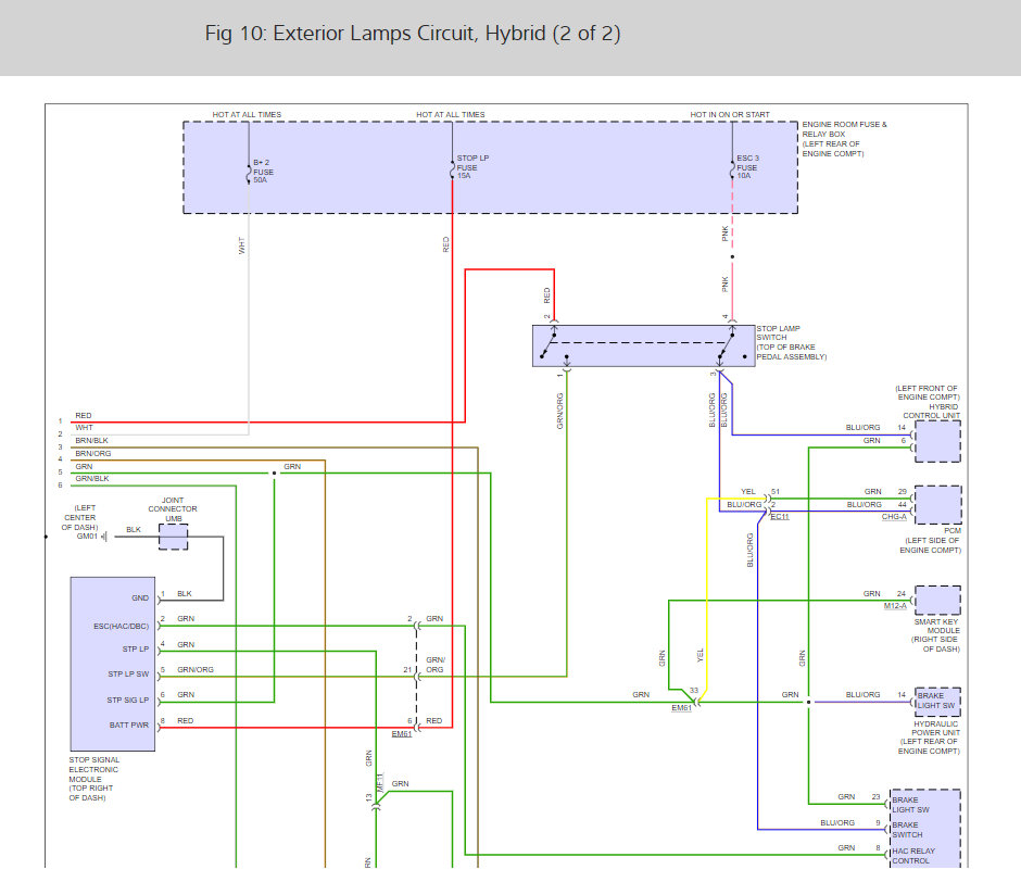

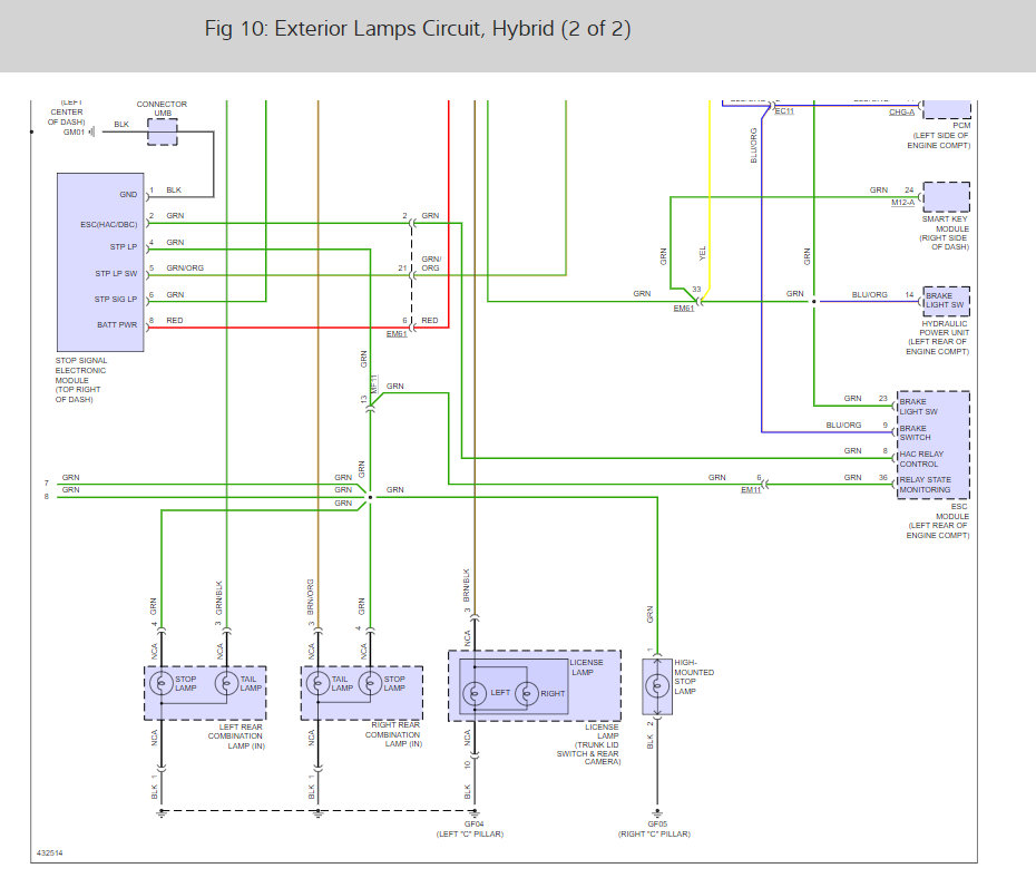

I have both of these light on the passenger side not working. I have replaced the taillight harness thinking that was the cause in the back but no luck. Has anyone ever had this problem that could help? I checked and all fuses are also good.
Mar 4, 2019 at 1:35 AM
  • 55,097 POSTS

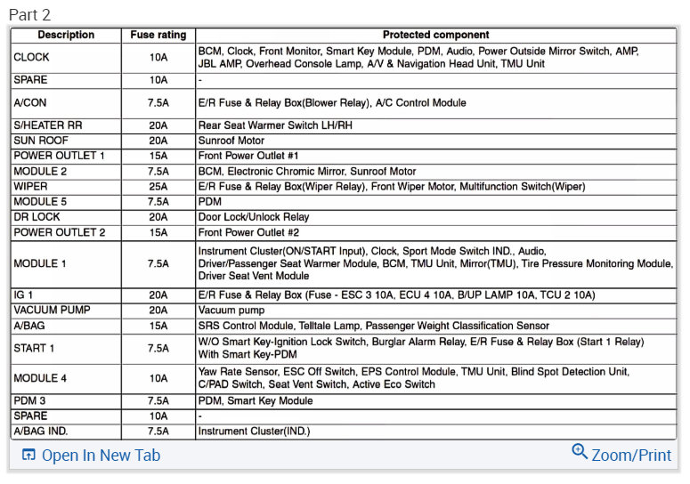

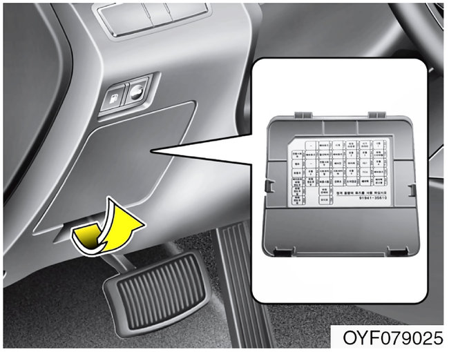

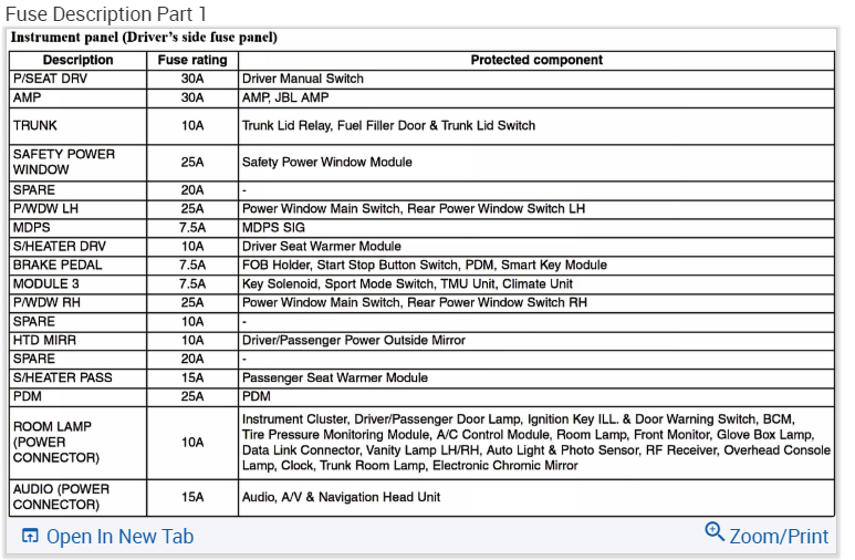

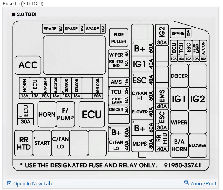

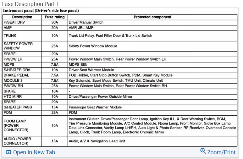

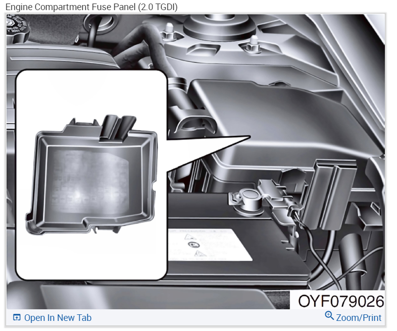

Can we check for power at the Room LP in the interior fuse panel please? Here is a guide to help us and the running light wiring diagrams so you can see how the system works. I have included the fuse panel diagrams as well.
