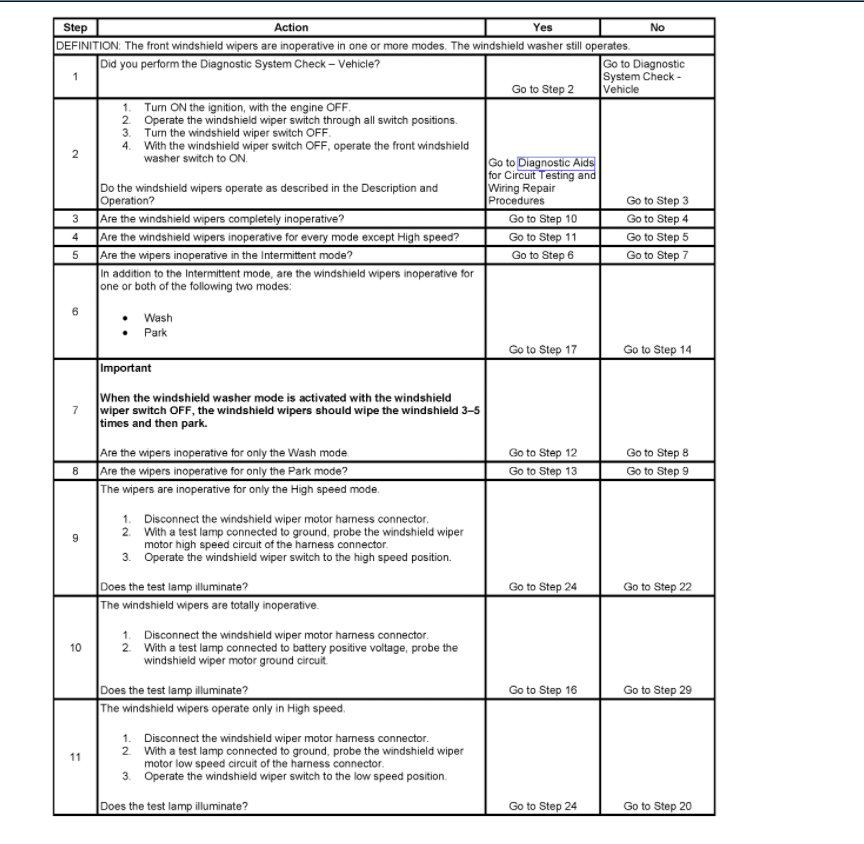

the driver side wiper works fine but the passenger side does not. It does not make any type of noise or anything and it moves freely back and forth manually.

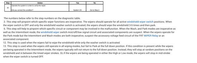

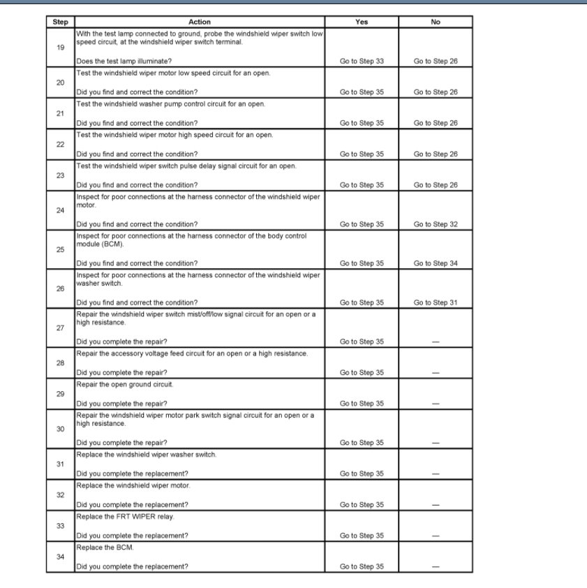

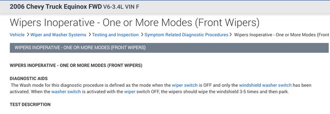

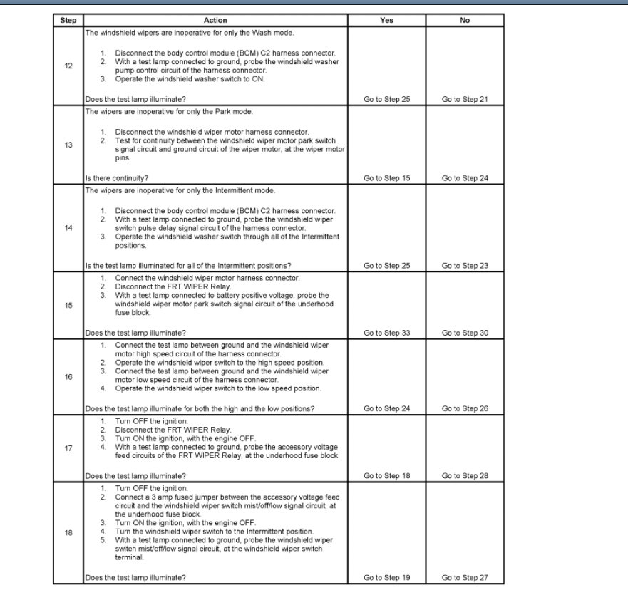

In the diagrams down below I have included a diagnostic troubleshooting flowchart guide for the windshield wipers for your vehicle from the manufacturer. Please go through this guide and get back to us with what you are able to find out.
