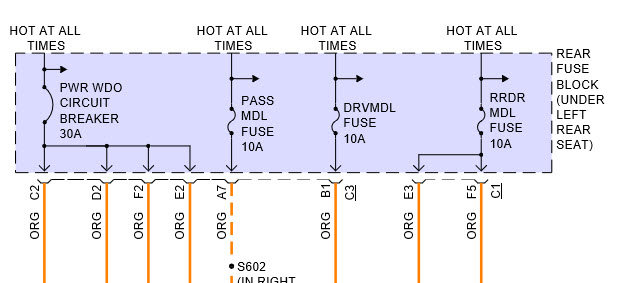

What fuses or if not fuses how can I get the front passenger window to roll up?

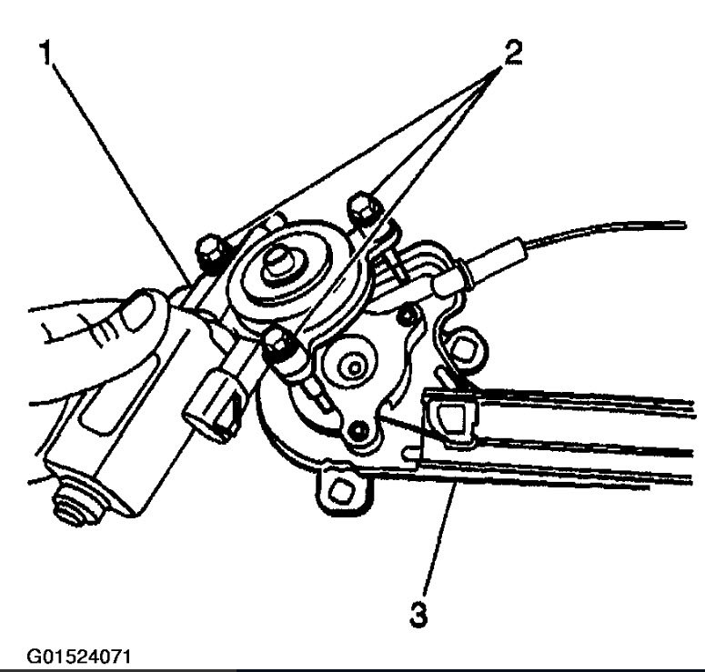

check breaker and fuses in picture, but if other windows work it may be a broken cable or the switch. Try slamming door hard if window goes up then it is a motor issue and will need another.
