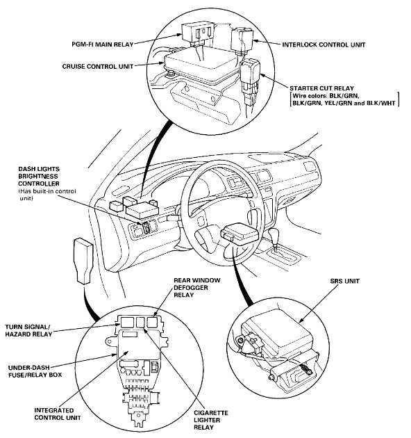

Which relay is the rear window defogger? Passenger side under dash relay diagram.

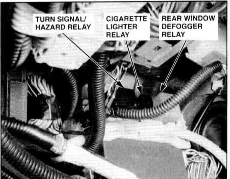

It is located in the under dash relay box.Here is a tutorial showing how to test a relay:
I've attached 2 pictures below for your Acura.Hope this helps and thanks for using 2CarPros.
