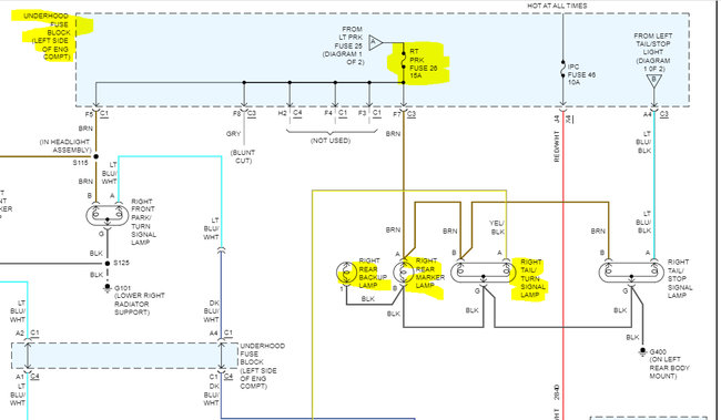

A brake light bulb went out and I bought the one according to my Manuel. When I tried installing it, I realized it didn’t have the correct base and wouldn’t fit. so, I looked on the internet and found what they say was an alternate bulb. When I plugged that into the socket, I heard a snap and the whole taillight assembly went dark. With the exception of the brake light, the rest of the bulbs still work as I tried them on the other side but nothing works on this side. Did I blow the whole assembly or something worse?
Jul 25, 2022 at 7:15 AM
  • 110,244 POSTS

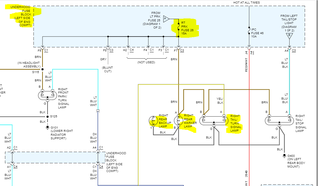

Chances are the fuse failed for the right parking lamps. The brake light gets power from a different source.
If you look below, I highlighted the relevant info on the wiring schematic. Let's start by testing fuse 26 in the under-hood fuse box.

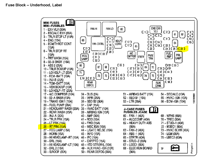

If you look at pic 2, I highlighted the fuse in the fuse box. In addition to checking the fuse, confirm there is power to and from it.
Let me know what you find.
