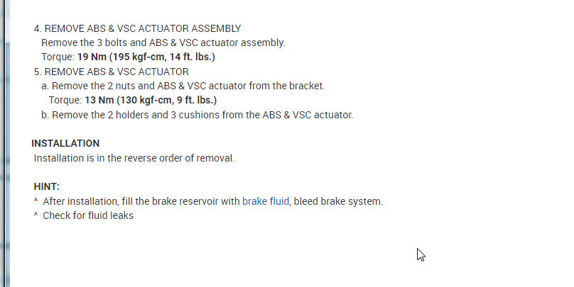

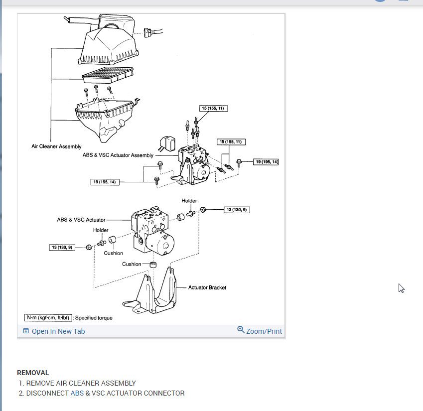

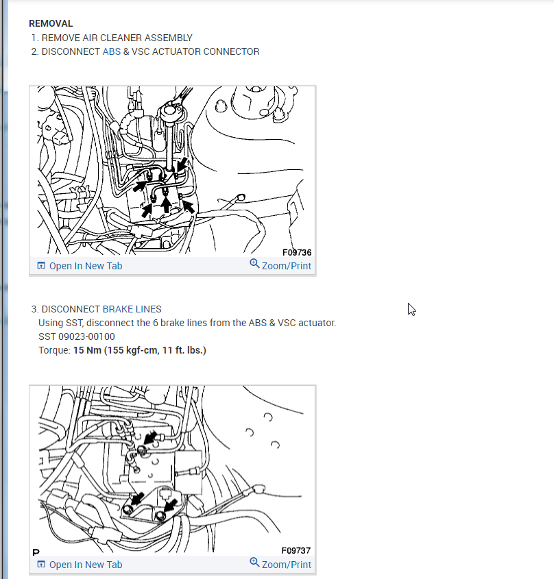

Is there any way to replace just the ABS module?
2002 TOYOTA AVALON
91,000 MILES
LZ35MV
MEMBER
2 POSTS
Aug 14, 2013 at 9:28 AM
Experienced Mechanic
18,907 POSTS
Here is a guide that will help with this:
https://www.2carpros.com/articles/how-to-replace-a-abs-controller
Below is the process from the manual that will give the detail needed to perform this as well.. Please let us know if you have other questions. Thanks
