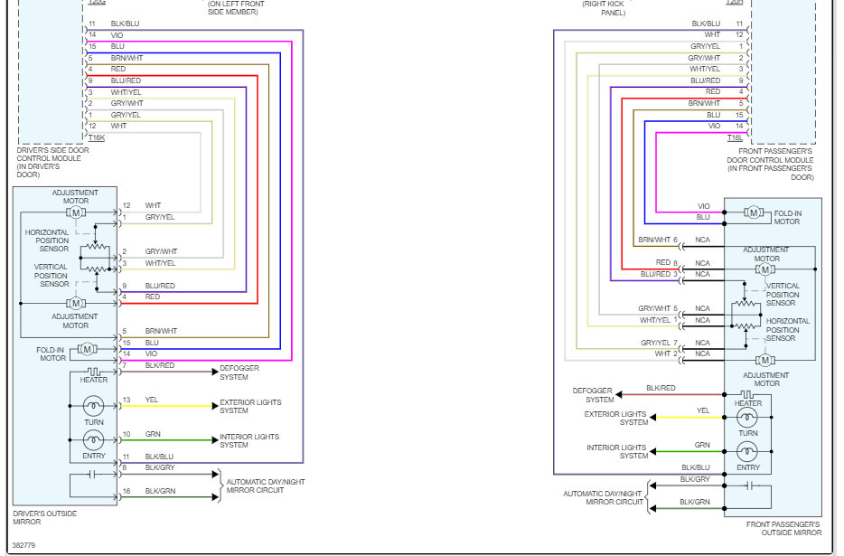

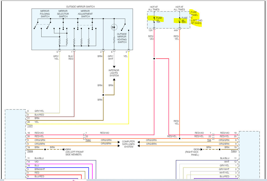

As far as diagnostics, I attached the wiring schematic below for the power mirrors. Also, I suspect they will be heated, but I can't confirm it.

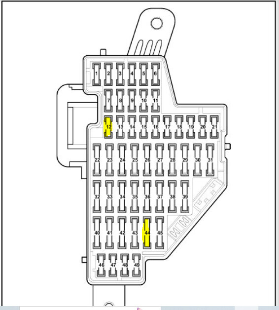

If there was a short, it should have caused a fuse to fail. There are two fuses in the fuse box that you should check first, fuse 12 and fuse 44. They are located in fuse box C at the left end of the dash. When you check them, make sure to also confirm there is power to them.
Start with that first and let me know the results.
