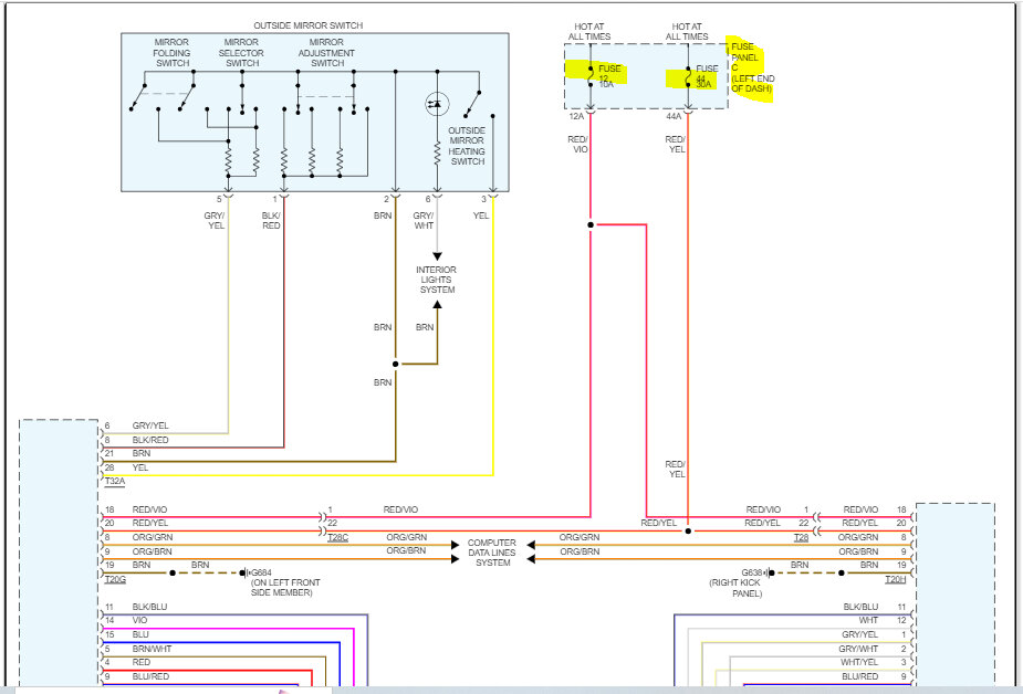

We are a detail shop and two days ago detailed the 2012 VW CC inside and out. During the exterior wash phase the passenger side mirror glass literally fell off of the backing and broke on the concrete floor.
The owner is a very mentally disturbed woman who is blaming use even though we did nothing wrong (the backing plate is completely clean, no sign of adhesive and the same on the back of the mirror glass we pieced and taped together). It is our policy to stand behind our work and accept responsibility.
I'm not yet sure if the mirror is heated or not, and won't know until tomorrow when the woman will hopefully bring the car back in. However, i just got a call from her (twice on a Sunday after reassuring her we would be calling her in the morning) saying both mirrors are not operating from the controls at the driver's side panel.
We only used a hose to rinse off the soap, including after the mirror glass fell off. Could the water somehow have shorted out the electric motors?
Any ideas on how to trouble shoot without taking it to VW?
Thanks for any ideas.
Jon
Oct 8, 2023 at 10:23 AM
  • 110,241 POSTS
If that would have damaged them, wouldn't rain do the same thing? I don't understand how washing a vehicle would have caused this, but it isn't me you need to persuade.

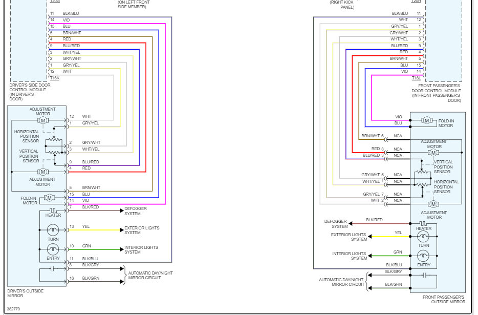

As far as diagnostics, I attached the wiring schematic below for the power mirrors. Also, I suspect they will be heated, but I can't confirm it.

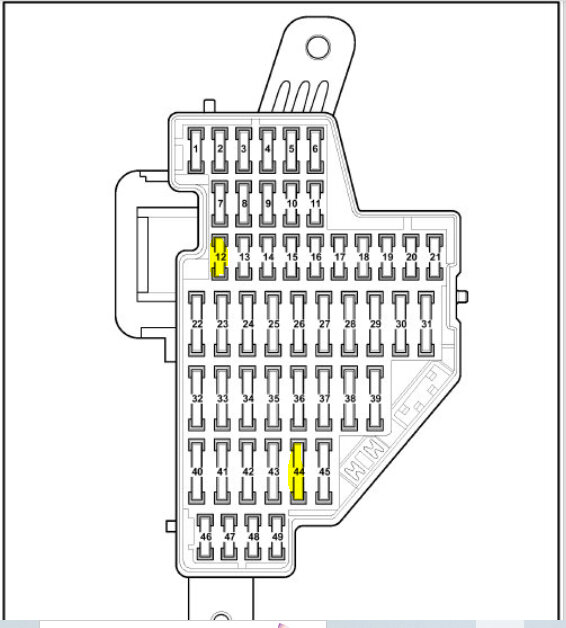

If there was a short, it should have caused a fuse to fail. There are two fuses in the fuse box that you should check first, fuse 12 and fuse 44. They are located in fuse box C at the left end of the dash. When you check them, make sure to also confirm there is power to them.
Start with that first and let me know the results.
