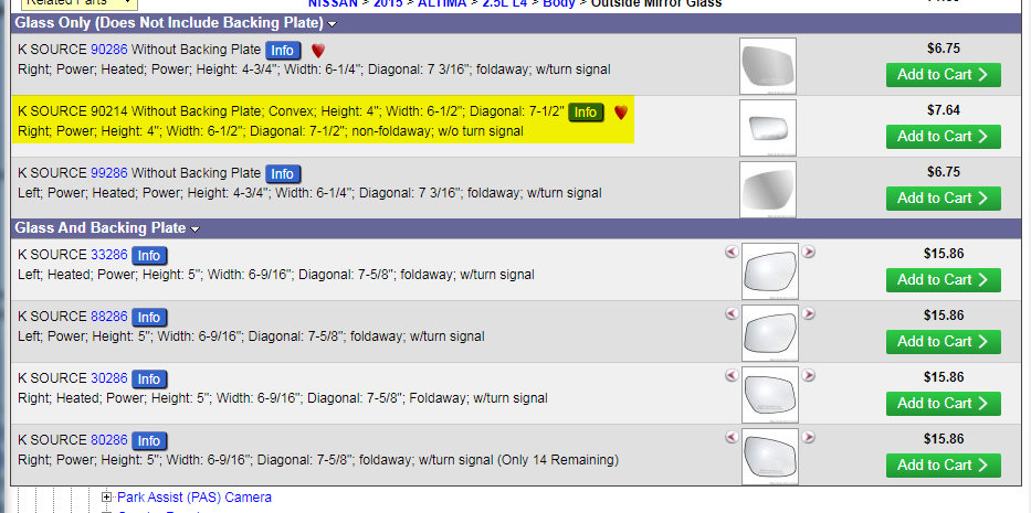

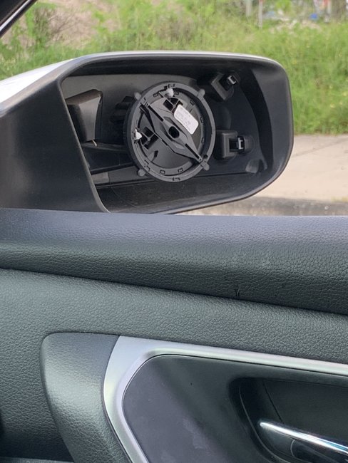

I am looking for a passenger side replacement glass with back plate I do believe. I'm just want to make sure that I need the back plate with the glass because I am having a hard time trying to find it.
Sep 4, 2019 at 2:07 PM
Please make sure that all the information I put in this website are correct for your vehicle. but it looks like they have your mirror with backing plate. Just make sure you look in the second section because the top is glass only. They are labeled as such but I just want you don't get the wrong one.
https://www.rockauto.com/en/catalog/nissan,2015,altima,2.5l+l4,3308910,body,outside+mirror+glass,6484
Let me know if you have questions. Thanks

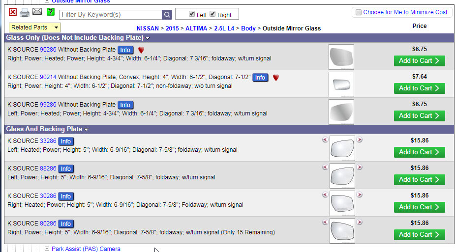

BASAPOOH81
My car doesn’t have the turn signal, doesn’t have heat and it’s non-foldaway. The foldaway is bigger the mine. My brother order that one off amazon and it was to big. I have looked all over the internet I only found one and it was on eBay for $50.00. That’s crazy..

Okay. Can you measure the other side and see if it matches the one that I highlighted? I understand that specific mirror does not include the backing plate but I just want to make sure that is the correct size.
Also, do you still have the old mirror that broke with the backing plate? If so, does it look like you can remove it?

I don’t have the old mirror or the backing plate. I need the mirror with the backing plate.

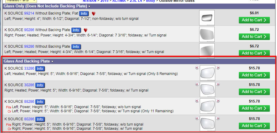

It looks like the second option circled in red on the attachment shows it has the glass and backing plate. It appears this is what you are looking for:
Nov 15, 2019 at 11:54 AM
MARIANNE PALMER
No mine isn’t heated and doesn’t fold. It looks like 99214 without back plate...
Nov 15, 2019 at 1:13 PM
I'm sorry. I didn't mean the second option in the circled section (even though that is what I said). I just re-read my post and that is what it said. Sorry for the confusion. What I meant was the lower section has all the options for the mirror and bracket.
If yours is the smaller mirror and it is not offered there, I think your only option is the dealer or a salvage yard where you can buy the entire mirror and then just take what you need so you don't have to repaint the new mirror.

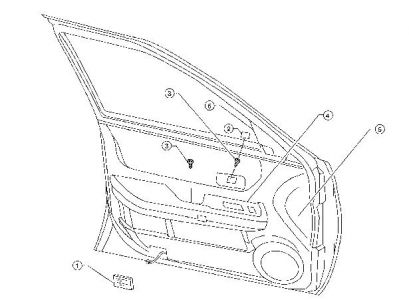

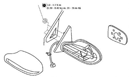

I need to replace my driver side mirror. I ordered the mirror online but I'm trying to find directions on how to remove the old mirror and install the new one. I would rather not pay for an entire repair manual considering this is just a minor installation. Does anyone know where I can find free directions on how to replace a side mirror on a Nissan Altima?
Nov 19, 2019 at 1:56 AM (Merged)
BLUELIGHTNIN6
  • 16,542 POSTS
DOOR MIRROR REMOVAL/INSTALLATION: Remove the front door sash cover (explained below) Remove the door mirror harness connector. Remove the door mirror mounting nuts, and remove the door mirror. Install in the reverse order of removal.
https://images.2carpros.com/forum/automotive_pictures/261618_Noname_285.jpg
DOOR FINISHER REMOVAL/INSTALLATION: Remove step lamp lens and disconnect step lamp. Remove screw cover. Remove screws. Disconnect and remove switch plate. Remove screw beneather switch plate. Remove door finisher. Installation is in the reverse order of removal.
https://images.2carpros.com/forum/automotive_pictures/261618_2_14.jpg
