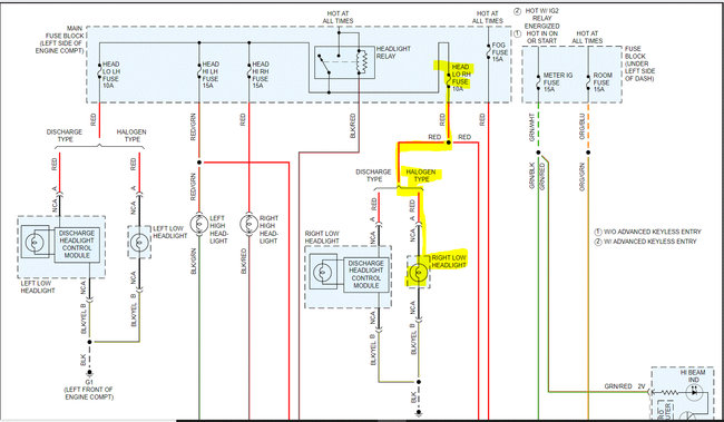

Hi, I believe i am having a weird issue. My passenger side low beam turns off and does not work. I have changed the fuse. it worked for 2 days. This issue has happened 4 times (10 days in the past). When it does not work, I was told by a auto store person that it could be corrosion in the socket (where the bulb fits). so I removed the bulb, cleaned the socket and inserted the bulb and then the bulb works for 2 days and then turns off. The bulb that works on driver side is actually Sylvania XtraVision Headlight Bulb H7XV and the bulb that does not work is SilverStar Ultra Headlight Bulb H7SU-2. is it possible that this issue is because i have 2 different H7 bulbs from Sylvania or is the socket faulty? why is the bulb working for 2 days if I simply remove the passenger side low beam bulb and put it back without doing anything? the driver side low beam bulk works always with no issues. I did have an accident previously on the passenger side and had changed the entire headlight set like 4 years back not sure if that has anything to do. I am planning to put a Sylvania h7SU-2 in the driver side (so that both sides have the same type bulb) and see if that solves the problem. any other suggestions?

I suspect it is a poor connection at the light. You questioned the light socket, what happens if you wait until it doesn't work and then wiggle the socket and wiring? Keep in mind, a bad connection will create heat, so that could be causing it to shut off.
If you are questioning the socket, when it doesn't work, see if power is present as well as a ground. If both are present, then the socket is the likely cause. Keep in mind, where the wire enters the socket can have a poor connection as well, so check that too as well as where the fuse connects in the fuse box.

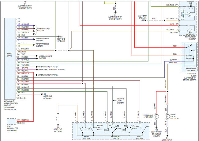

I attached the wiring schematic for the headlamps. I highlighted a few things to make it easier to find. Note that I had to cut the schematic in half to make it readable. I did overlap them so you can follow from one to the other.

You are absolutely correct. I believe there is a problem in the connector in Mazda 6 cars.
As I needed to fix the issue quickly, yesterday I took the vehicle to the nearby mechanic and he cut the connector and connected with a replacement. He did charge me $200.00 which I believe is a little high.
Thanks for diagnosing the problem correctly and mentioned that the heat is shutting the light off due to bad connection.
