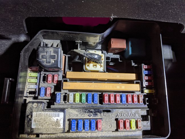

Passenger side Low beam doesn't work, I have replaced the bulb with 2 others just to be sure it wasn't defective. the wiring on the connector looks good. I'm out of ideas.
Oct 18, 2019 at 2:16 AM
So if we eliminated the bulb that means we need to check the wiring and fuses highlighted in the attachments.
To do this we need to test for voltage at the bulbs when they are turned on. You can do this by back probing the connector with a known good bulb installed but we need to find out if there is voltage there. I am guessing there is not, that means we need to check the fuses (you may have already done this). If the fuses are good and still no voltage then we need to check the relays. Swap the right hand with the left hand relay and see if the issue changes sides. If so, then the relay is the issue.
Let me know what you find and we can go from there. Thanks

So I finally got a chance to look at this, the fuses are good, but I cannot find the headlight relays. I've tore into all the fuse locations that I can find.
Nov 17, 2019 at 8:11 AM
They are in the underhood junction box but I am surprised to see they are not labeled in the manual. It is going to be one of the ones circled. Do you have the owners manual? They normally list them in there.
Nov 17, 2019 at 8:47 AM

I see no headlight relay, only the 4 15amp fuses.
Nov 17, 2019 at 9:00 AM
The wiring diagram says it is in the J/B Assembly. Here is a picture of where that is. Is this the one you took a picture of?
Nov 17, 2019 at 10:01 AM

Yes that's the picture I took.
Nov 17, 2019 at 10:05 AM
Okay. I thought so. This is a new one on me.
Clearly the shape of the box is the same. What are the two long "relays" that I circled? Can you remove these at all? This is where the diagram shows the relays located.
If you can't lets just move on. Just measure voltage at the fuse that is down in the circuit and see if you have voltage on both sides of the fuse. If you do, whatever or where ever that relay is, is not our issue.

Those long, tan devices are actually integrated fuses. You'll need to pull them out of the junction block and visually inspect them for any blow/burned out sections. See below.
