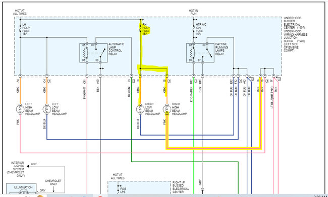

On the front passenger side of my car, my signal works and my high beam works, but my low beam doesn't. What could be the cause? Is this something I can fix?
Jan 1, 2023 at 6:05 AM
  • 110,244 POSTS

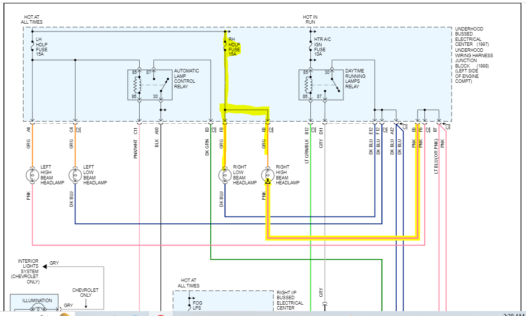

I checked the wiring schematic and found that both the high and low beam on the right side is powered from the same fuse and grounded at the same point. (See pic 1)

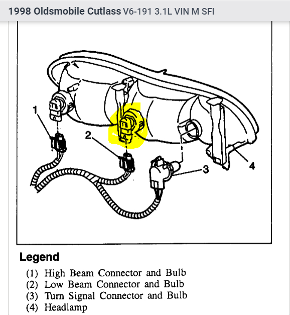

So, if you want, you can disconnect the electrical connector on the rear of the low-beam bulb and confirm there is power to the orange wire.

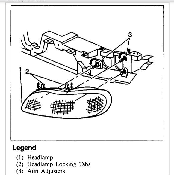

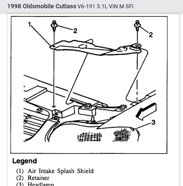

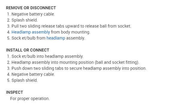

Or have you checked the bulb itself? It may be burned out. If you haven't, I attached directions for replacing it below. Take a look through the directions and let me know if you have questions.
