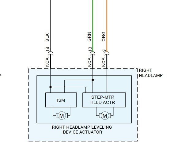

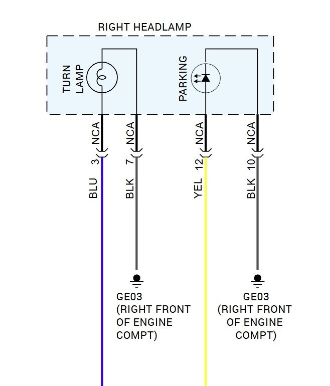

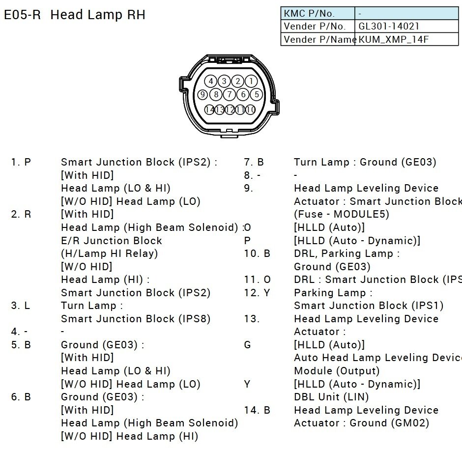

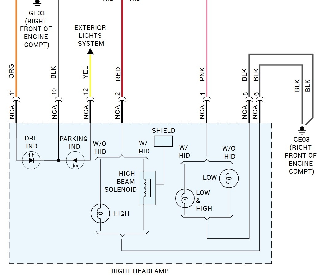

Rodents are such fun. Strip the harness back and trim the wires. Pin 1 is pink. Pin 2 is red with battery voltage. Pin 3 is the blue wire for the turn signal. Pin 4 is empty. Now there should be 5 black wires that are all grounds in the harness, those go to pins 5,6,7 and 10 (add pin 14 if it has auto leveling). Pin 8 is empty. Pin 9 would be orange (with battery power for auto leveling) Pin 11 is also orange but won't have battery power. Pin 12 is yellow, for the parking light. Pin 13 is Green for the auto leveling. The connector diagram is looking into the open end of the connector, the new one should be marked though.

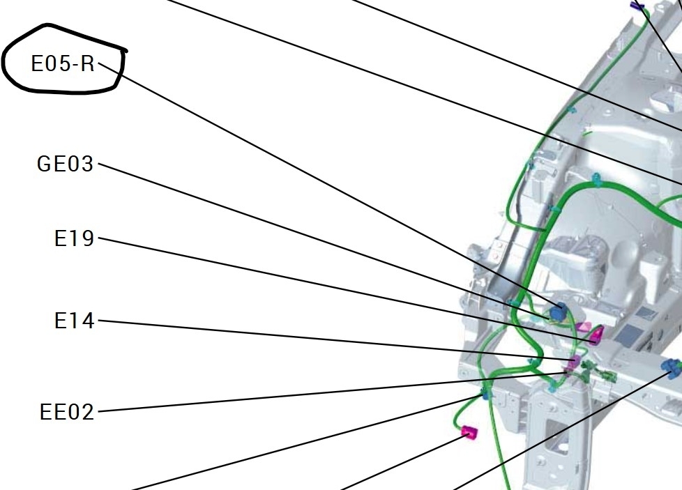

Okay, ran the VIN and got the same wiring that I posted earlier from three different information sources. OEM from KIA, Alldata and Mitchell. That is for the 14 pin connector on the back of the headlight.
