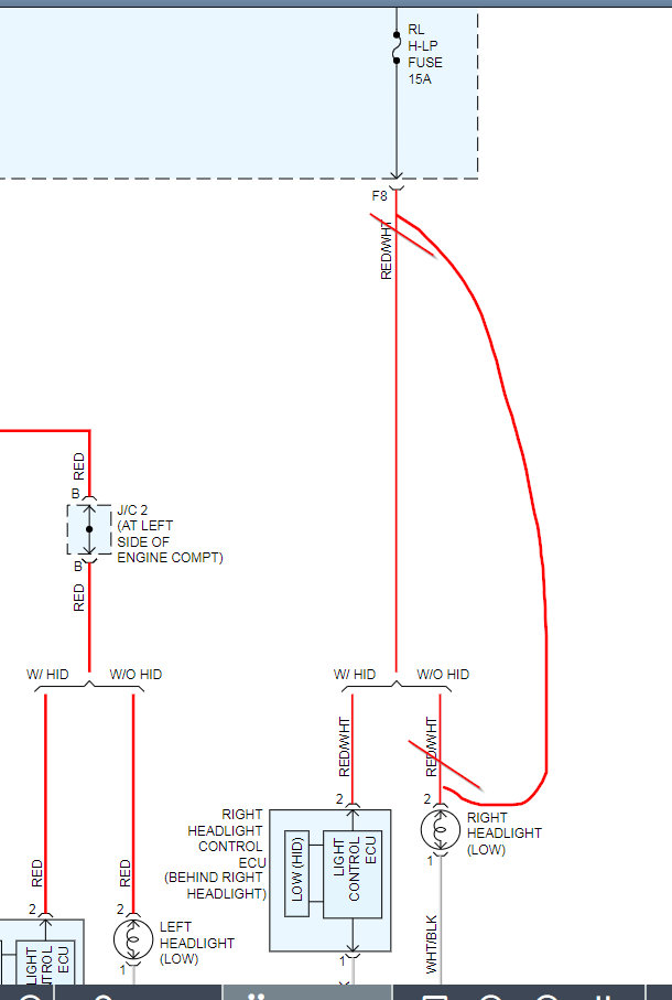

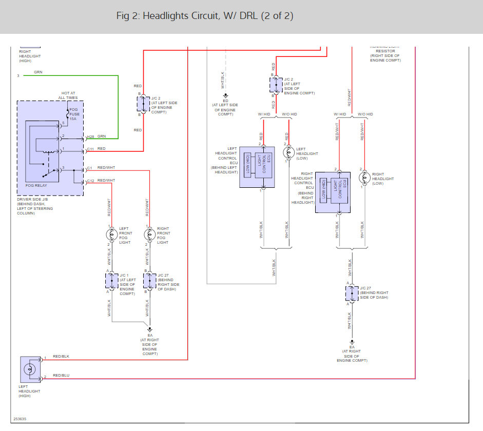

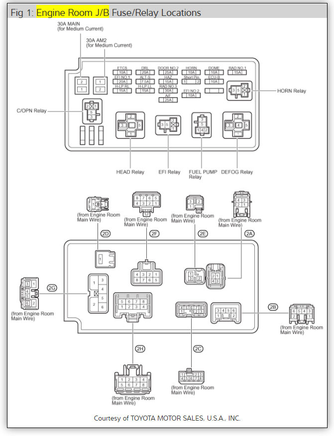

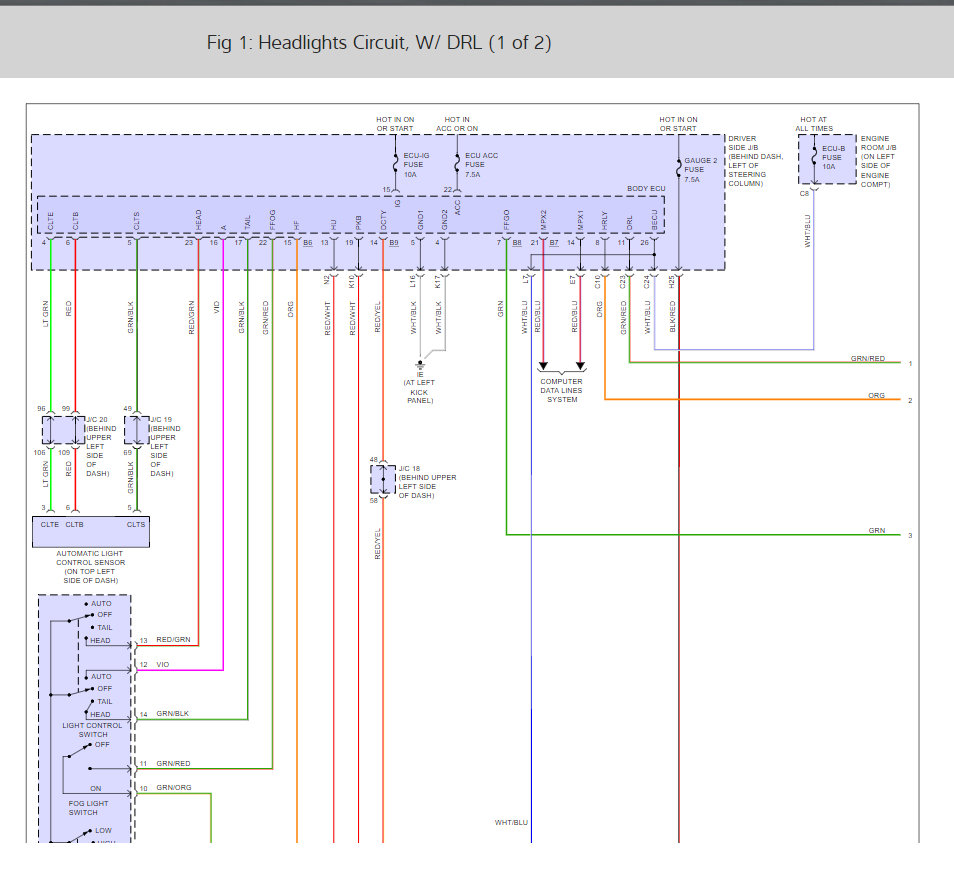

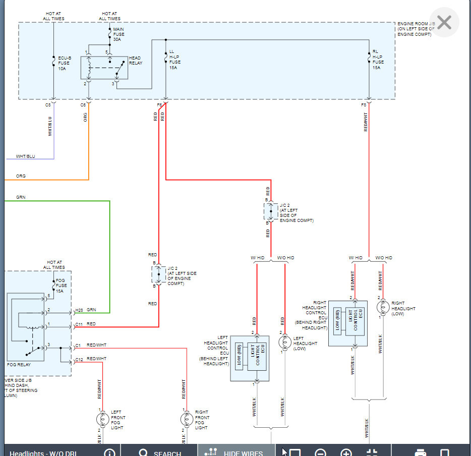

Van listed above is the LE model. I have tested the bulbs and the fusses and the relay, they are fine, the power +12V goes to the relay and from the relay. it goes to the left and right fusses(15A) and it goes out from the fusses, but, it doesn't reach the headlight low beam bulb connector. any suggestions my friend?
Note: the driver side low beam headlight is working normally and also the high beam headlights are working normally too.
I didn't found the hot on the plug, I found only the ground.
Dec 13, 2019 at 6:52 AM
Excellent job so far and giving us the facts. This is almost surely a wiring issue coming out of the fuse to the lamp. If it were me, I would just cut the wiring coming out of the fuse about 5 inches and the same at the bulb. Then run a new wire from each end to end. You can start with just running this crudely outside the vehicle or the most direct path just to make sure the lamp works. I have a 10 foot reel or test wire with alligator clips that I would just hook up and if the light works the solder in the permanent wire and secure it in place.

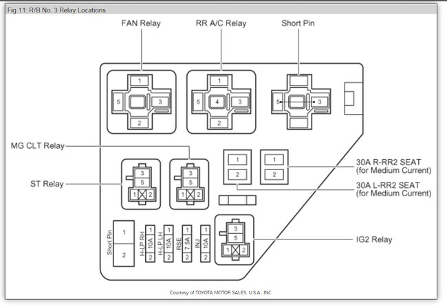

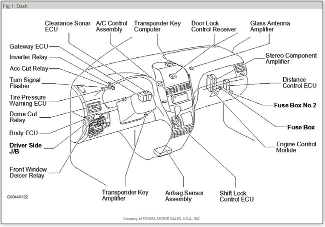

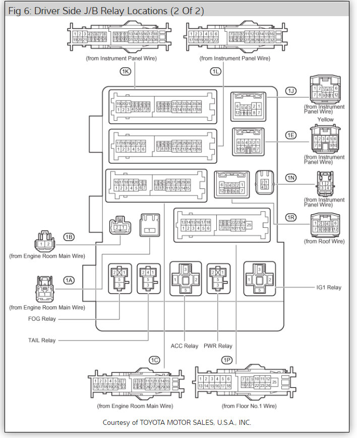

do you know any video for the opening of the fuses unit for sienna 2008?
Dec 16, 2019 at 5:22 AM
Unfortunately I do not. I looked online and didn't find any. Sorry I can't be of more help with that one.

Happy Holidays, before the bulb connector with 2cm, I made a very small cut and used the AVOmeter to test the contact between the wire and the connector hole (that the bulb (+12) pin that goes in it), it was working the problem starts from the fuse unit to the bulb connector, I tried to open the fuse unit, I need to see is the wire soldered with the unit or it's a connector, if it was soldered, I need to be sure it still contacts or not and test the wire from the solder point to the bulb connector, to be sure if the wire had a cut on the way and if it wasn't solder, it was connector I will test from the fuse to the out of the connector and from the fuse unit connector to bulb connector.
I tried to open the fuse unit, but, I didn't know how, I'm waiting to find a way to.
Dec 25, 2019 at 8:33 AM
I am sure there is a way to take it apart but I am not finding a process or have ever done it so unfortunately I will not be of much help on this one. I will ask around and see if anyone has taken apart this fuse panel.

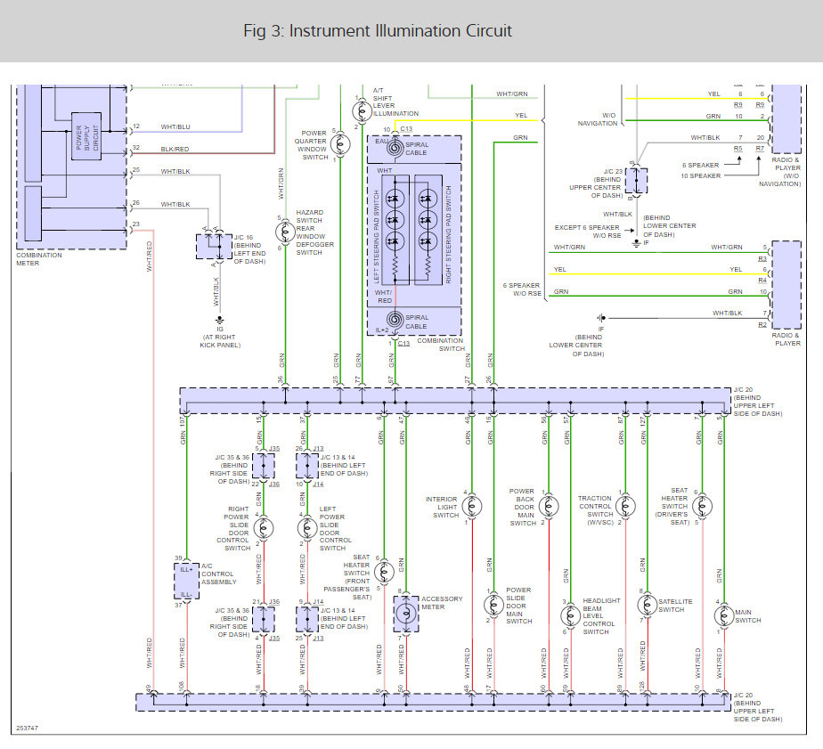

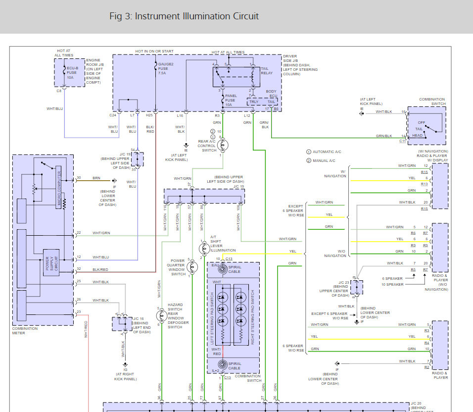

MARINE83
Okay, so i have a 08 Toyota sienna and when i turn the head lights on the dash lights go out and when i turn the head lights off the dash lights come back on what do i do cause i cant drive at night
Dec 14, 2020 at 11:25 AM (Merged)
  • 55,619 POSTS
Check the dimmer control. Ensure it is not turned to minimum dimness. If okay I would say the headlight switch is out but we can sure by checking the power of switch.

Dandy. We got the obvious out of the way. I would even have been happy with a visual inspection, but failure of both at the same time would not be common. The next thing is to do some checks at one of the sockets. To make it easier. leave both bulbs unplugged. With the headlights turned on bright, you should find 12 volts on one terminal. A test light or a digital voltmeter can be used. If you find that, check it again with the other bulb plugged in. If that 12 volts is still there, we have to fix the ground circuit. If it goes away with one bulb plugged in, there's a break in the wire or switch that we have to find. Turn the head light switch off, then recheck for that 12 volts again. If it's still there, the switching is done on the ground side and will be a little more involved.
If you don't find 12 volts, first look if there's a head lamp relay in the fuse box under the hood. If there is, we can use that to do more diagnosis. If there's a low beam and a high beam relay, switch them to see if now the low beams don't work. Relay failure is not common, but that's a quick test.
