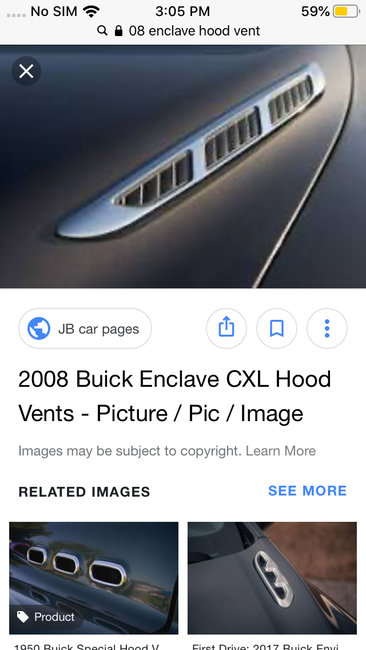

Okay, I'm just wondering, does you car have those small vents on the front hood? open up the hood and look up at the top left of the engine compartment, this would be the passenger side. Now i am just going by pictures here, is there a possibility, while driving faster and its raining that water is streaming up threw those vents. This is just an idea since you already have someone trying to find the leak.

Its got vents on side of the hood. there small besides the grill on front end.

Looks like this or little smaller.

Okay, it found something. Buick has supposedly 7 recalls for water leaks on these vehicles. You may want to take the blower motor out , under the passenger side dashboard, and check for water as well. These can fill up with water and cause the blower motor to fail as well. Now, "they think" it's coming in either the sunroof or from underneath the vehicle. But I would check the blower just to make sure it's not sitting in a puddle of water as well. It comes out pretty easy.
