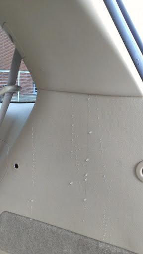

Passenger side front window pillar and seat belt pillar soaked
2008 BUICK ENCLAVE
120,000 MILES • 3.6L • 6 CYL • 4WD • AUTOMATIC
CORY2427
  • 293 POSTS
I’ve dropped headliner nothing wrong with drain tubes or anything not even the top rails .took it to the body shop they can’t figure out where the water is coming in at. I’m lost. any ideas?

Hello thanks for using 2CarPros. it sounds like the door seal is leaking or the sunroof. Looking at pictures, does your car have the 2 sunroof set up and did they check to make sure they're sealing correctly? Just an idea, try spraying the car with a hose at certain points and have someone sit inside and watch for a leak if you have it apart already.

I dropped it off at the body shop dealer still there they have a sprinkler system that does the the sunroof and they say it’s not coming from sunroof and they can’t even make it get wet inside yes it’s double sunroof.

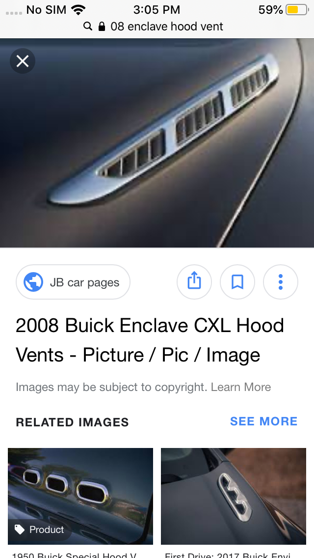

Okay, I'm just wondering, does you car have those small vents on the front hood? open up the hood and look up at the top left of the engine compartment, this would be the passenger side. Now i am just going by pictures here, is there a possibility, while driving faster and its raining that water is streaming up threw those vents. This is just an idea since you already have someone trying to find the leak.

Its got vents on side of the hood. there small besides the grill on front end.

How would water travel inside though through pillars?

Looks like this or little smaller.

Okay, it found something. Buick has supposedly 7 recalls for water leaks on these vehicles. You may want to take the blower motor out , under the passenger side dashboard, and check for water as well. These can fill up with water and cause the blower motor to fail as well. Now, "they think" it's coming in either the sunroof or from underneath the vehicle. But I would check the blower just to make sure it's not sitting in a puddle of water as well. It comes out pretty easy.

Just got off phone with them. it's not sunroof, A/C line is clear, blower motor is clear, but on the fuse panel side its dripping on box and both sides of carpet is soaked. they think it's a body seem, but still looking at it.

No it’s running over to other side but he can't pin point exactly yet cause it is not a constant drip. so on he moved the sprinkler system on the windshield and go from there tomorrow. still trying to figure out .
