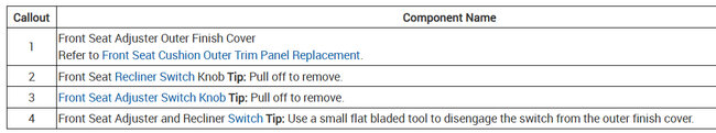

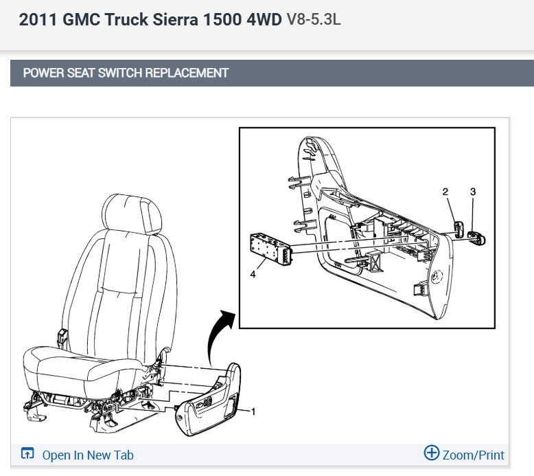

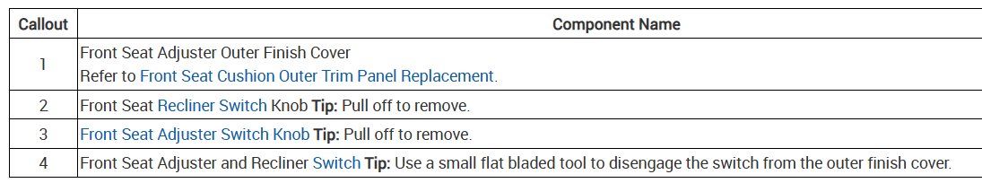

Passenger side front seat is fully reclined and will not go back to upright position. All switches work except the switch to bring the back to the upright position.
Mandy
Dec 27, 2024 at 11:24 PM
  • 55,711 POSTS
Chances are the switch is bad, here is how to change it out to fix the problem. Check out the images (below). Let us know if you need anything else.
