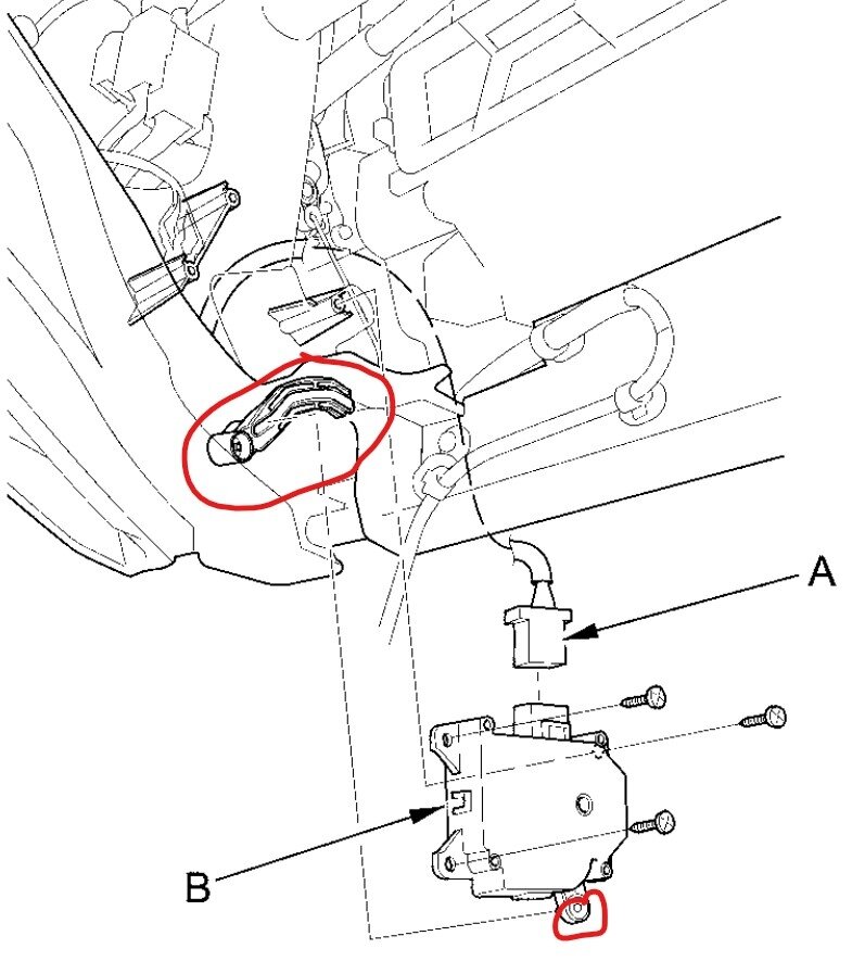

So past few times I've driven with the AC on, it felt like the van was still very warm inside. I just happened to reach over and feel the passenger vents and they were blowing HOT air like the heat was on. The driver side and rear vents were blowing cold, so the issue is the passenger side. What could cause only the passenger to be heat when the rest is blowing cold. They are all set for AC BTW

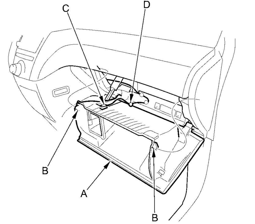

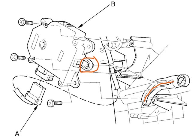

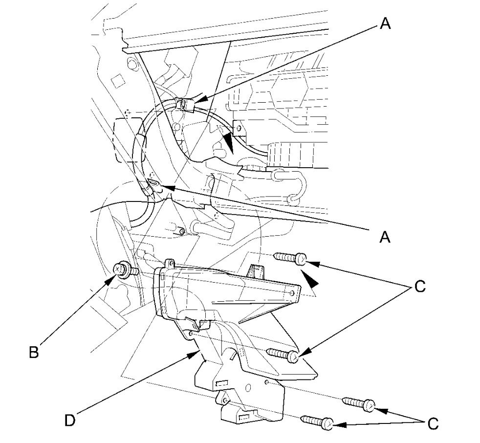

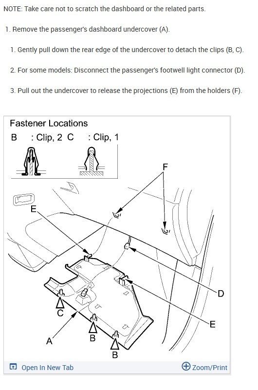

That would typically be due to a bad right side air mix controller (blend door). It is behind the glove box door area on the HVAC box. It could be stuck in the hot position if it is defective. To access it you remove the lower trim panel and the glove box from the dash. Then you remove the duct from the side of the HVAC case and finally the actuator. Note the pin and lever circled in the image, that lever may have broken or the actuator pin failed or the actuator itself went bad. You can remove the glove box and duct then watch to see if the lever moves, no motion is usually a bad actuator. I would advise using an OE part
if at all possible, I've gone to salvage yards to get OE parts when they were NLA or on global back-order. Honda 79170TK8A41 Most of the aftermarket ones don't last all that long, I've had them fail in under a week!

Yes. The blend door controls the temperature of the air. Air enters the HVAC box, either from outside or from inside depending on what the recirculate controls is set on. From there the air goes through the filter and into the fan, the fan blows it into the main AC case where it then goes through the AC evaporator core first. Then it hits the blend door. The blend door controls the airflow, if you select AC then it stays in one position and directs the cold air out of the case and into the vehicle. If you select any type of heat though the blend door opens and sends heat into the heater core area of the case. That gives you anything from mildly warm to full hot depending on how far the door moves to direct the airflow through the heater core. The air then hits the mode door(s) those direct the air through the defrost, vent or floor ducts depending on what is selected.
Your vehicle has dual blend doors and 2 actuators. The air through the case doesn't actually split until the blend door so if one is stuck on Heat and the other to AC you get the issue you have. One side hot from full heat through the core while the other side tries to cool it. It's also the reason I think that the dual zone (or more) systems are a waste of money and effort in a vehicle. Now if there were dividers to keep the zones separated it might make sense. Otherwise you get the result you get as well, the hot side just causes the entire vehicle to stay warm.

Ok I ordered the new blend door and cabin filter, thanks

Let us know what you find. The actuator and lever are the common failure items. If you have an inspection camera you could check it without taking things apart.

Ok I replaced the passenger blend door actuator and now it's all working as expected. The old one barely moved anymore. Also replaced the cabin air filter while I was in there.

PK, that sounds like the potentiometer in it has a bad spot, that will cause it to stop in the wrong spot. The reset revealed that issue because the calibration uses two item, one is the pot. the other is the motor current. When the door closes the motor in the actuator generates a current spike because it wants to keep moving, the control module sees that spike and reads the potentiometers position and says "That's one end", then it runs the motor the opposite way until it stops, and locks that in as the other end of travel. If the pot is faulty it will try to keep running like yours is. The left side is easier to get at and they sell more of them because the base version only uses that side not both so they are a little cheaper. When you install the replacement move the arm to be sure the door moves properly, then put the pin in the slot and put in the screws. Then connect it and reset and see if it all works again.
