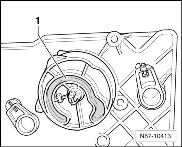

The car is not dual climate control. The passenger side only receives outside air. When the A/C is on in the summer the passenger side is warm from the outside air. In the winter the passenger side does not heat up only blows cold air and the windshield on the passenger side does not defrost. Suspect it is the blend door actuator on the passenger but cannot find the location. Please help.

It sounds like you have a couple things happening here. Lets start with the fresh air issue. There is a way to adjust the fresh air/recirculate door. I'm going to provide the directions. Do this first and let me know if it helps.
2011 Volkswagen CC (357) L4-2.0L Turbo (CBFA)
Fresh Air/Recirculating Air/Back Pressure Door Adjuster
Vehicle Heating and Air Conditioning Air Door Actuator / Motor Service and Repair Removal and Replacement Door Motors Fresh Air/Recirculating Air/Back Pressure Door Adjuster
FRESH AIR/RECIRCULATING AIR/BACK PRESSURE DOOR ADJUSTER
Removing
- The Fresh air/recirculating air/back pressure door motor (V425) with fresh air/recirculating air/back pressure door motor position sensor (G644) => [ Air Flow Door Motor V71 with Back Pressure Door Motor Position Sensor G113 ] See: Air Door Actuator / Motor, HVAC > Removal and Replacement > Air Flow Door Motor V71 with Back Pressure Door Motor Position Sensor G113.
- Open the retainers - arrows - on the adjusting lever - 1 -.
Pic 1
- Remove the adjusting lever from the curved washer.
- Remove the curved washer - 2 - from the air intake housing.

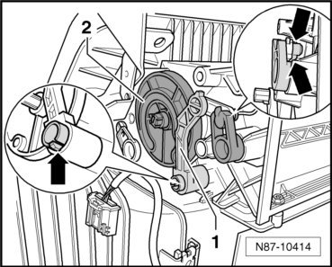

Installing
When installing the curved washer, make sure the guide pin for the air flow door adjusting lever is seated in the groove.
- Install the curved washer - 1 - on the air intake housing.
Pic 2
Make sure the guide pin for the recirculation air door adjusting lever is seated in the curved washer groove.
- Mount and latch the recirculation air door adjusting lever.

Let me know if this helps.
