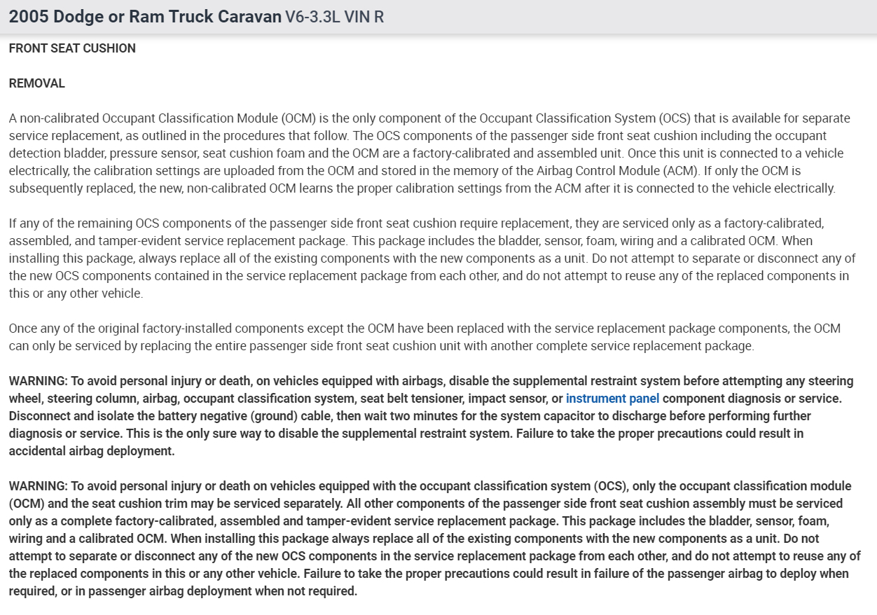

I hit a curb yesterday backing out of a driveway now the light is on for the passenger side airbag.
Jul 12, 2023 at 12:50 PM
  • 55,456 POSTS

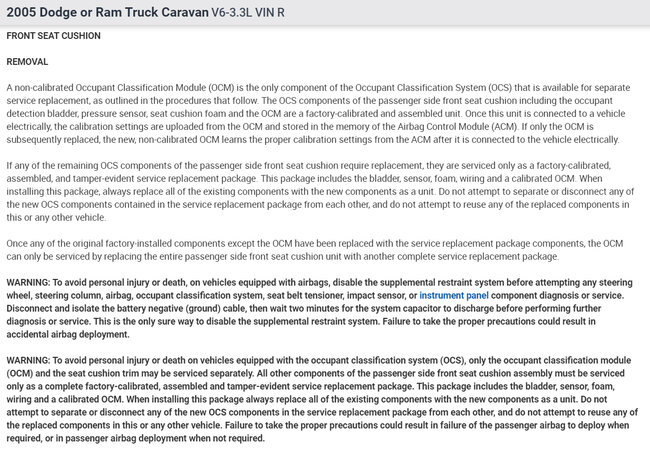

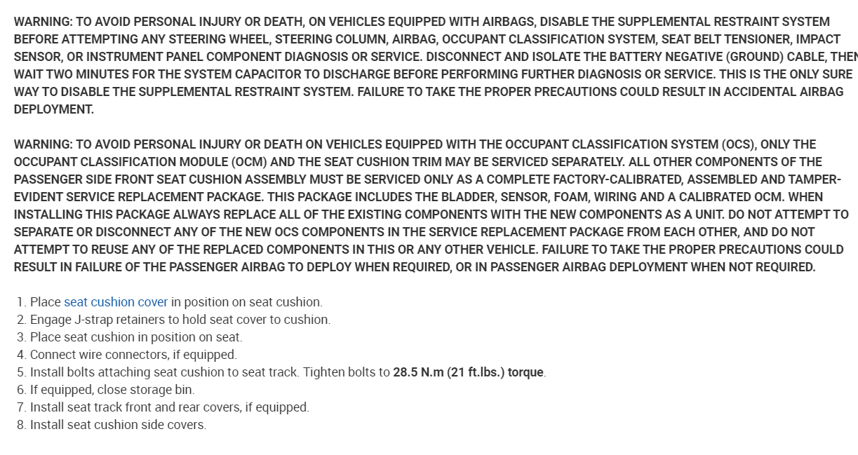

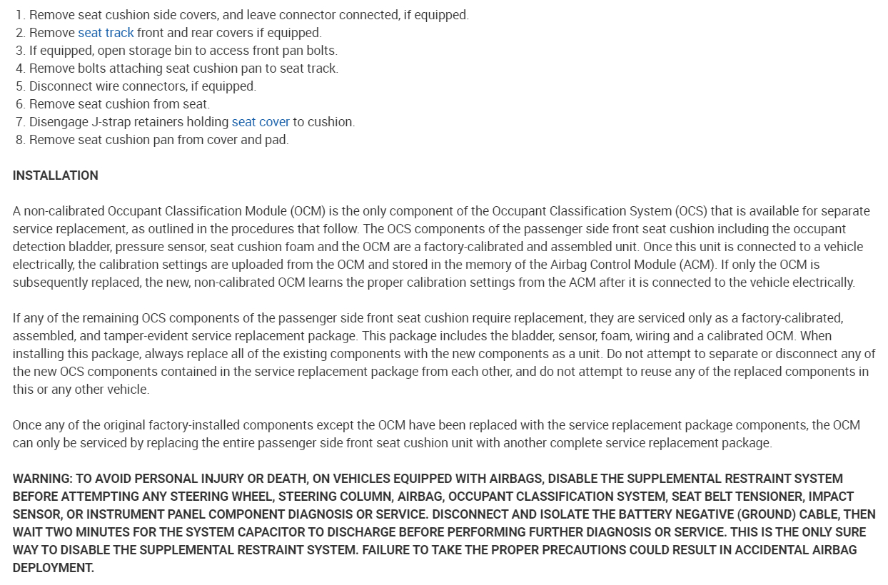

There is a weight sensor inside the passenger's side seat that sounds like it went bad, so can I ask if there is anything sitting in the seat such as a book etc.? If not let's run the airbag codes. Here is a guide to show you how with the instructions on how to swap the seat sensor out the images below in case a code comes up for it:
https://youtu.be/gnSGfEqrf_w
You can do a CAN scan as well; you can get a CAN scanner (Controller Area Network) which will work on most cars from Amazon.
https://youtu.be/u-4syLc-ifQ
Seat Weight Sensor
Vehicles equipped with the Occupant Classification System (OCS) have a seat weight bladder and pressure sensor unit that is integral to the passenger front seat cushion. The pressure sensor receives a nominal five volts and a ground through dedicated hardwired circuits from the OCM. The OCM then monitors the pressure sensor output voltage. Check out the images (below). Please let us know what happens.
