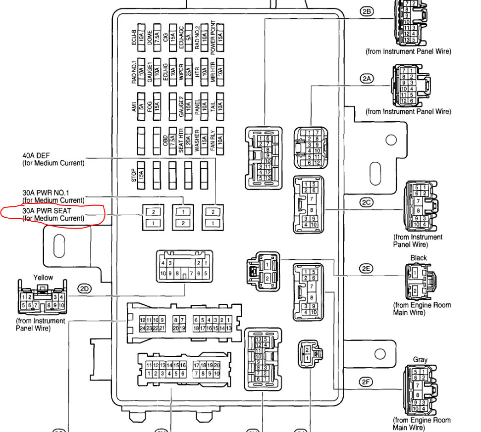

The front passenger seat is stuck in a forward position and will not move.
Sep 22, 2021 at 1:34 PM
SQM
  • 6,383 POSTS
Just to clarify, this is a power seat on the passenger side?
If so the first item needs to be checked is the fuse.
Check the fuse box that is at the left of the steering wheel. About the position where your left knee would be.
You will see a 30A fuse (see diagram).
