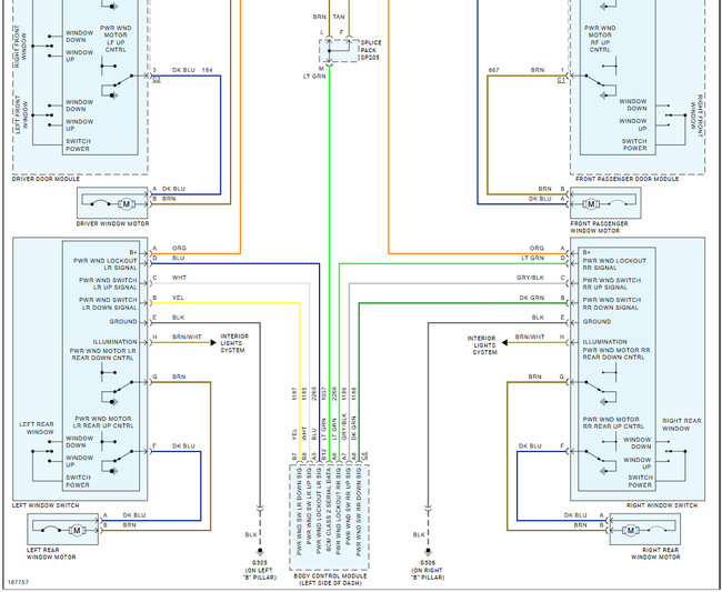

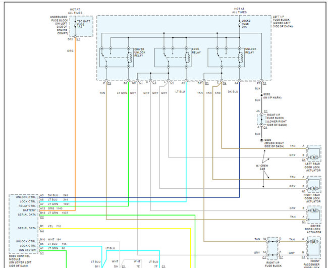

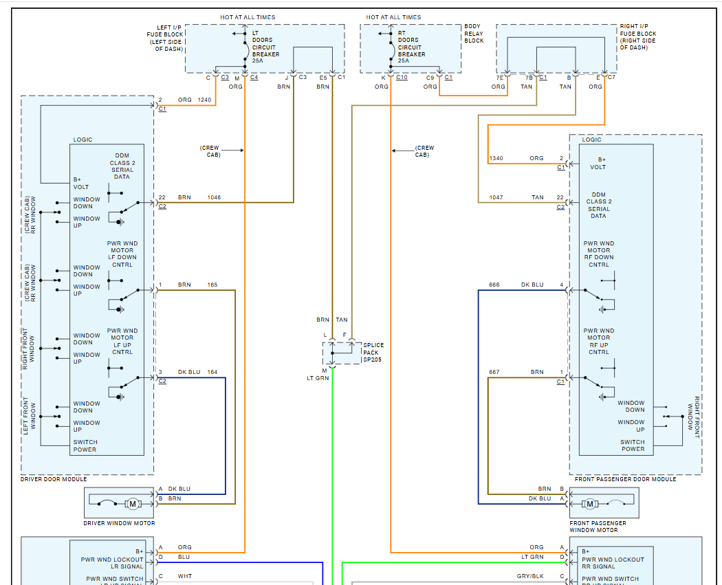

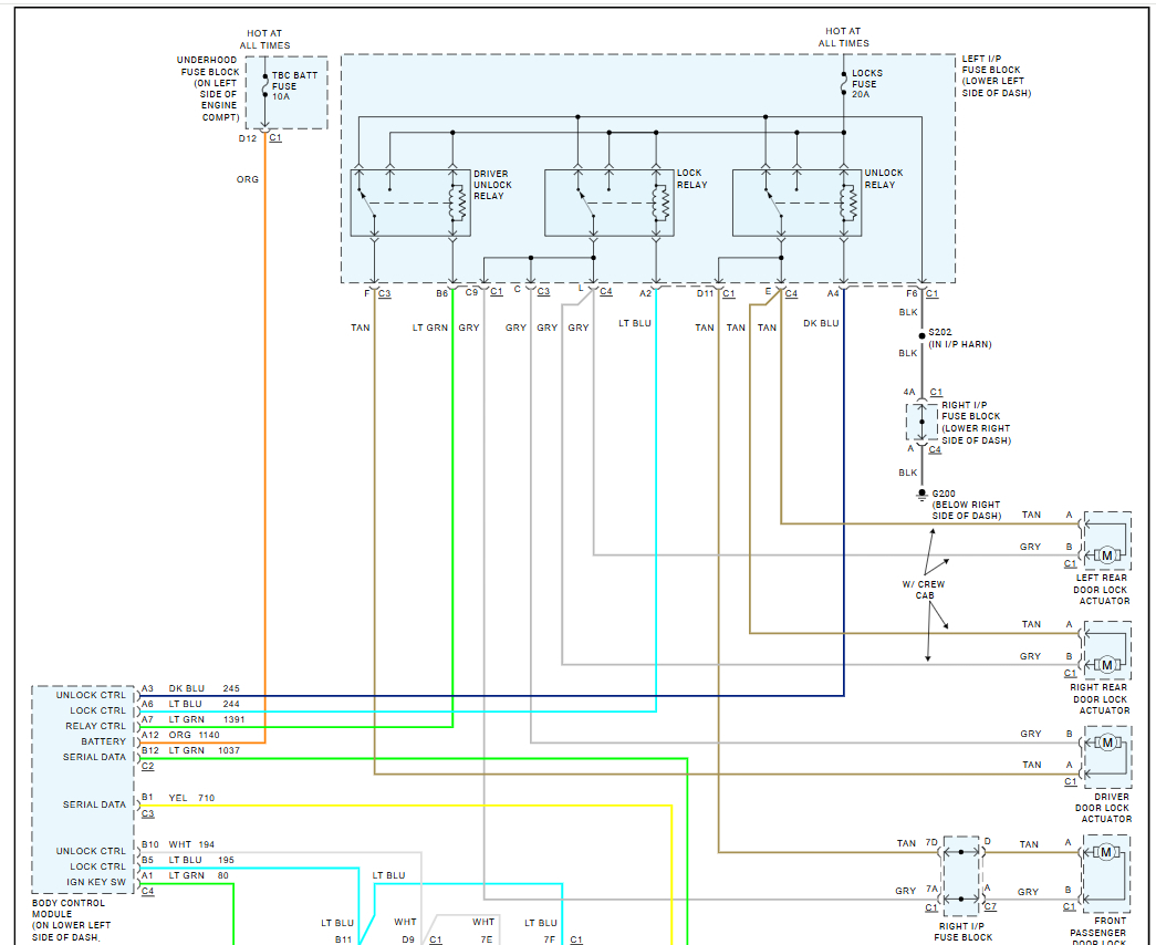

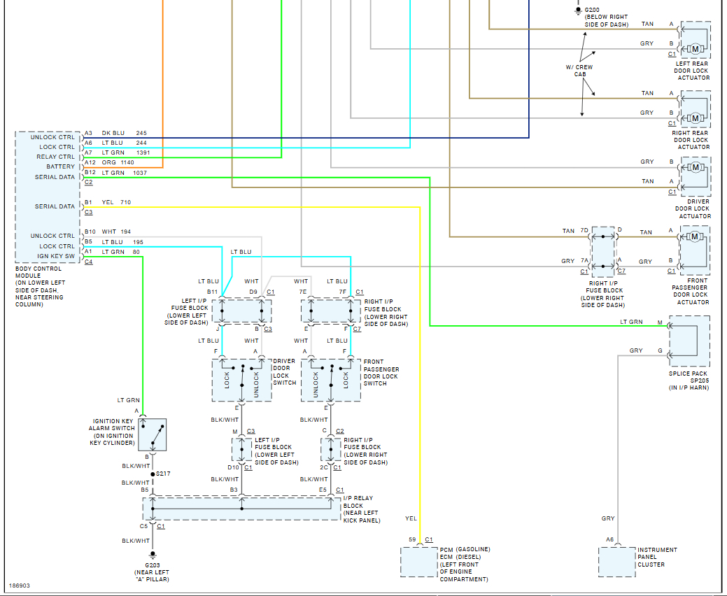

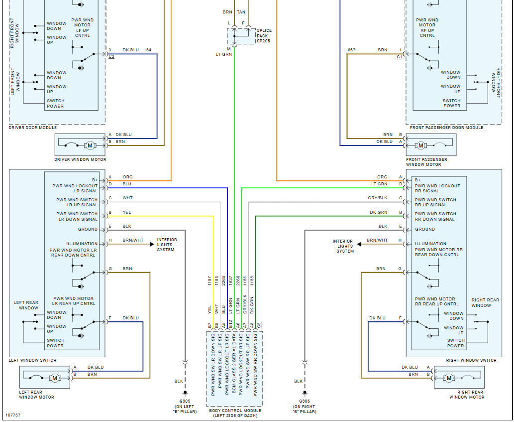

Looking for front passenger side door wiring diagram layout complete pdm.
Mar 22, 2025 at 8:44 AM
  • 55,433 POSTS
Here are the wiring diagrams for the door locks, window and PDM. Also, I have included a guide to help you with any testing you may need.
Check out the images (below). Let us know if you need anything else.
