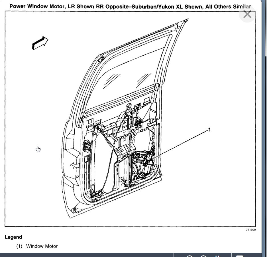

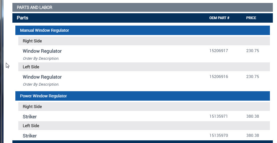

Diagram and parts list for passenger rear window system?

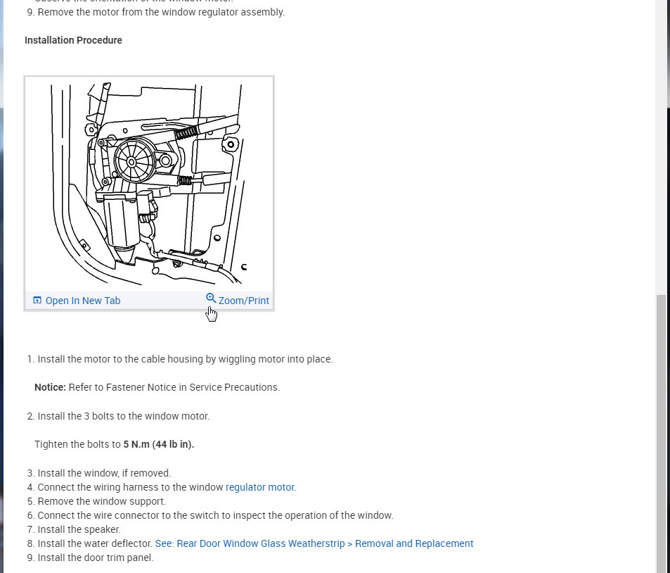

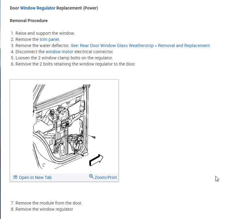

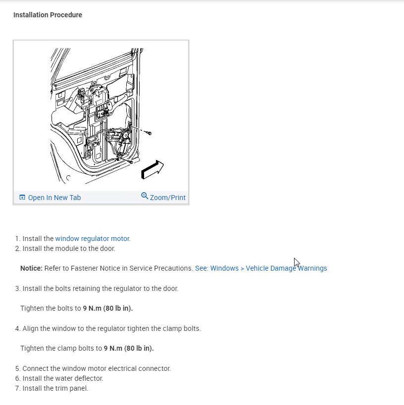

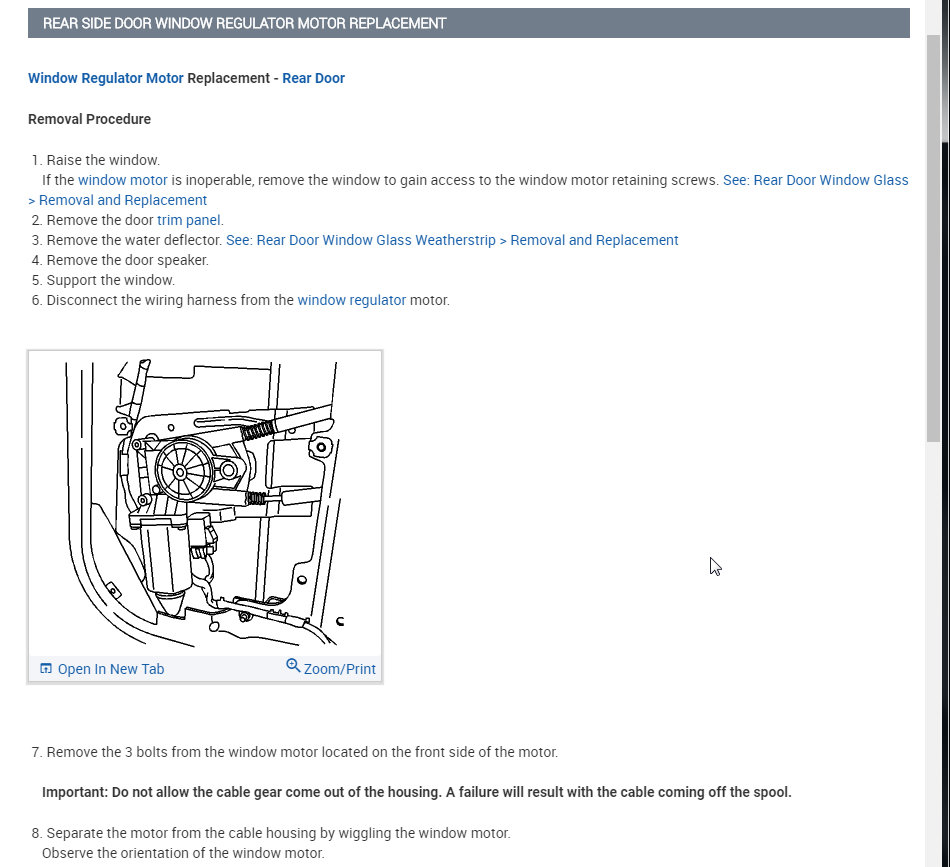

I assume you are looking for the motor and regulator system? There are a number of other components like trim and weatherstripping but I provided the info on the motor and regulator system. Let me know what other parts you may need and we can get them as well. Unfortunately they don't have an "exploded view" of the door showing every component. We would need to go through the door one piece at a time. Thanks
