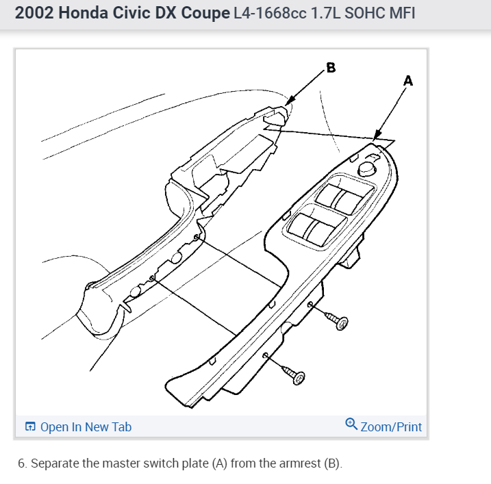

Hi, the right rear window works with only the door switch, but not the master on drivers door. Where do i start? Thanks, Neil
May 1, 2019 at 5:43 AM
  • 55,763 POSTS
Hello Neil,

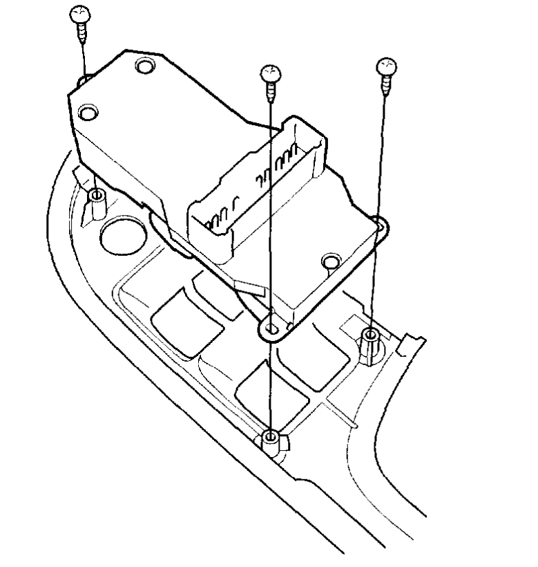

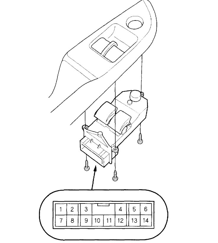

This sounds like a classic master door switch failure but to be sure here is a guide to help walk you through the testing and the master switch replacement diagrams and instructions below.
https://www.2carpros.com/articles/electric-window-repair
