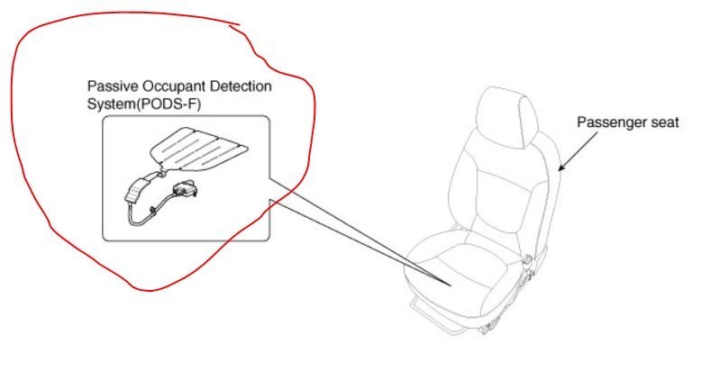

If you have the main air bag light staying on, the system will not work. I can provide directions if you want to try the repair yourself. The only thing is you will need an upper level scan tool to communicate with the vehicle. However, if you at least want to see how it is done, here are the directions. The attached pictures correlate with the directions.

PODS-F Zeroing procedure
You should perform PODS-F Re-zero procedure after service or replacement about all part of the passenger seat. (Not included full seat assembly)
1. Ignition "OFF", connect GDS.
2. Ignition "ON" & Engine "OFF", select Airbag system and "PODS-F Reset" mode.
pic 1
3. The GDS will show the two PODS-F Zeroing function steps.
(1)Erase PODS-F diagnostic codes.
(2)PODS-F initialization.
pic 2
CAUTION:
This step must be done PODS-F re-zero, when the front passenger seat is empty.

I hope this helps. Let me know if you have other questions. The last pic I attached shows the actual part that is bad.
