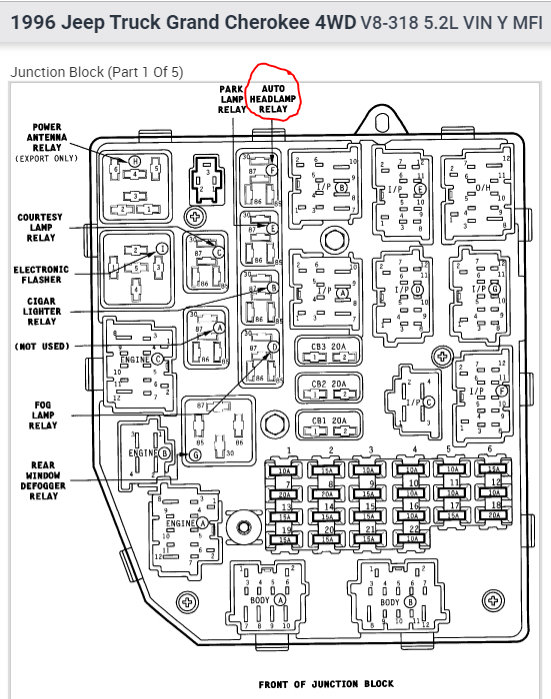

No high or low beam. The drivers side is fine. Have replaced the headlight fixture and the bulbs. The turn signal light works. not sure if it is a loose connection.

First thing you might want to check is the headlight relay.Here is a tutorial showing how to test a relay:
The relay is located in the junction box which I've attached a picture below and circled in red.Hope this helps and thanks for using 2CarPros.
