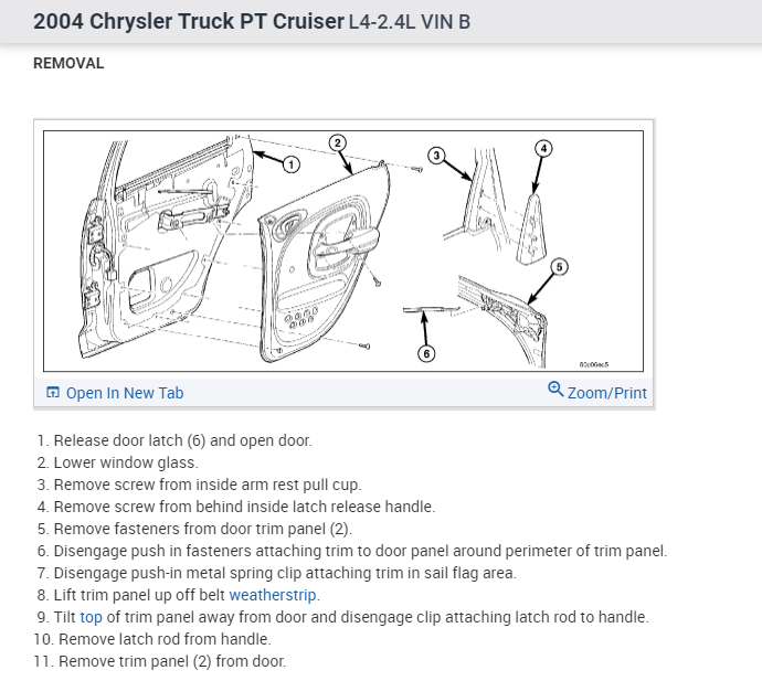

The back passenger doors will not open and both door handles are not in great condition. I managed to open the driver's side passenger door with nice, bypassing the door handle and rolling down the window and pulling hard on the inside door handle. I tried to open it again and it will not open again. The child safety lock was not on. The passenger back door will not budge. Thank you in advance.
May 6, 2023 at 11:06 AM
  • 110,244 POSTS

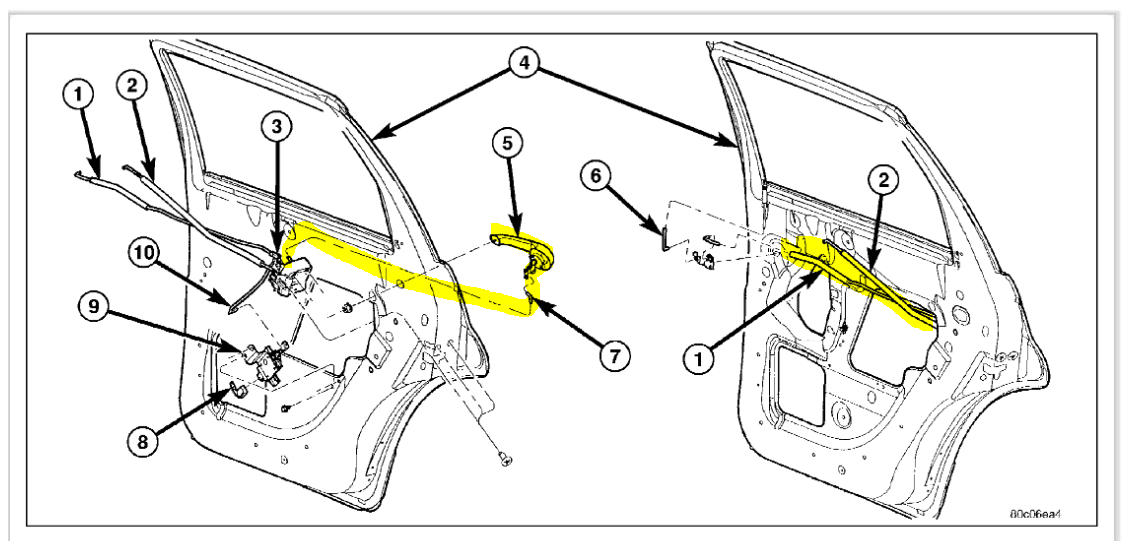

There are different rods and linkages inside the door. If I had to guess, I would say either they are disconnected, bent, or broken. (See pic 1)

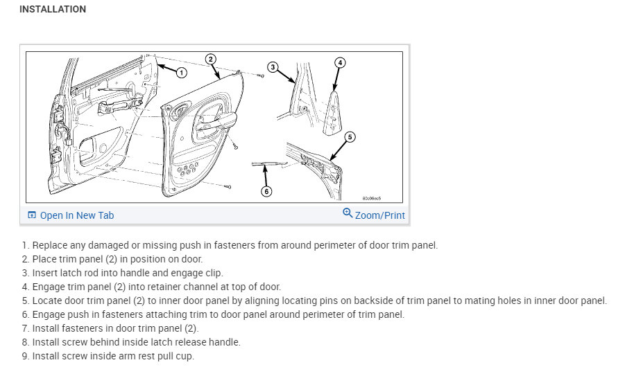

We need to remove the door panel to check things. The remaining pics are the directions for removing and installing the door panel. Not being able to open the door is going to make this much more difficult, but it can be done.

Okay, I tried it by diagram but due to the door not opening my fat hands can’t get down to the bottom I’m going to get my smaller brother to do it when he comes over. Thank you for the wonderful advice.
