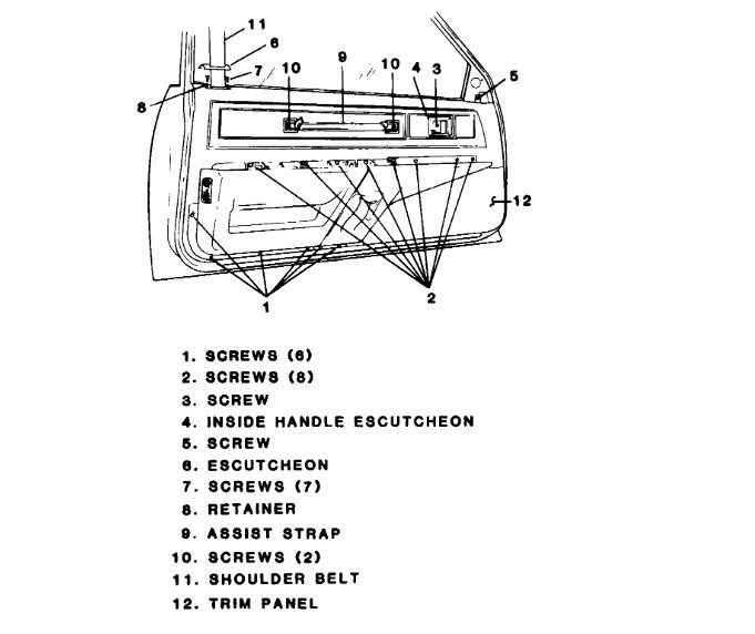

Good morning,

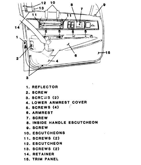

I attached pictures of what needs to be removed for the procedure.

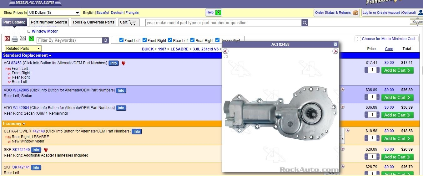

I also attached the window motor for you if it is the issue.

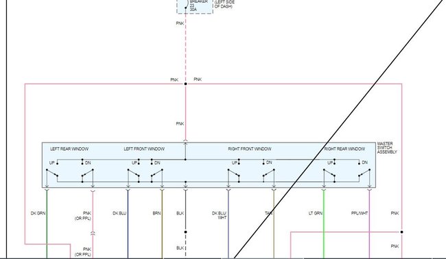

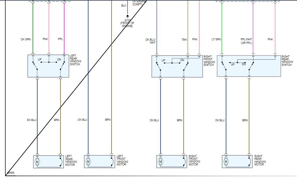

The wiring diagram is attached as well in case you want to verify power to the motor.
REMOVE OR DISCONNECT
1. Switch plate (power window system) using a thin-bladed tool between armrest pad and switch plate to disengage retainer on switch plate from armrest.
2. Wire harness from switch on switch plate (power window system)
3. Screw at front of armrest pad to armrest base (power window system)
4. Armrest pad by pulling straight inboard.
5. Reflector (1) using a thin-bladed tool between reflector and armrest to disengage tabs on reflector from armrest.
6. Screw (2)
7. Screws (3)
8. Lower armrest cover (4)
9. Screws (5)
10. Armrest (6)
11. Window regulator handle if present.
12. Screw (7)
13. Inside handle escutcheon (8) by disconnecting wire connector (if present).
14. Upper trim panel
15. Screw (9)
16. Escutcheons (10) or ends of assist strap.
17. Screws(11)
18. Escutcheon (12)
19. Screws (13)
20. Retainer (14)
21. Trim panel (15), by disengaging fasteners on trim panel from holes in door inner panel using tool BT-7323 or equivalent between trim panel and door inner panel.

WINDOW MOTOR
1. Door trim panel
2. Water deflector
3. Window regulator and motor.
4. Motor from regulator using a 4.8 mm (3/16") drill bit, and drill out rivets holding motor to regulator.
INSTALL OR CONNECT
1. Motor to regulator using (3/16") rivets.
2. Window regulator and motor to door.
3. Water deflector.
4. Door trim panel.

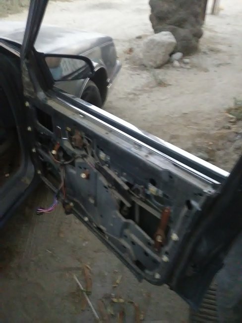

Looks like i'm going to have to remove rivets.
Jun 29, 2020 at 1:24 PM
That is correct.
You will need to drill out the rivets to release the regulator assembly.
Once they are removed, the assembly will come out of the door. You can either install new rivets if you have a rivet gun or use nuts and bolts to secure the regulator.
Jun 29, 2020 at 8:49 PM
BUICK_DUDE
  • 91 POSTS

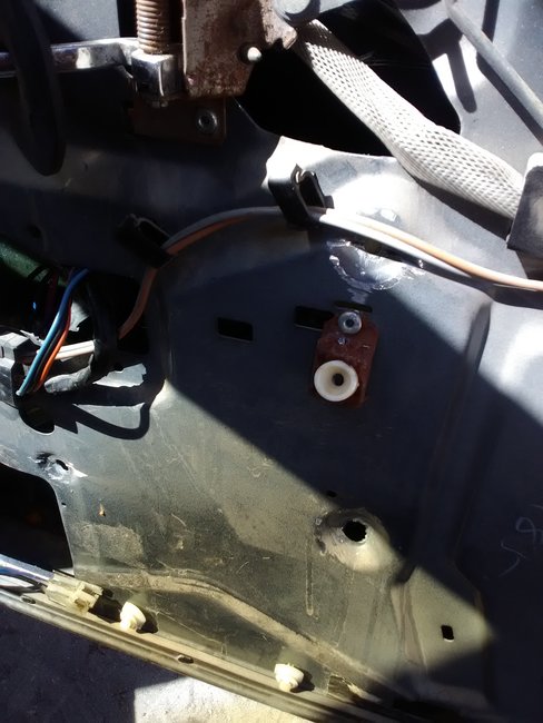

Removed three rivets and unplugged motor, but it just hangs there doesn't want to come out.
Jun 30, 2020 at 9:01 AM
You may have to slide it around to get the roller off the other channel.
The picture had no light. You cannot see anything.
