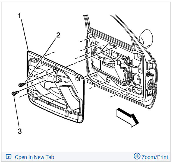

One more question. A friend and I had to replace the outside door handle we got that done with no problem, but he didn't get the wires plugged in correctly because now I can't lock my truck, nor can I use the mirror control to adjust that outside mirror. Is there any way you could send me a picture of what plugs up to where so I can solve this issue. Thanks

It sounds like the switches on the door panel are not plugged in. It does not show the wiring connectors you will need to look for them. This is what they show us. Check out the images (below). Let us know how it goes.
