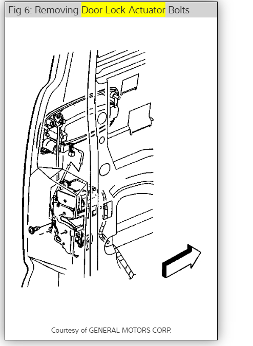

So my passenger door doesn’t lock. The driver side does and the power locks do work to the driver side when I press it but not on the passenger side. I do not know if it can be the lock cylinders, or the door lock actuator or any other component I’m missing in the system. I doubt it’s the lock cylinder because it turns freely when I put the key in but it doesn’t lock not even manually.
Aug 9, 2023 at 7:09 AM
  • 55,433 POSTS

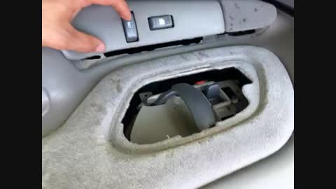

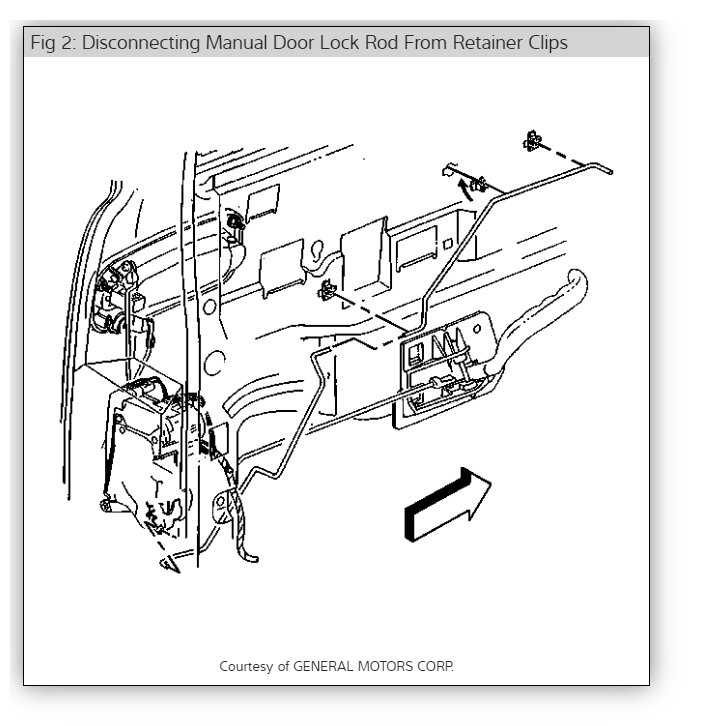

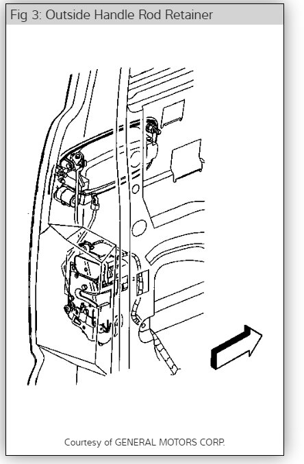

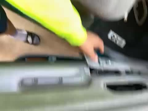

You hit it with the lock actuator being weak which I have seen. here is how to change the lock actuator out. Thanks for the video it helps. Here is a new one for $30.00 on amazon:
https://amzn.to/3QACc6P
Check out the images (below). Please let us know if you need anything else to get the problem fixed.
