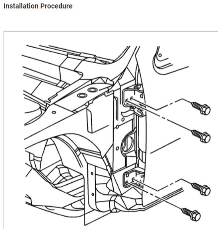

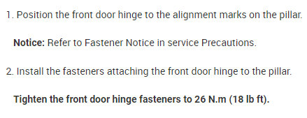

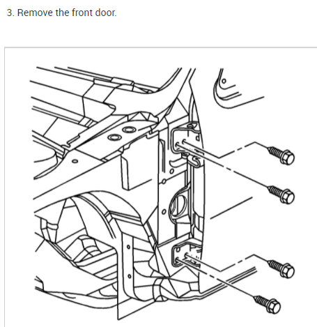

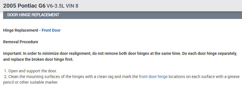

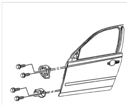

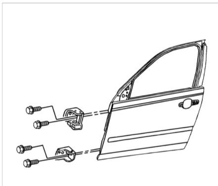

I have a problem with my passenger door closing. how can I go about fixing it myself?
May 4, 2021 at 6:40 AM
DANNY L
  • 5,648 POSTS
Hello again.
Does it seem like the door isn't closing by fault of the door hinges , Or the door not latching-staying closed from the door latch? I've attached picture steps below on how to replace the door hinges on your car. Get back to us and let us know if this helps. Thanks again for using 2CarPros.
Danny-
