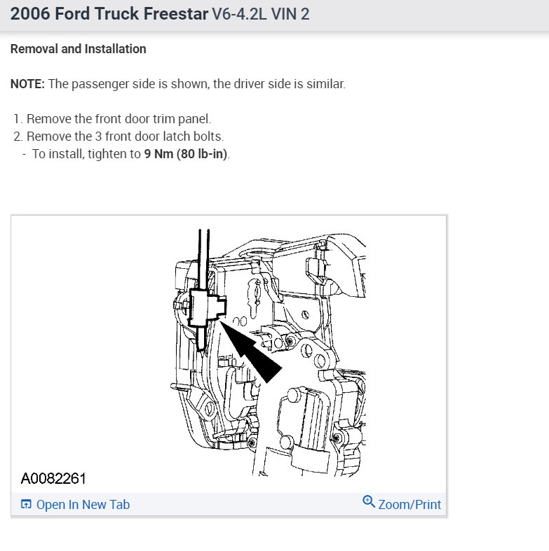

Car has an awful alarm that goes off nonstop saying passenger side door is open. Is there a way to bypass this?
Aug 3, 2022 at 12:33 AM
  • 55,433 POSTS

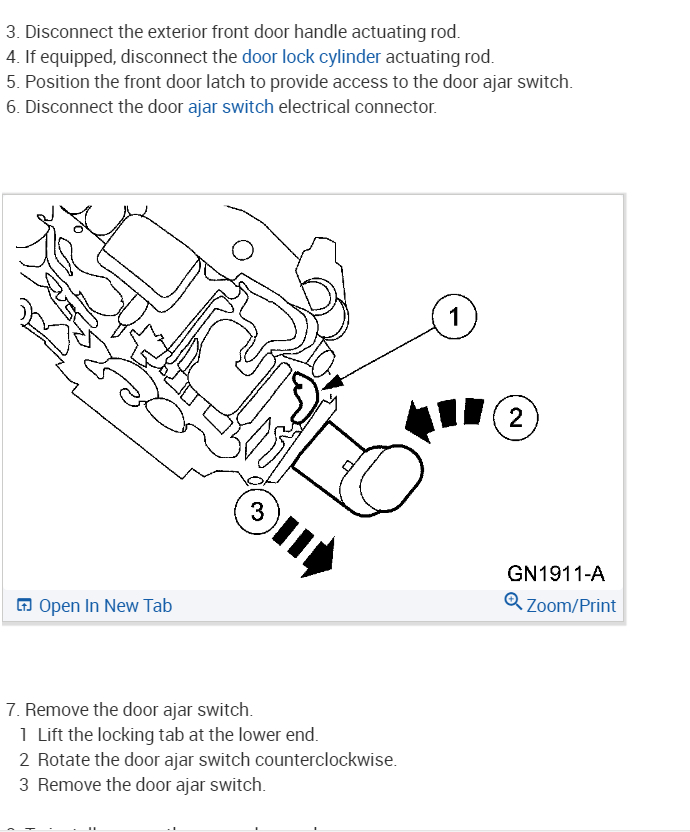

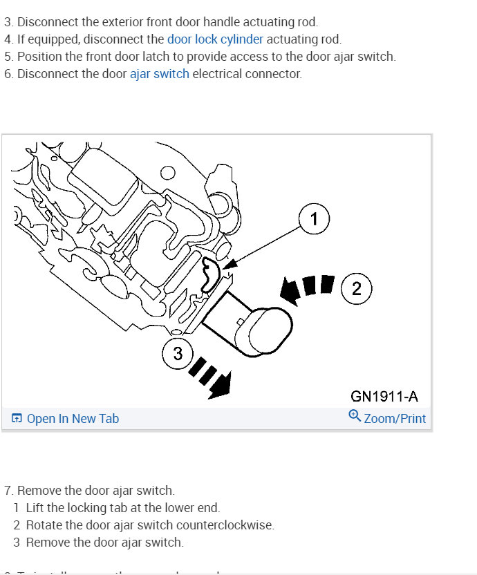

Sure, connect the light green to the black wire of the of the door ajar switch in the door jamb of the passenger door. You may need to remove the switch, which means removing the door panel to get to the wiring. here is what the switch looks like with a generic guide to help you remove the door panel:
https://www.2carpros.com/articles/door-panel-removal
