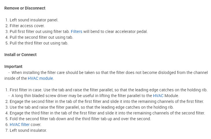

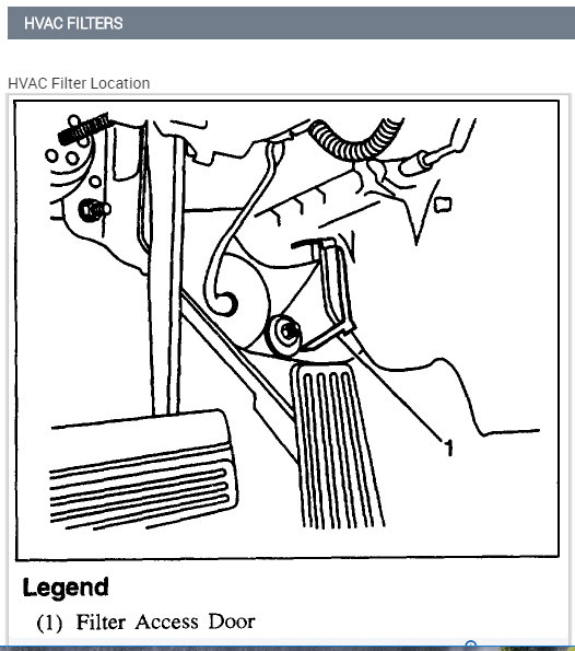

Unable to remove filter, there are two flaps, do I pull on them?
May 17, 2019 at 6:21 AM
DANNY L
Experienced Mechanic
5,648 POSTS
Hello, I'm Danny.

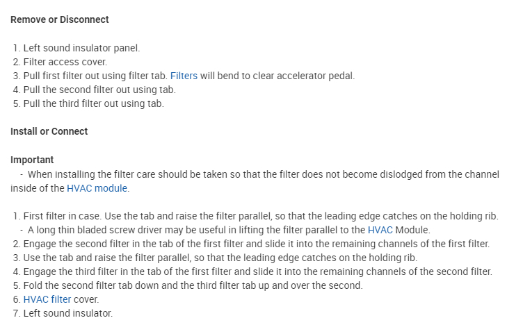

Yes, you need to use the tabs to remove.Here is a tutorial showing what is involved:
https://www.2carpros.com/articles/how-to-change-an-air-cabin-filter
I've attached a picture and instructions below.Hope this helps and thanks for using 2CarPros.
Danny-
