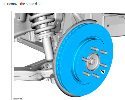

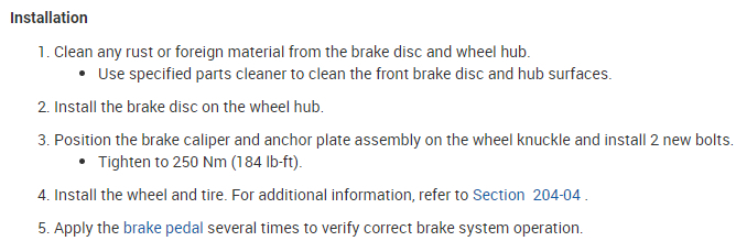

I want to do the brake please give me instruction on how to do so.
Nov 26, 2018 at 8:57 AM
DANNY L
  • 5,648 POSTS
Hello, I'm Danny.

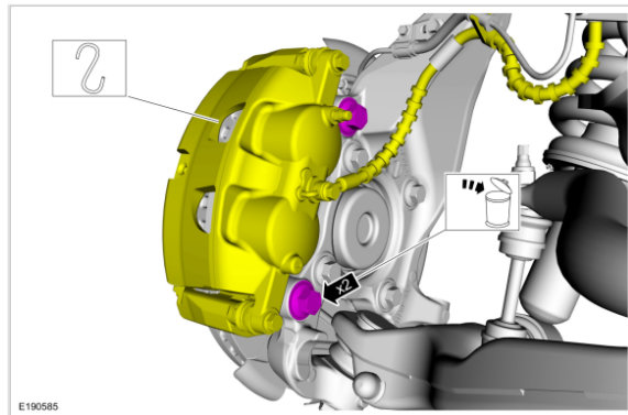

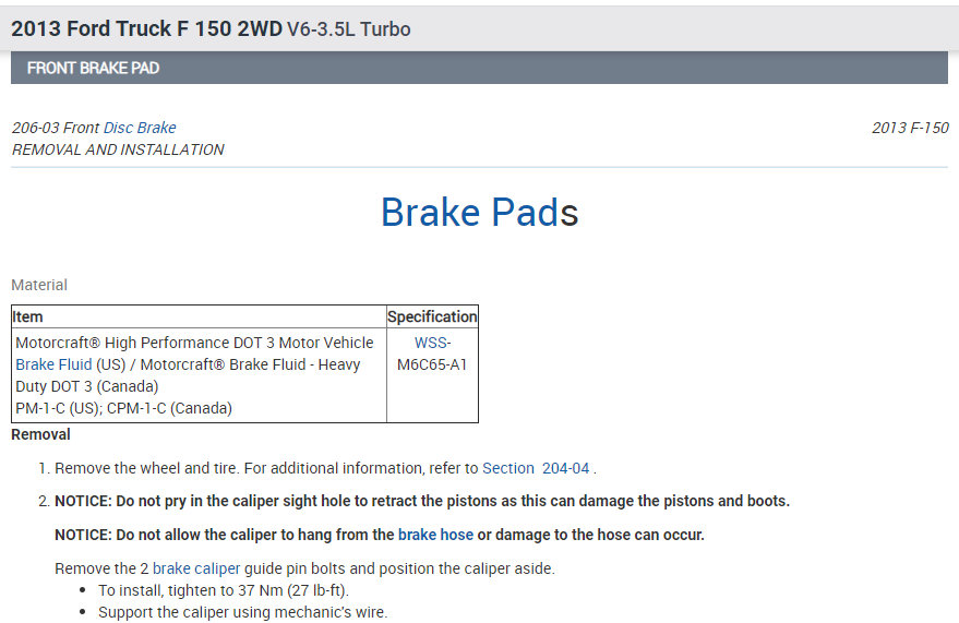

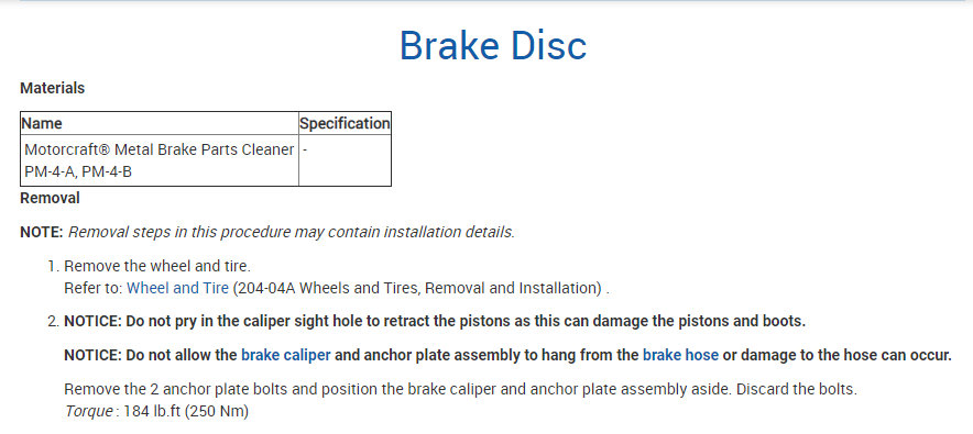

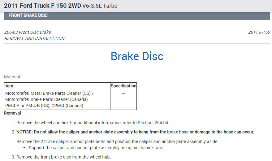

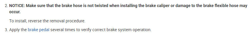

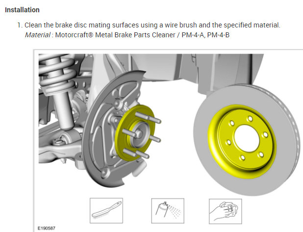

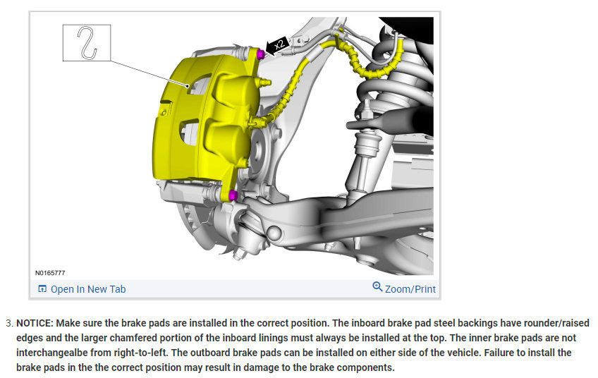

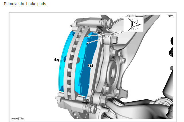

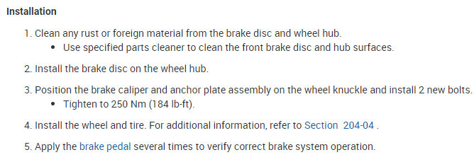

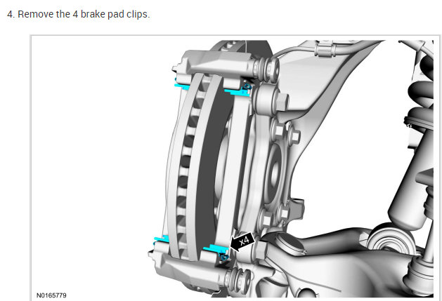

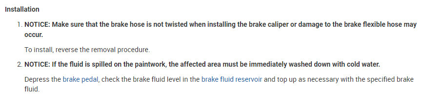

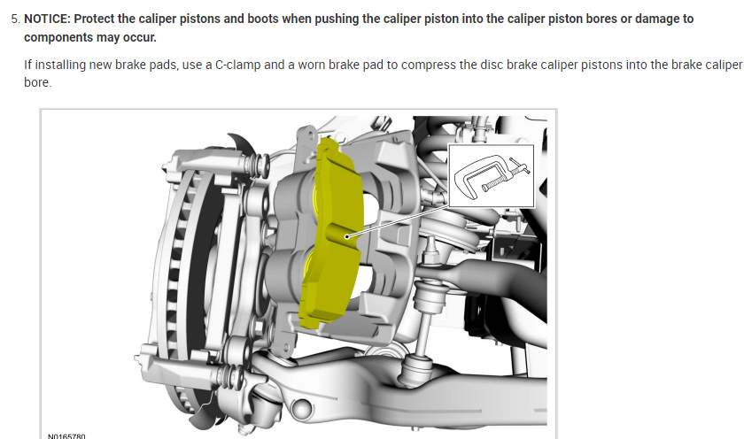

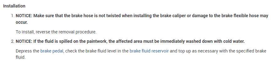

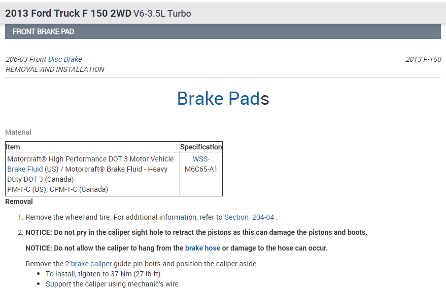

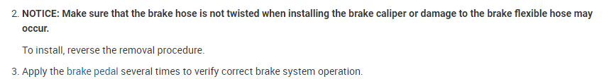

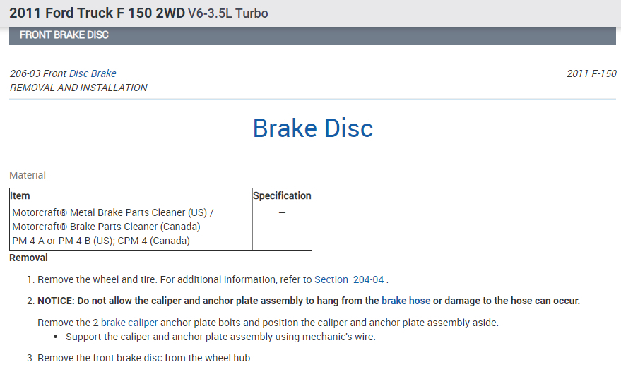

Here is the information you requested. This is a tutorial showing what is involved on how to change front brake pads and brake rotors:
I've attached picture steps below on how to change the front brake pads and rotors on your truck. Hope this helps and thanks for using 2CarPros.
