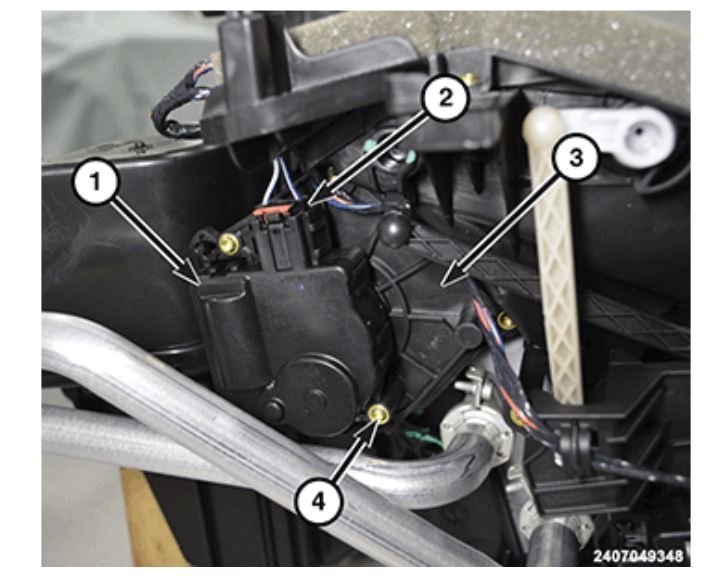

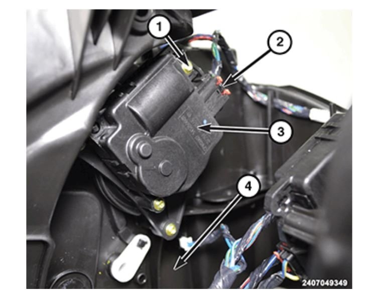

Does the A/C work normally when this clicking noise happens? It usually does not take speed for the actuator to start making noise.
LEFT SIDE
Disconnect and isolate the negative battery cable. If equipped with an Intelligent Battery Sensor (IBS), disconnect the IBS connector first before disconnecting the negative battery cable.
Remove the steering column. (Refer to 19 - Steering/Column/Removal) .
Remove the two screws (4) that secure the blend door actuator (1) to the left side of the HVAC air distribution housing (3).
Remove the blend door actuator from the air distribution housing. Disconnect the HVAC wire harness connector (2) and remove the actuator from the vehicle.
RIGHT SIDE
Remove the glove box from the instrument panel. (Refer to 23 - Body/Instrument Panel/GLOVE BOX, Instrument Panel - Removal) .
Remove the two screws (1) that secure the blend door actuator (3) to the right side of the HVAC air distribution housing (4).
