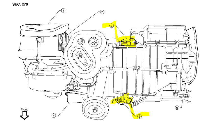

Where is the passenger blend door actuator located?
2015 NISSAN FRONTIER
112,000 MILES • 4.0L • V6 • 4WD • AUTOMATIC
BRYAN S
When the A/C is on the driver's side blows cold, but passenger side blows hot. I replaced the driver side actuator located on top behind the radio. It was brought to my attention that there is a passenger side actuator. But where is it?
Oct 8, 2024 at 3:31 PM
  • 110,193 POSTS
If you have dual zone climate control, yes, there will be two. If it only has single zone HVAC, there will only be one.
I attached a picture below and highlighted both actuators. The lower one, number 5, is the one for the passenger side.
Let me know if this helps.
See pic below.
Oct 8, 2024 at 7:32 PM
BRYAN S
Great! Thank you. This confirms some info I found. My next question. Is this accessible from below the dash or do I need to remove the glove box?
Oct 9, 2024 at 6:02 AM
  • 54,832 POSTS
You will need to remove the glovebox and any under dash trim panels. Sometimes these can be difficult to get to.
