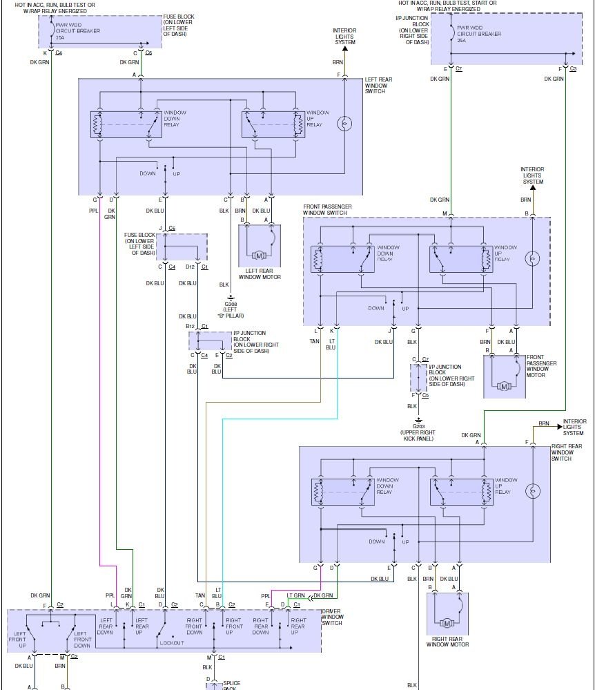

Master switch rolls down all windows except passenger rear. And all windows roll down with their dedicated switches. Looking for wiring diagrams for if anyone can tell me what wires to test with a test light that would be very helpful.

If you feel it is a wiring problem. check the loom where it goes through the B pillar into the door, the constant flexing can cause wires to break. this is a problem seen on many makes and models, start here.
Dec 31, 2016 at 7:09 AM
STEVE W.
  • 15,352 POSTS
Right rear door wiring:
Dark blue wire in door harness = Main power to all door switches feeds from the drivers master switch lockout button.
Black wire = Ground for rear door attaches to B pillar under the trim.
Light green out of master switch splices to dark green at the door = Window up control feed.
Purple wire = Window down control feed.
Brown and dark blue inside door feed the window motor.
My bet is that the dark green wire is broken in the harness to the rear door or the light green wire from the master switch through the door flex harness in the driver's door has broken.
GM has altered the wiring in the newer trucks, each door now gets a power line to it and the switches trigger relays in the switches to control them. They no longer use the older reverse polarity feed from the main switches to the way they used to. Supposed to be "more reliable" that way.

Chad, I just realized it has to be the purple wire. You have up but not down in the right rear correct?
At least that wire is the same color on both ends. (well if the diagram is correct)

Okay, left rear, no up/down from master switch but works at door switch. Still the same color wires.
Purple wire brings the window down, dark green puts it up.
Easy way to test, pop the master switch out of the door. Pull the connector.
Should be two purple wires, one pairs with a dark green the other with light green. Take a jumper from battery positive touch the purple wires one at a time. The rear window for each should go down. Do the same with the light and dark green. Those will put the windows up. If they work with a jumper the switch or the connector you are testing has to be bad.
Because the windows work with the correct door switches the regulators and motors are okay, it is either the wires or the master switch.
