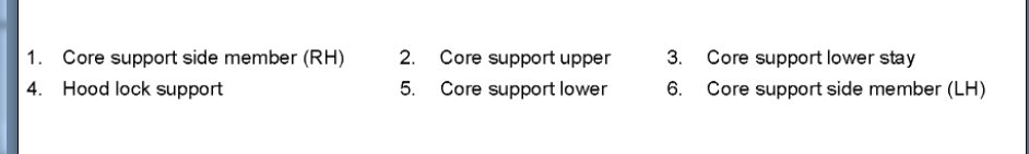

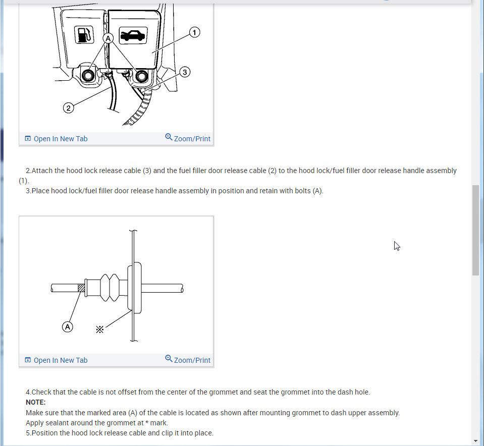

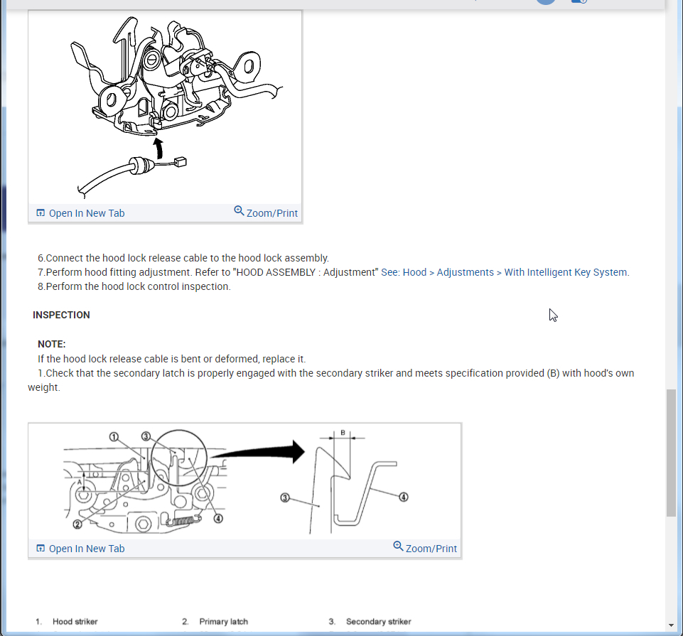

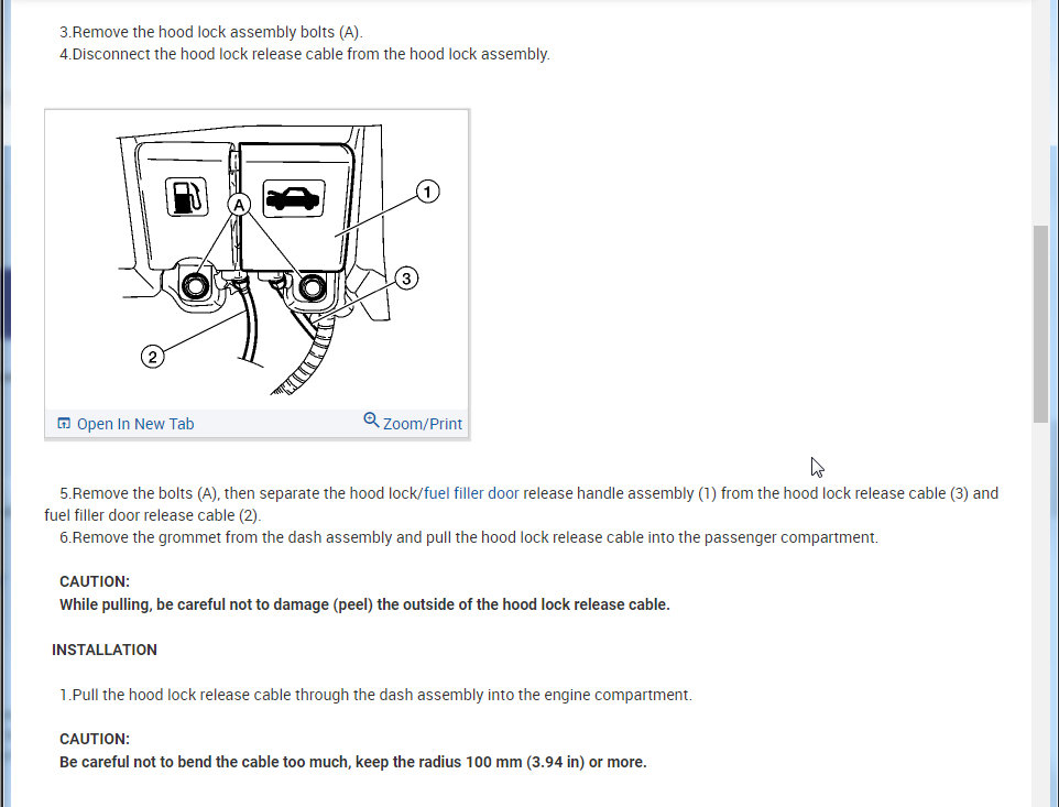

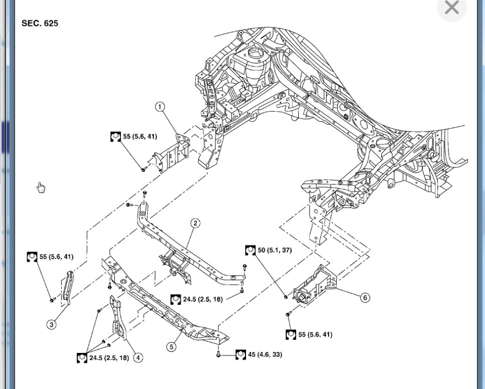

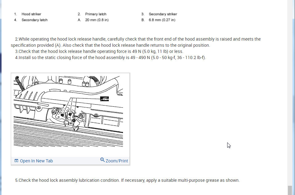

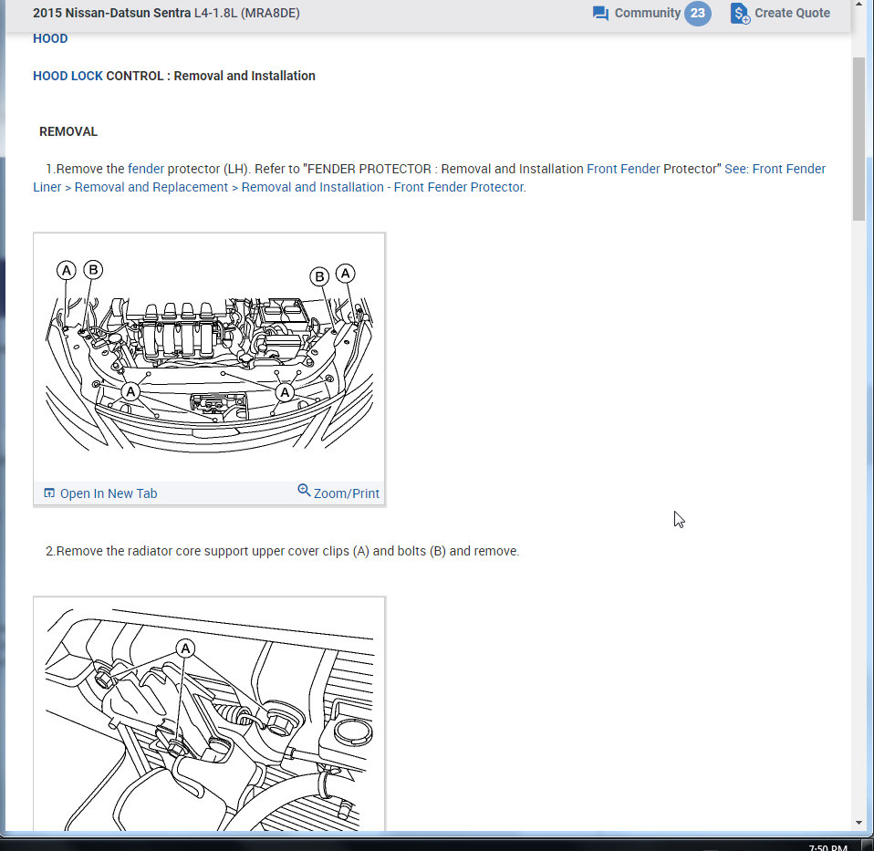

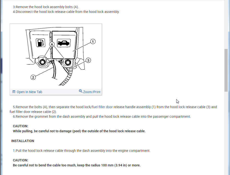

Can you get some pictures of what you are dealing with? By upper radiator, I assume you mean the core support? Also, I attached the latch information as well.
Sorry you are dealing with this as that is not fun. It is one thing when you have to figure out a difficult problem but cleaning up after another is never easy.
Please let us know if you need other info. Again, if this is not the info that you need, please send some pictures and we will have a better idea. Thanks
