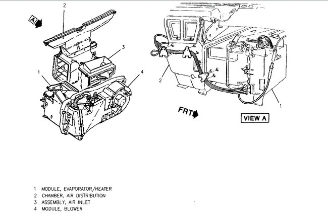

What is the housing called that the blend door actuator sits behind
1995 PONTIAC BONNEVILLE
132,000 MILES • TURBO
MOLO
What years if any are parts (like the housing) interchangeable for the car listed above SSEI?
Jul 31, 2020 at 12:12 PM
  • 110,194 POSTS

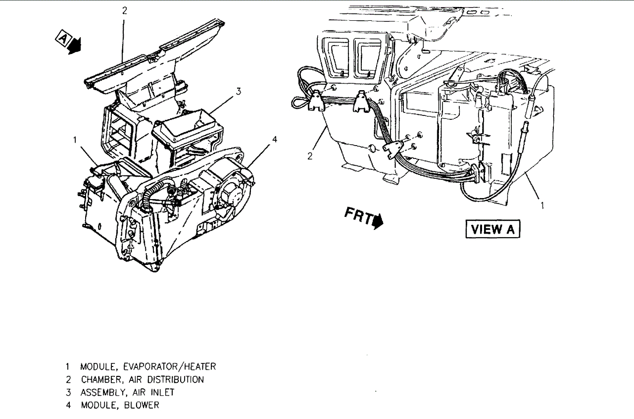

I attached a pic below showing what I believe you are referring to. It is the air distribution chamber. Some call it the HVAC box.
As far as interchange, I would imagine years close to it should be the same. However, I don't have an interchange listing. Hope you understand.
