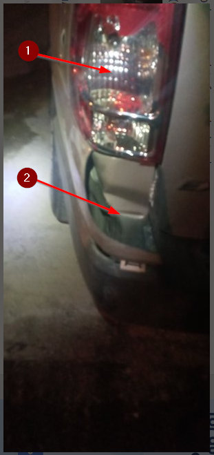

My mother was hit from behind
Mar 20, 2022 at 12:25 PM
Just to be clear, you are looking for what these parts are that appear to be damaged?
If so, take a look at the picture below. Number 1 is the taillight.

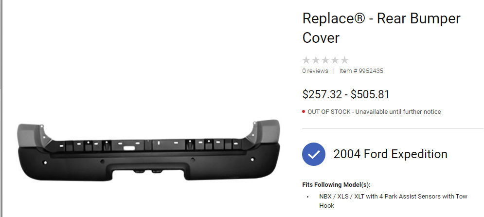

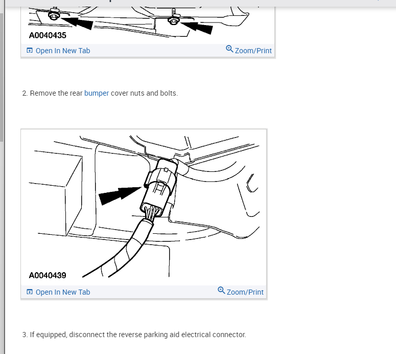

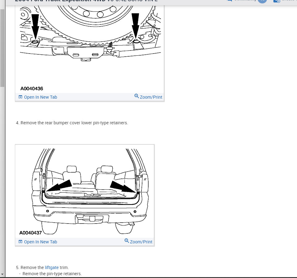

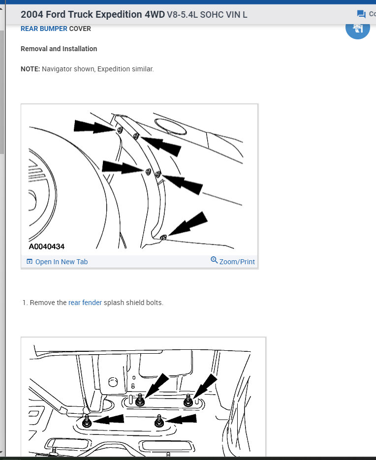

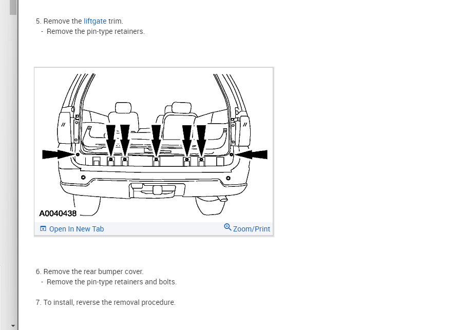

Number 2 is part of the rear facia or bumper. I am attaching the info on how to replace this below which will also give more detail on what it is.
Please run through this and let us know what other questions you have. Thanks
