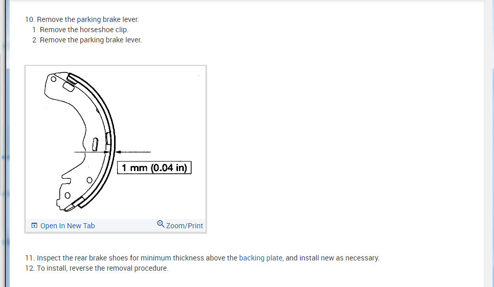

I have the vehicle listed above XLT 08/07/2003 imported from USA. I have a problem with the rear brakes that I absolutely have to be changed. I am looking for the reference to help me.
Help me please.
Jan 20, 2019 at 11:22 PM
No problem. Here is a guide that will help with this:
https://www.2carpros.com/articles/how-to-replace-rear-brake-shoes-and-drums
Also, if you need to do the front in the future, here is a video that shows how to do it on your vehicle:
https://www.youtube.com/watch?v=dlIUJOYnYQc

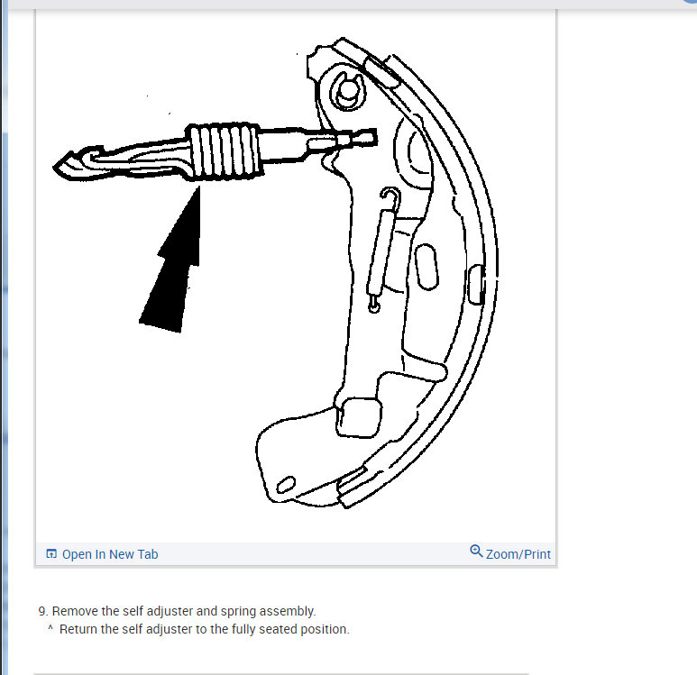

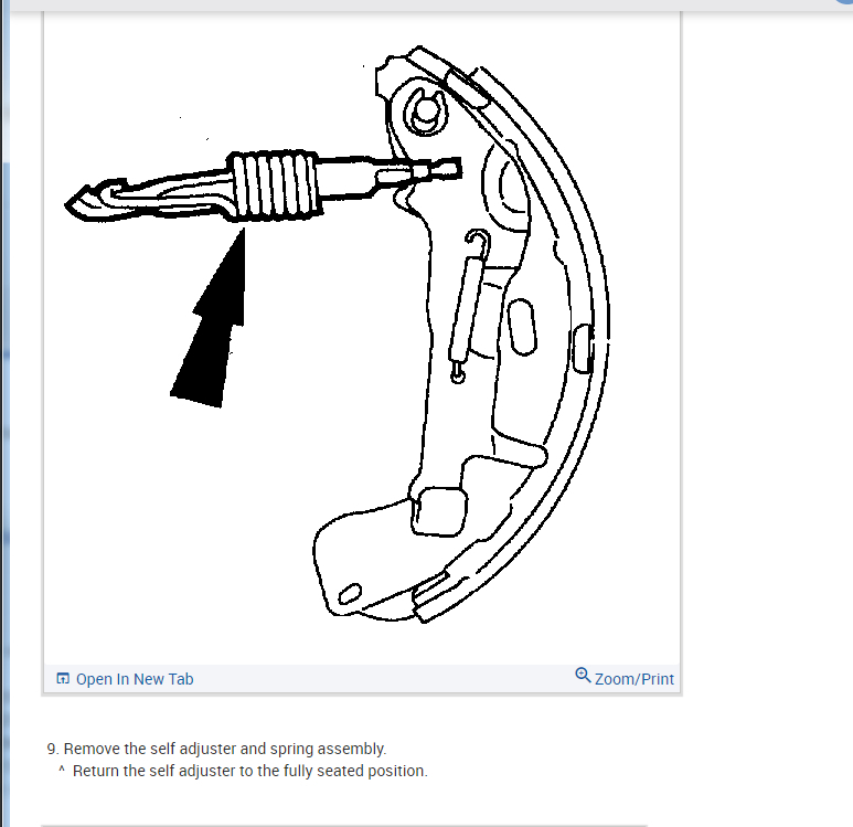

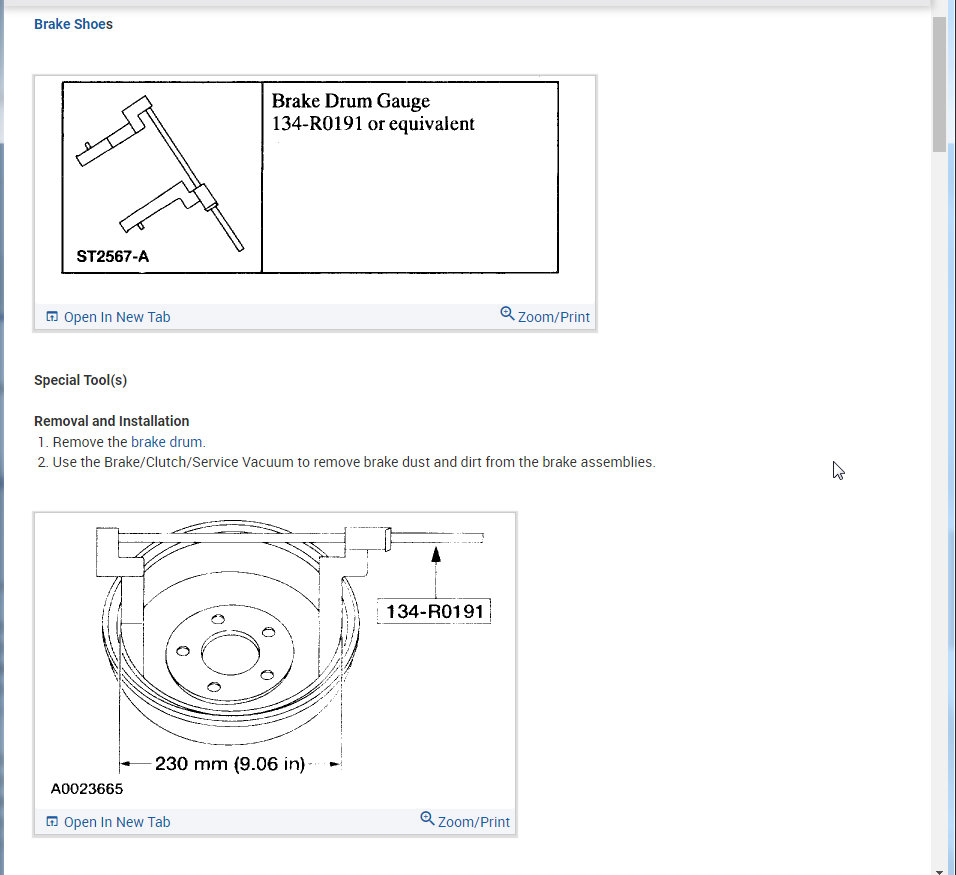

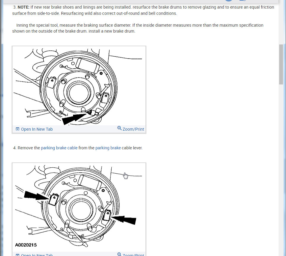

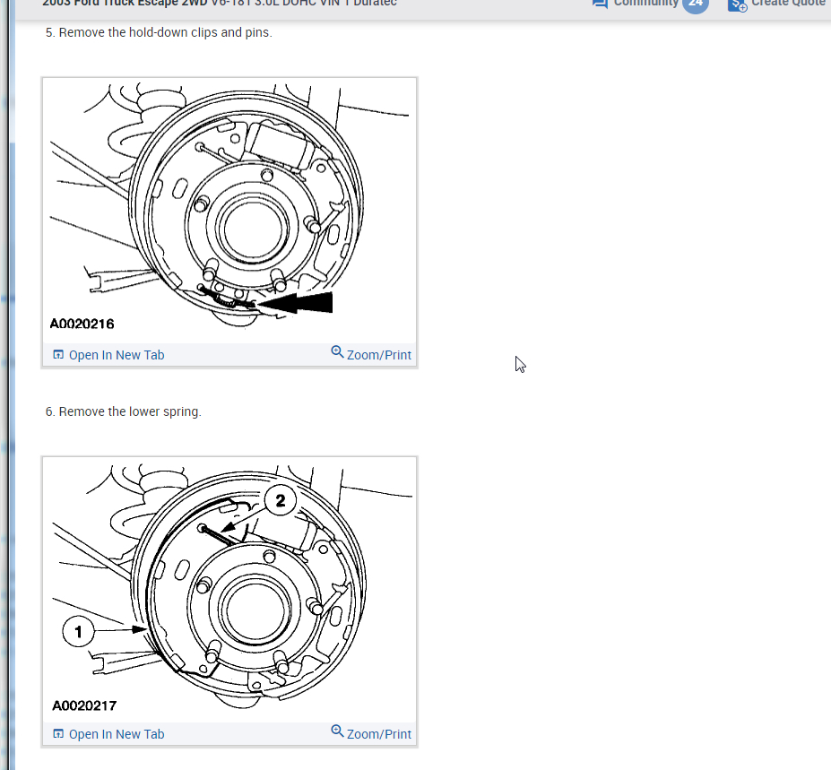

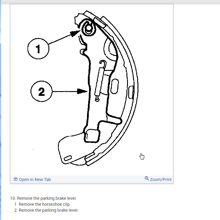

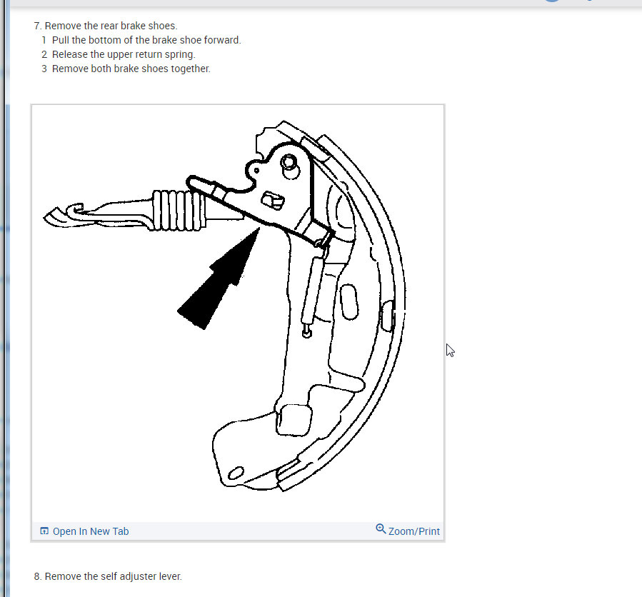

Plus below you will find the process from the manual that will give you step by step instructions on how to do this.
Let us know if you have questions.
