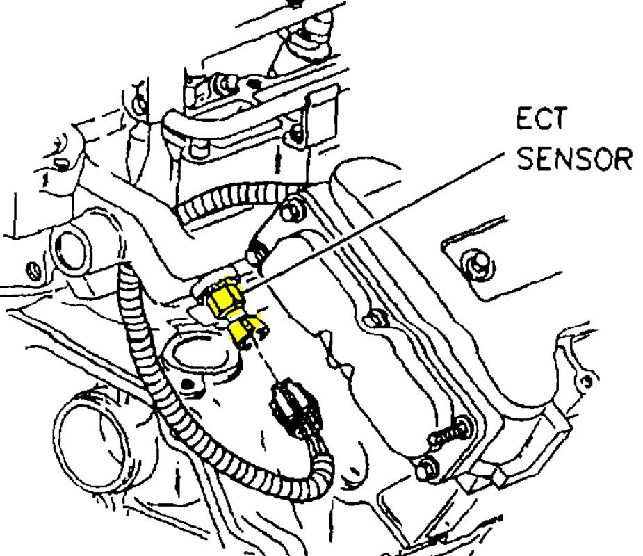

Where is the temperature sensor and coolant level sensor located at on my car?
Apr 11, 2021 at 11:37 AM
STEVE W.
  • 15,345 POSTS
The ECT is located in the rear of the engine in the coolant tube just above the bell housing flange on the block. You can see it if you look in the area between the exhaust crossover the intake manifold and the cylinder head. To get to it for replacement you need to remove the air intake duct then the MAF sensor. Next you may need to remove the exhaust crossover. I have been 50/50 on that, some have enough room to snake an extension and socket in there to get the sensor, others are built with not enough room. Next you need to drain the coolant below the sensors level and disconnect it and remove it. Reverse the process to install a new one.

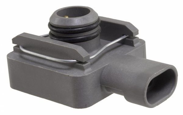

The level sensor is in the tank on the side of the radiator below the area where the radiator cap is attached. With the coolant drained you remove the retainer clip and pull the sensor out, apply a bit of silicone to the o-rings on a new one and press it into the port, then install the retaining clip.
What issue are you having that points to these being a problem?

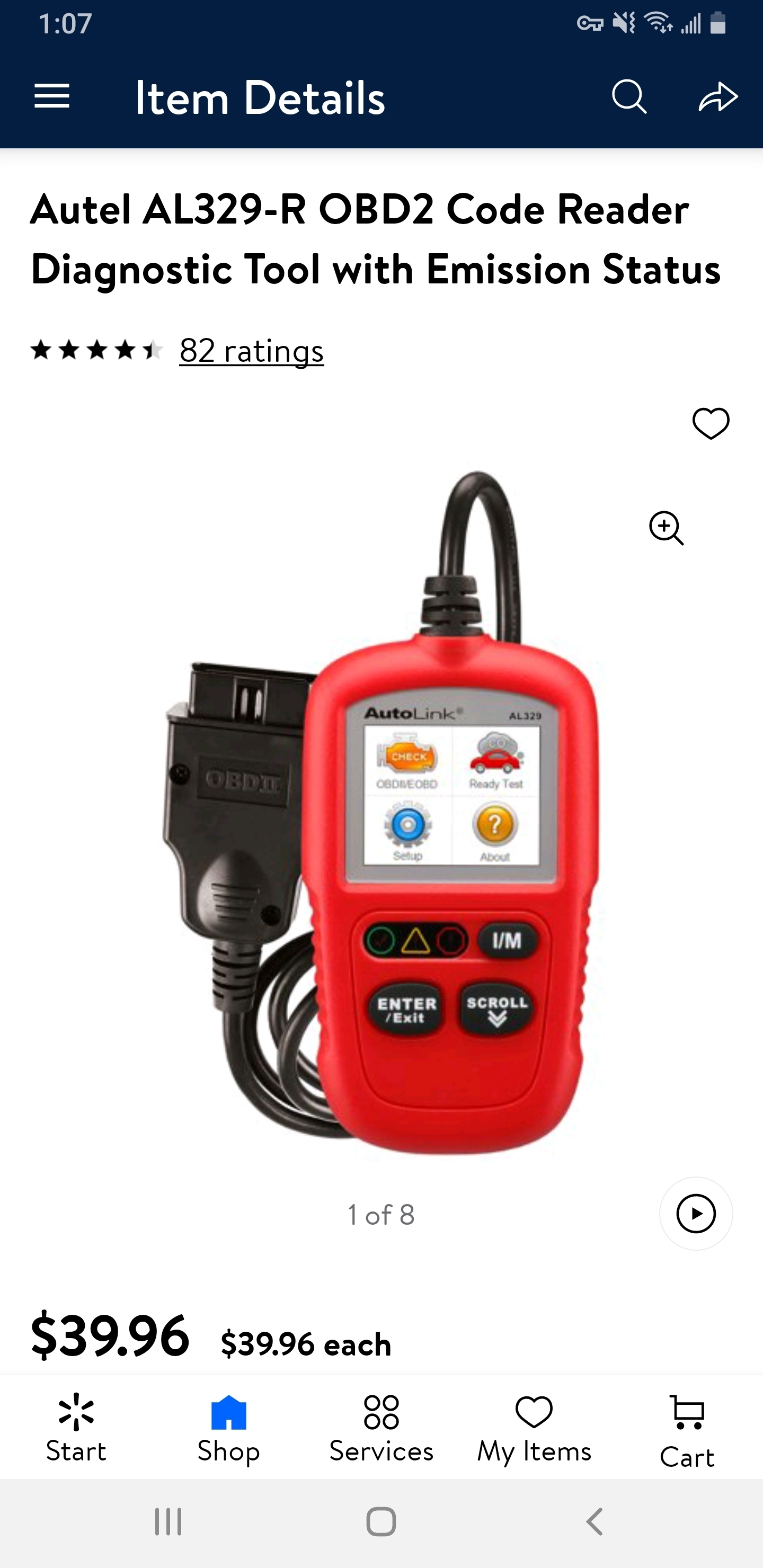

I just have a regular Walmart scanner.

Do you know what make and model? They sell a few and some can read limited live data. In this case you want to see what the coolant temperature sensor is showing as the coolant temperature. If you only plug the tool in, but don't run the engine the ECT temperature should be whatever the air temperature is. Then start the engine and let it warm up. If it starts rising the sensor isn't the problem.

This one.
Apr 12, 2021 at 4:09 PM
LIONELL8732
  • 150 POSTS
What numbers am I looking for the ECT and the fuel trims?
Apr 12, 2021 at 4:10 PM
STEVE W.
  • 15,345 POSTS
Okay, that one should read some live data. The ECT will be listed as coolant temp or similar. If you test with a cold vehicle it should read the same as the current temperature, then once you start the engine it should rise and top out around 195 or a bit higher. The main thing is does it report the temperature. If it is then the sensor isn't the cause of the code. For the fuel trims you want to look at the ones short and long term. If it is running rich on bank one you will see the fuel trim numbers with a - sign in front of the ones for bank one, as the system will be trying to remove fuel from that side. Ideal fuel trims should total zero, so say you read a long term of -5 but the short term is 9, you are seeing a trim of 4 positive. With a rich code I would expect the trims to read more like -15 long term and -4 or higher on the short term. In that event you need to determine where the extra fuel is coming from. It could be something as simple as the purge solenoid being stuck open. That could show as a rich code depending on where the EVAP system feeds the intake. It could also be something like a bad valve stem seal or oil control rings, the O2 sensors cant tell the difference in what is making the engine run rich, if it's actually fuel or oil, the sensors just see that there isn't enough oxygen in the exhaust.

all parts were put on after and i'm not understanding what's going on now. so i looked down where the coolant level sensor was and noticed that it not a hooked up. now am really lost now because i don't no where the connection is.
Apr 13, 2021 at 5:09 AM
STEVE W.
  • 15,345 POSTS
Well that would cause the problem you have. Just need to track down the connector, it should be a two pin connector with a yellow and a black wire. Should come down below the intake toward the back of the engine.

yes was able to find the wire and hooked it back up and i was good to go no more P0172 code.
