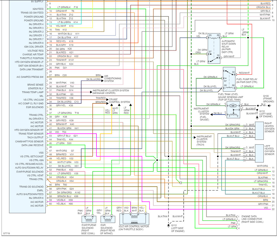

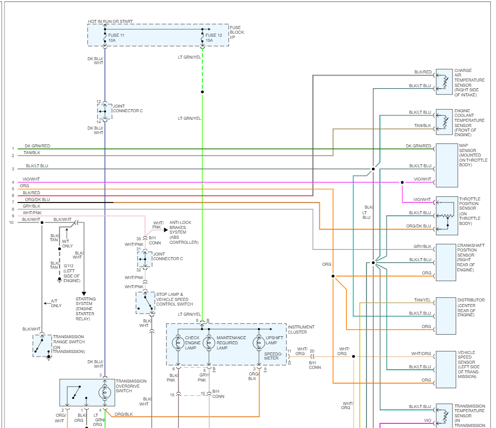

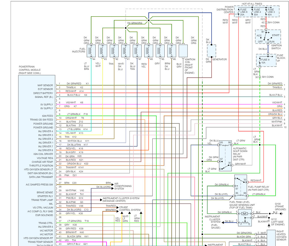

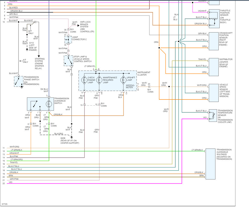

Where is the harness to the part. Throttles unlock solenoid harness and part located on a 46rh transmission.
Oct 14, 2022 at 9:36 AM
  • 55,627 POSTS
I am not sure what you mean by "Throttle unlock solenoid" but here are the engine and transmission wiring diagrams to help you see how things work and what wires to test.
This guide can help as well:
Check out the images (below). Let us know what happens and please upload pictures or videos of the problem.
Oct 15, 2022 at 6:15 AM
CARADIODOC
  • 34,413 POSTS
Hi Ken. I think he's referring to lock-up solenoid for the torque converter. I've seen it listed as the "part-throttle unlock solenoid" on some wiring diagrams.
