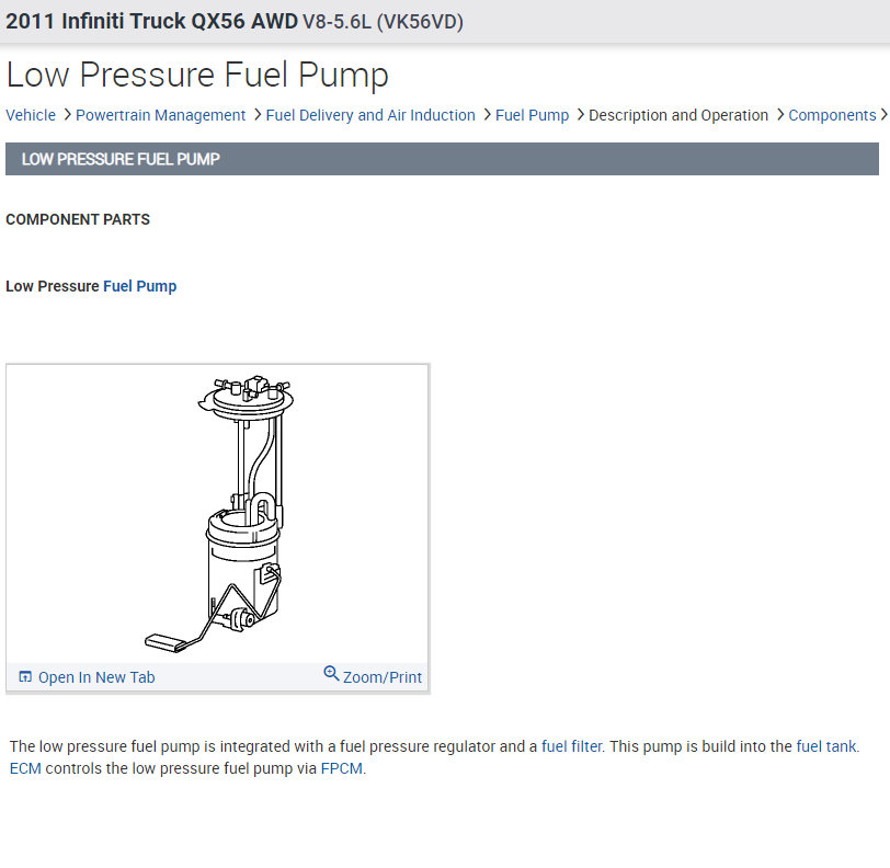

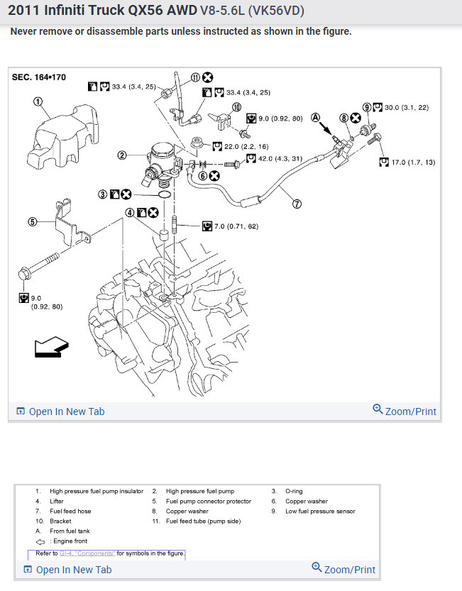

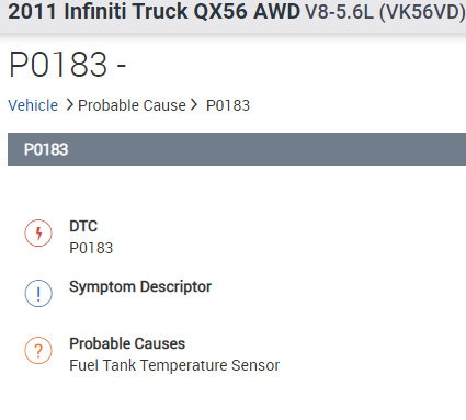

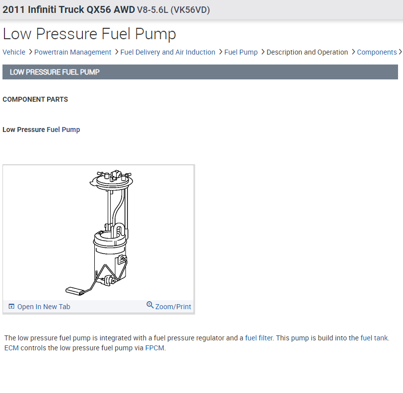

My truck has been stalling. Check engine light came on and checked code that came up code is p0183 fuel temperature sensor. Was told to replace the fuel sensor in the fuel tank but when I try to order the part given it says it won't fit my truck. just trying to find the right part to order.

I would suggest you call a Infiniti dealer, provide them with the VIN to get the correct part number. With the part number you should be able to order that part, and you will know it will fit.
Have you already called the dealer?
