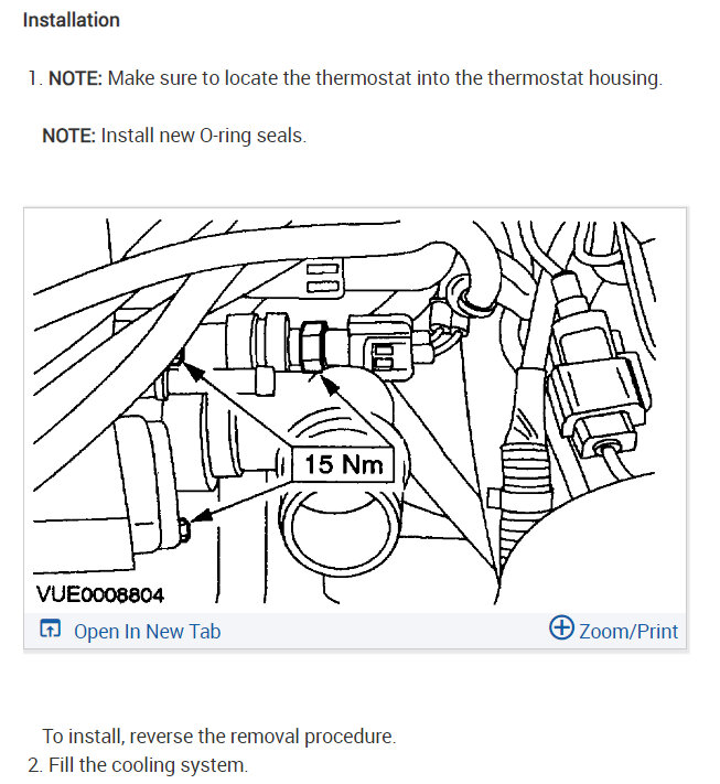

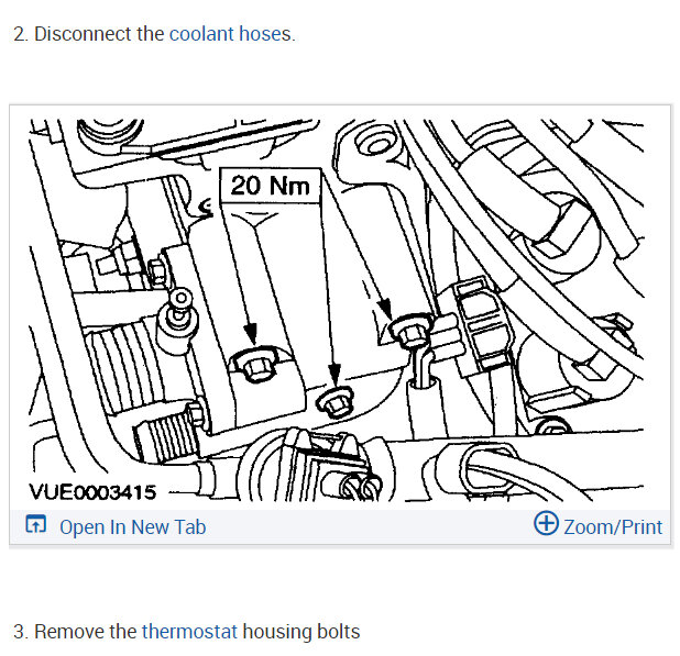

Here is a link the thermostat housing you need for $20.00 on Amazon:
https://amzn.to/48Uid9v

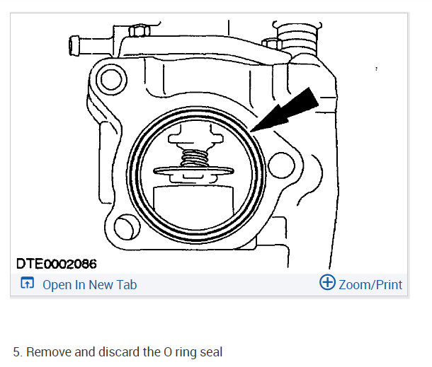

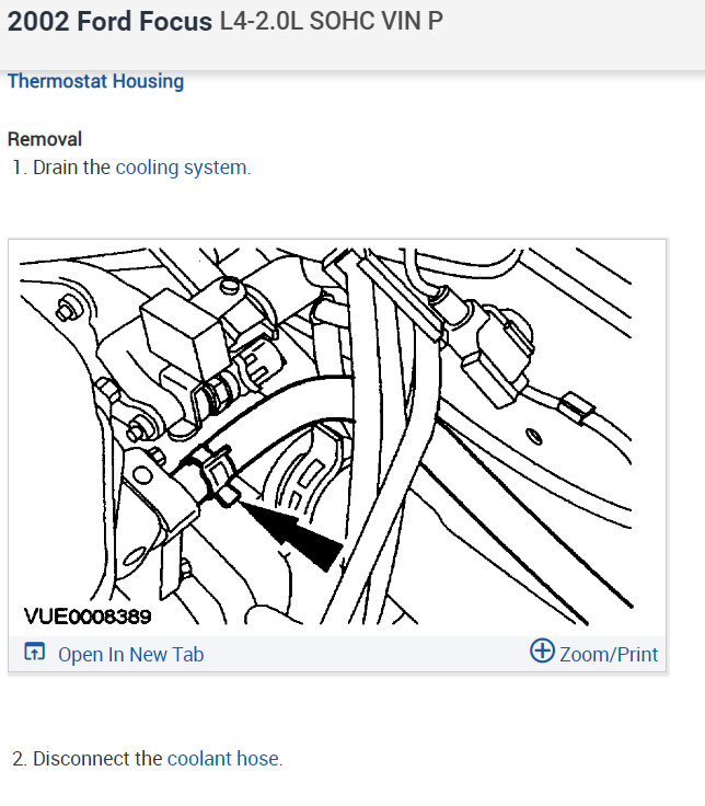

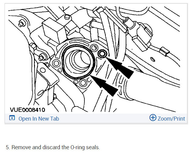

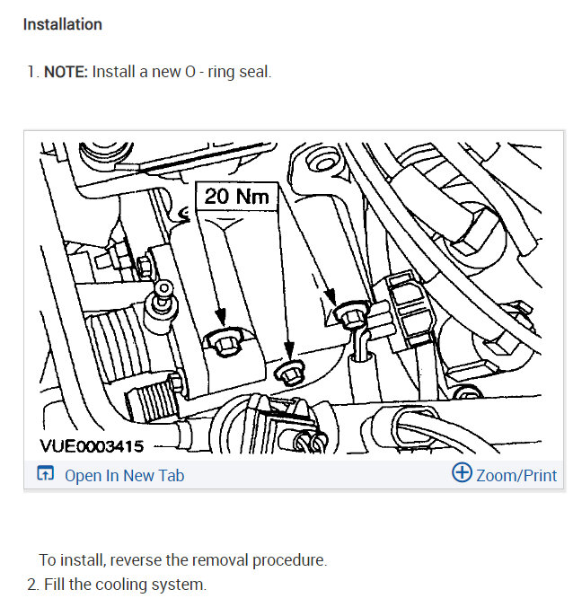

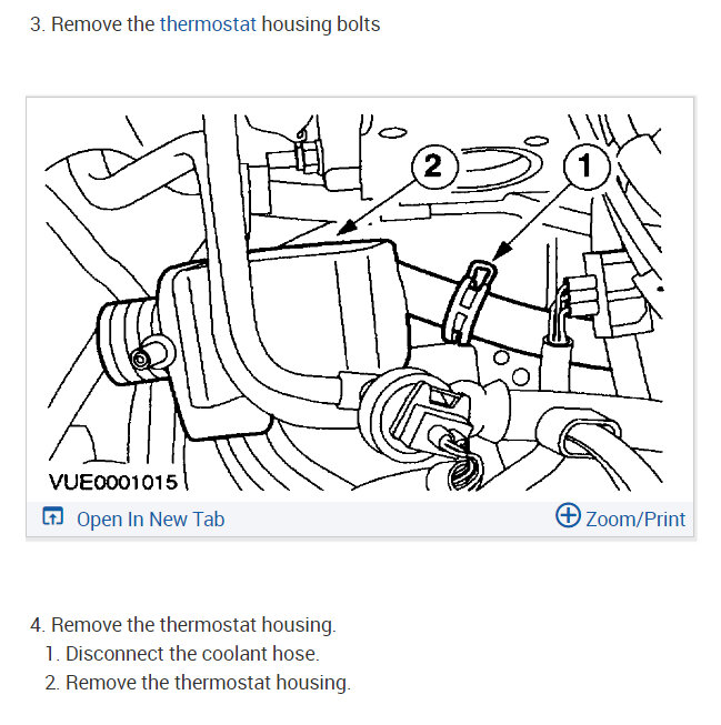

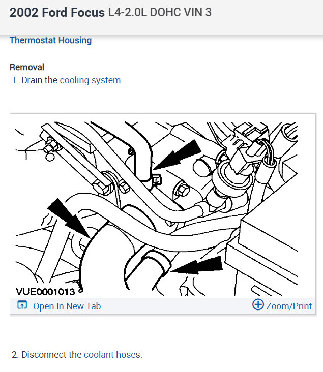

Here is a generic guide to help you step by step with instructions in the diagrams below to show you how on your car. Check out the images (below). Let us know if you need anything else.

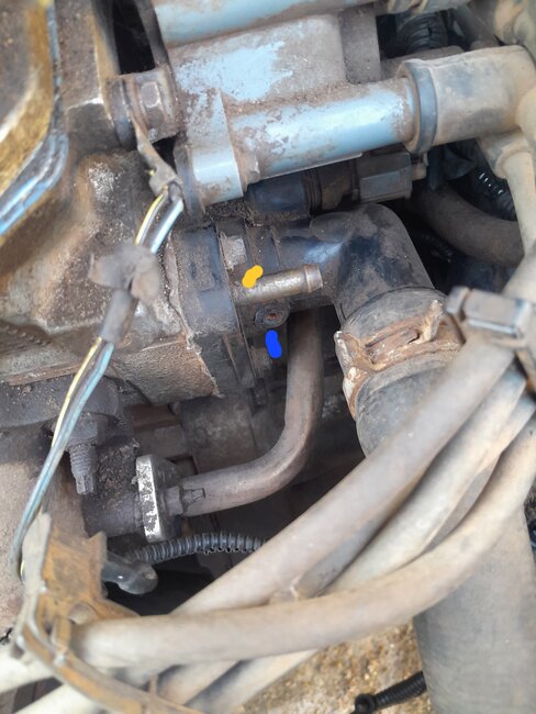

Good morning, sir,
This thermostat housing doesn't have the pipe which connects to the heater core. So, it is not a match. Can I get the one that has four (4) outlets. Thank you very much and God bless you real good.

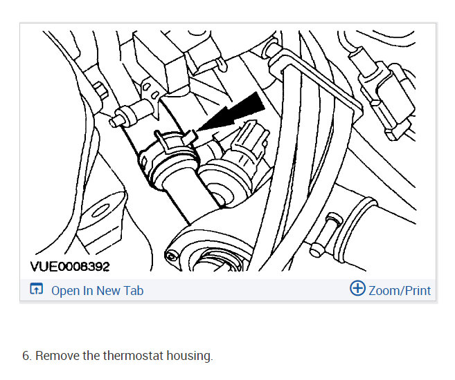

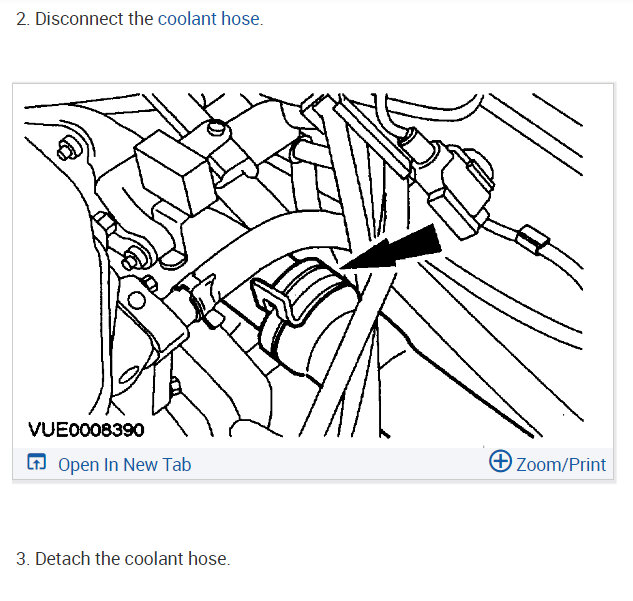

I see the problem; this is a signal overhead camshaft which the one above is for the dual overhead camshaft.
Here is how the job is done on your car:
https://amzn.to/489KiZf

The one for my vehicle is contained in those images. It is SOHC, but the link is different. If you can provide the part number, it might help in the search or send another link, please. I appreciate your efforts and concern. God continue to keep you and bless you.

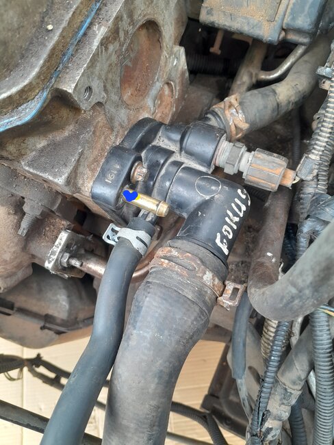

Good morning, sir, it has been a while. I have purchased the thermostat housing and the hoses. Thanks for all the support and guidance. Please, I also want to know. Can you indicate to me where the hose from the metal on the thermostat entered in the firewall? Couldn't locate it in the firewall. Just indicate it. Thanks very much for all you do and God bless you.
