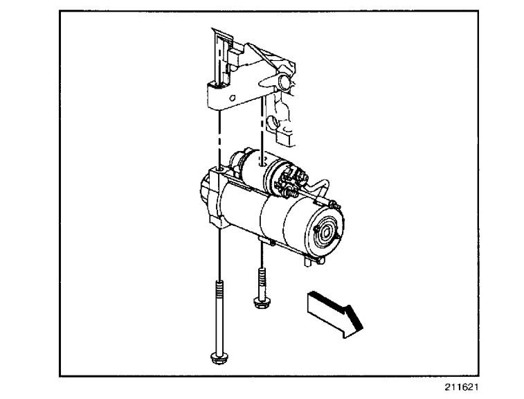

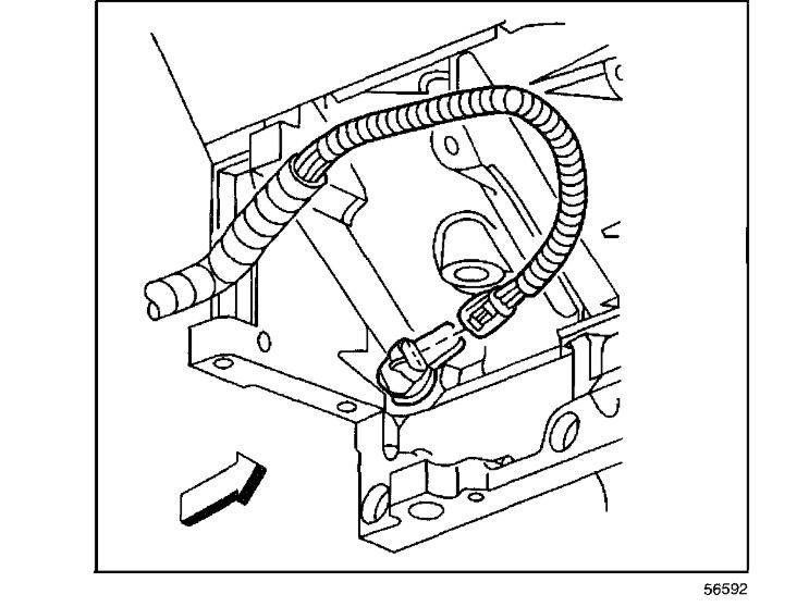

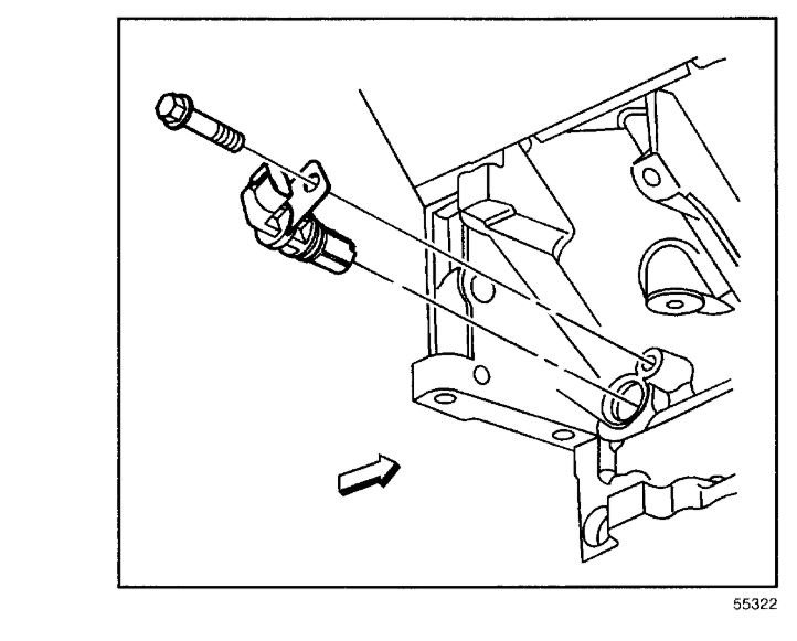

Have oil leaking from a part right above starter,some kind of sensor possibly.does anyone know the name of this part?
Jun 23, 2020 at 10:55 AM
Good afternoon,
Can you upload a picture of the leak?
The only sensor above the starter is the crankshaft position sensor.
https://www.2carpros.com/articles/how-a-crank-shaft-angle-sensor-works
That should not leak oil but it does go into the block.
REMOVAL PROCEDURE
IMPORTANT: Perform the CKP System Variation Learn Procedure when the crankshaft position sensor is removed or replaced.
CAUTION: Refer to Battery Disconnect Caution in Service Precautions.
1. Disconnect the negative battery cable.
2. Raise the vehicle. Refer to Lifting and Jacking the Vehicle.
3. Remove the starter.
4. Disconnect the crankshaft position (CKP) sensor electrical connector.
5. Clean the area around the CKP sensor before removal in order to avoid debris from entering the engine.
6. Remove the CKP sensor retaining bolt.
7. Remove the CKP sensor.
