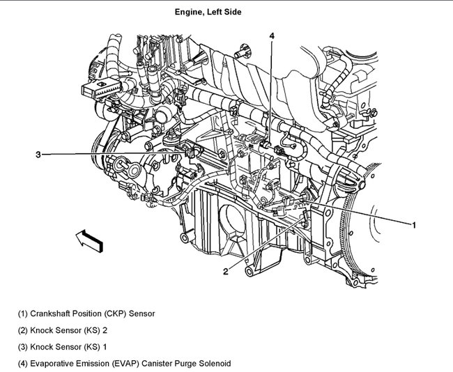

Exact location needed of knock sensors 1 and 2. the diagnostics gave code for both.

Good afternoon,
I attached a picture of the knock sensor locations. They are on the left side of the block.

Here is the image. Check out the diagrams (below). Please let us know if you need anything else to get the problem fixed.
Image (Click to enlarge)
